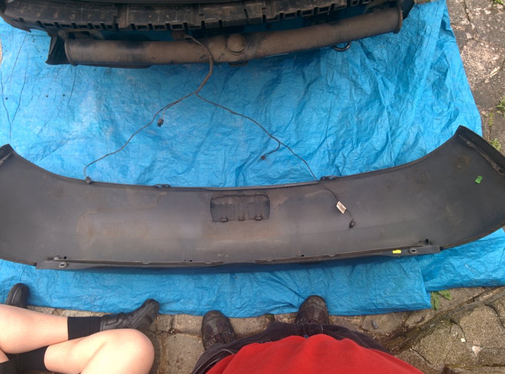

I've taken my rear bumper off a few times. Put some soft material on the floor directly under the bumper so that it does not get scratched. The sensor cables are long enough for the bumper just to be placed down onto the soft material.
You need a helper to remove it. One takes each side as you pull it away from the rear sides. Having a helper means each can support and ensure the bumper does not scratch the car body as it is removed and placed down.
