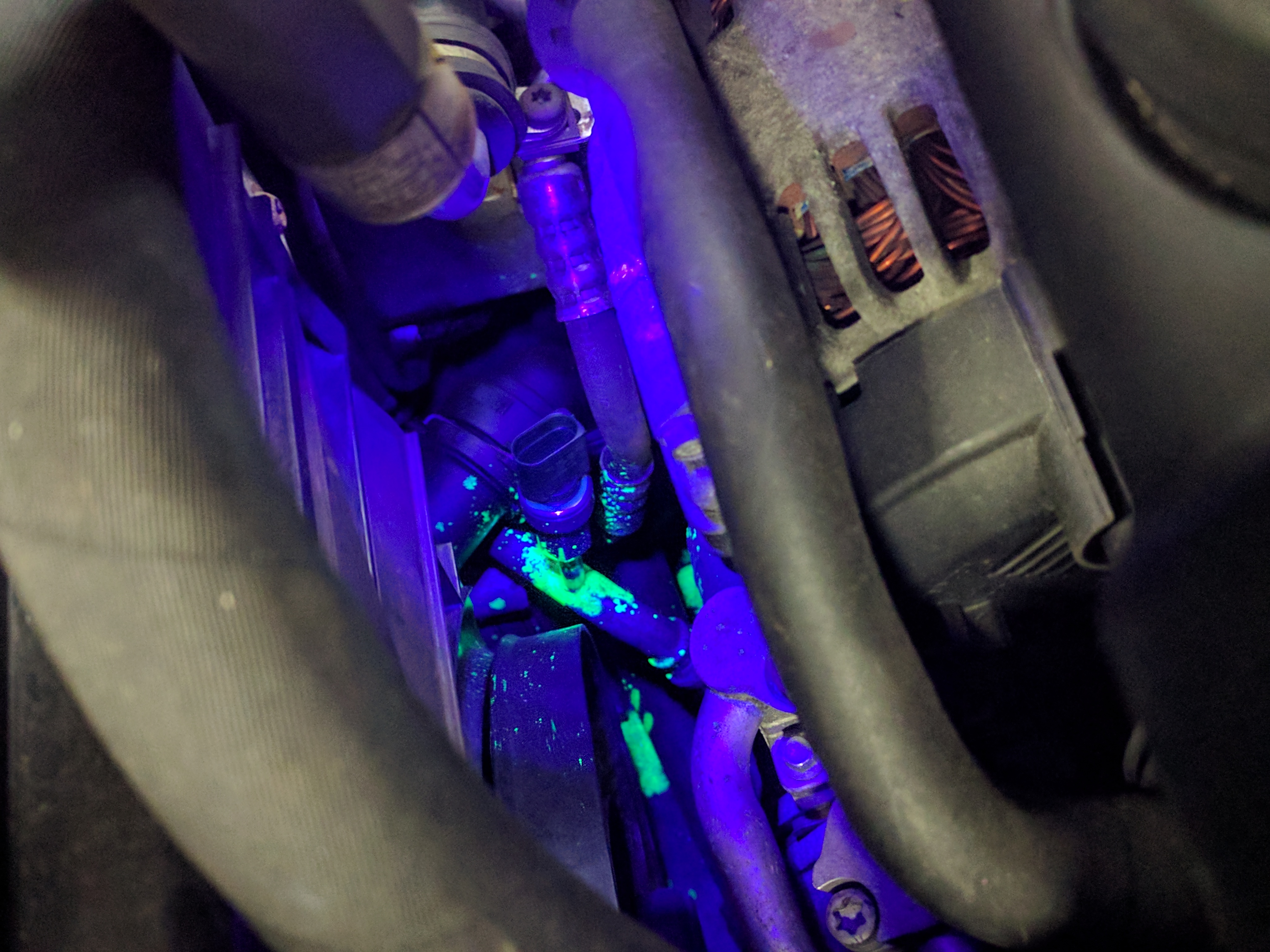

I took the car to another garage where they found on the pipe where the pressure sensor is (between the compressor and the condenser). Aparently that first garage screwed me over and either did a ****ty job refilling or they just lied.....
Anyhow, I had this garage confirm to me that the compressor is healthy and that there is no other leak other than this.
The original pipe from VW costs around 350 pounds and it is almost impossible to find on a scrappy (in Denmark at least). However, I found a new one on Ebay from Poland for 45 pounds which is on its way.
Finding a cheaper new one, knowing the compressor and the rest are fine and knowing they can change the pipe without taking the entire front-end off pushed me into deciding to fix the car.

I had the faulty pipe replaced and the system re-gassed and everyone was happy - AC was working.
It worked flawlessly for 2 and a half days till one evening when I start the car and I hear that hissing sound again in the cabin from the vents.... With the AC still working, I drive around, mind my business and every now and then the AC would stop blowing cold and the hissing sound gets louder and quieter randomly.
Around 350 km later, I go back to the shop and tell them about it. They hook the vcds up and see there is an intermittent lower limit exceeded error. Fine, they check with the UV light again and see no trace of leaks. They hook the AC machine up and do a pressure test - all good. They vacuum the system and figure out it was missing about 135g since it could only recover 390 out of 525g.
Finally they fill it up again and the hissing is gone but again, no trace of leaks and AC works perfectly..... They said I should return if it happens again... I sure hope they just filled it up to the wrong amount and there is no other leak... :(
