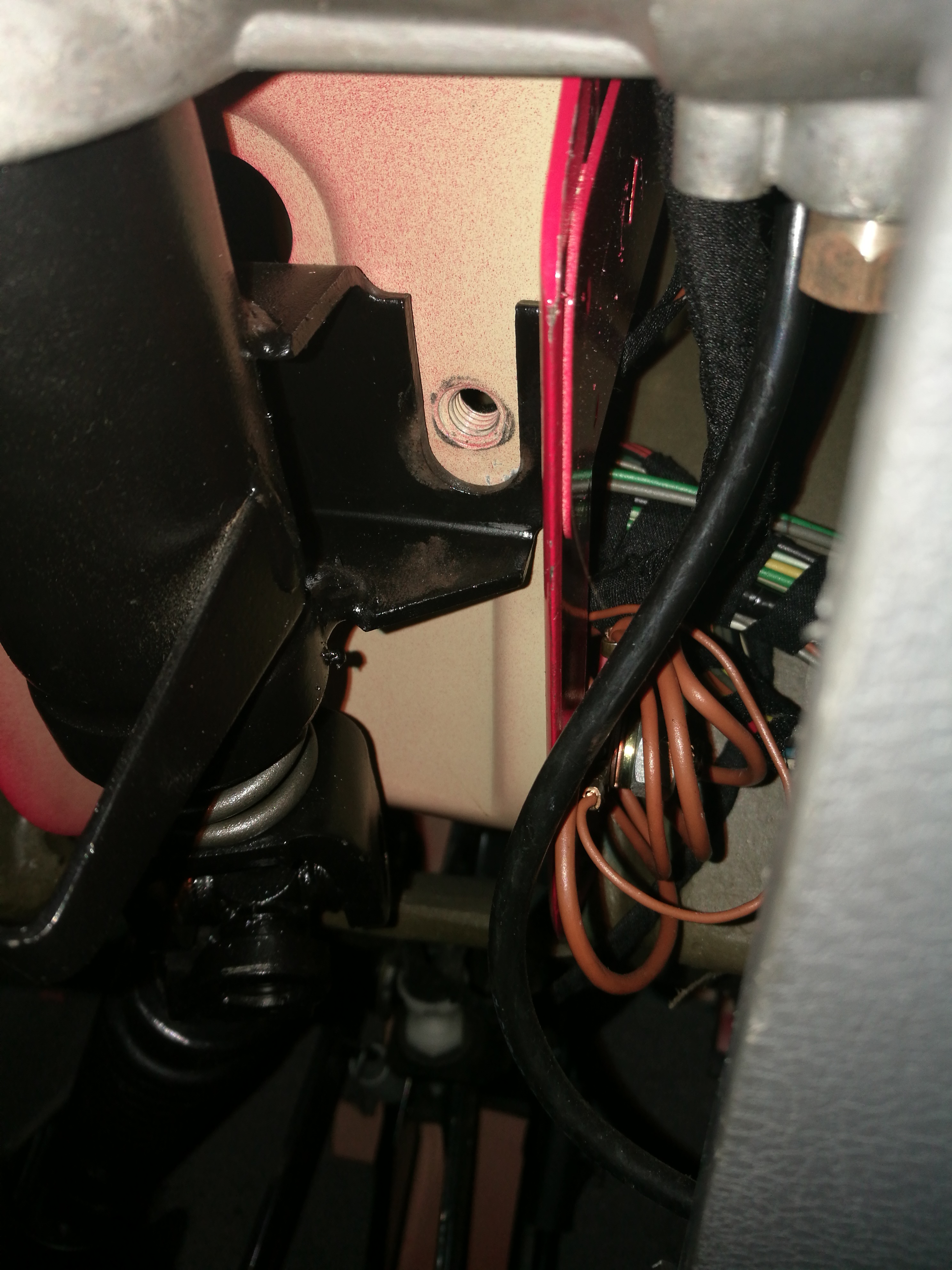

@Richie32 - Well, at that rate I suspect that it may well be a loose bolt on the upper steering column retaining bracket, which will be under the lower facia panel. You say you can see the column moving, but how? Vertically up and down, left and right, in and out normal to the wheel rim?
@KenONeill I think your spot on. I took the facia off and the column is loose around the two bolts before the join of the column (I can move the steering wheel up and down) . The bolts were pretty tight but after taking them off and looking at another picture on Google it looks like it's missing a couple of black spacers. So no matter how tight it is it's still loose enough to move up and down.... and fail on the MOT. I just need to find an alternative to use as the spacer I think.
It's called an adjusting washer. Very brittle when old. Part number 6U0419123.
See below the correct position for installation.
Thanks very much @RicardoM. After much searching a very helpful Skoda dealer sent me their last two. Fitted them last week, steering column now solid, and she's passed her MOT! :):)
