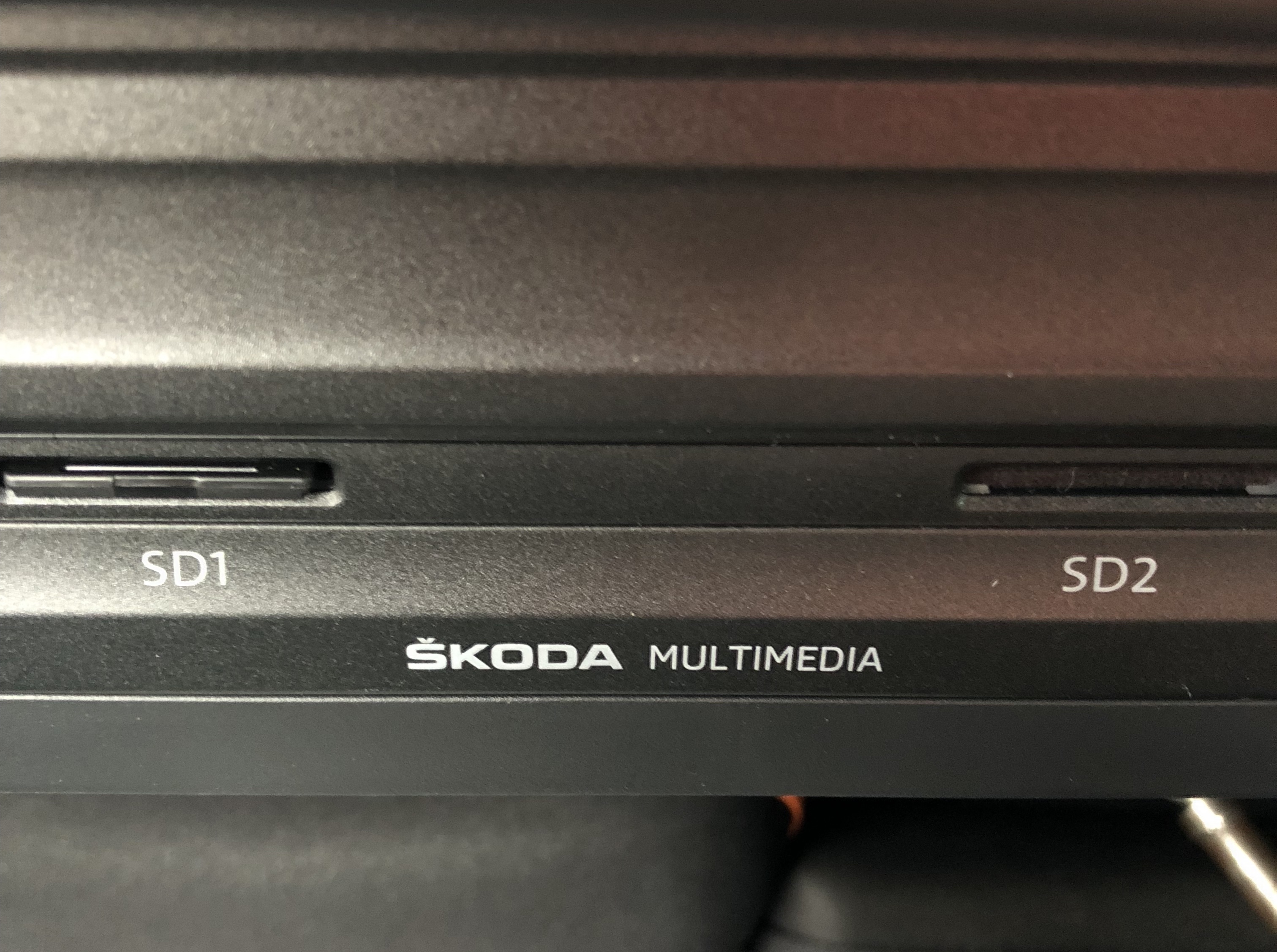

My Amundsen has 2 SD card slots in the glovebox plus a USB slot under the heater controls, are ALL those empty in your car?
The USB and Aux have nothing plugged in to them but SD2 has the Satnav card in it.  I've tried both removing the SD card safely, and not safely and it hasn't made any difference. The Satnav SD card was in it when I got the car new and I've never removed it since.  Wonder if it's worth trying swapping the SD cards to the other slots?

My Sat Nav SD Card is in Slot number 1 ( just been out to look ) I'd swop the cards around Gary

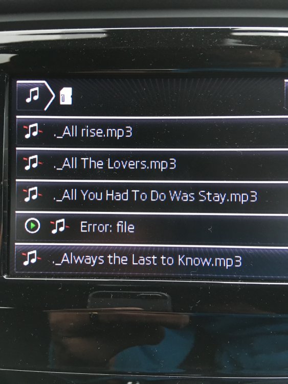

Here's a snap of the error files, which aren't on the SD card (either of them) - the ones with an underscore before them.

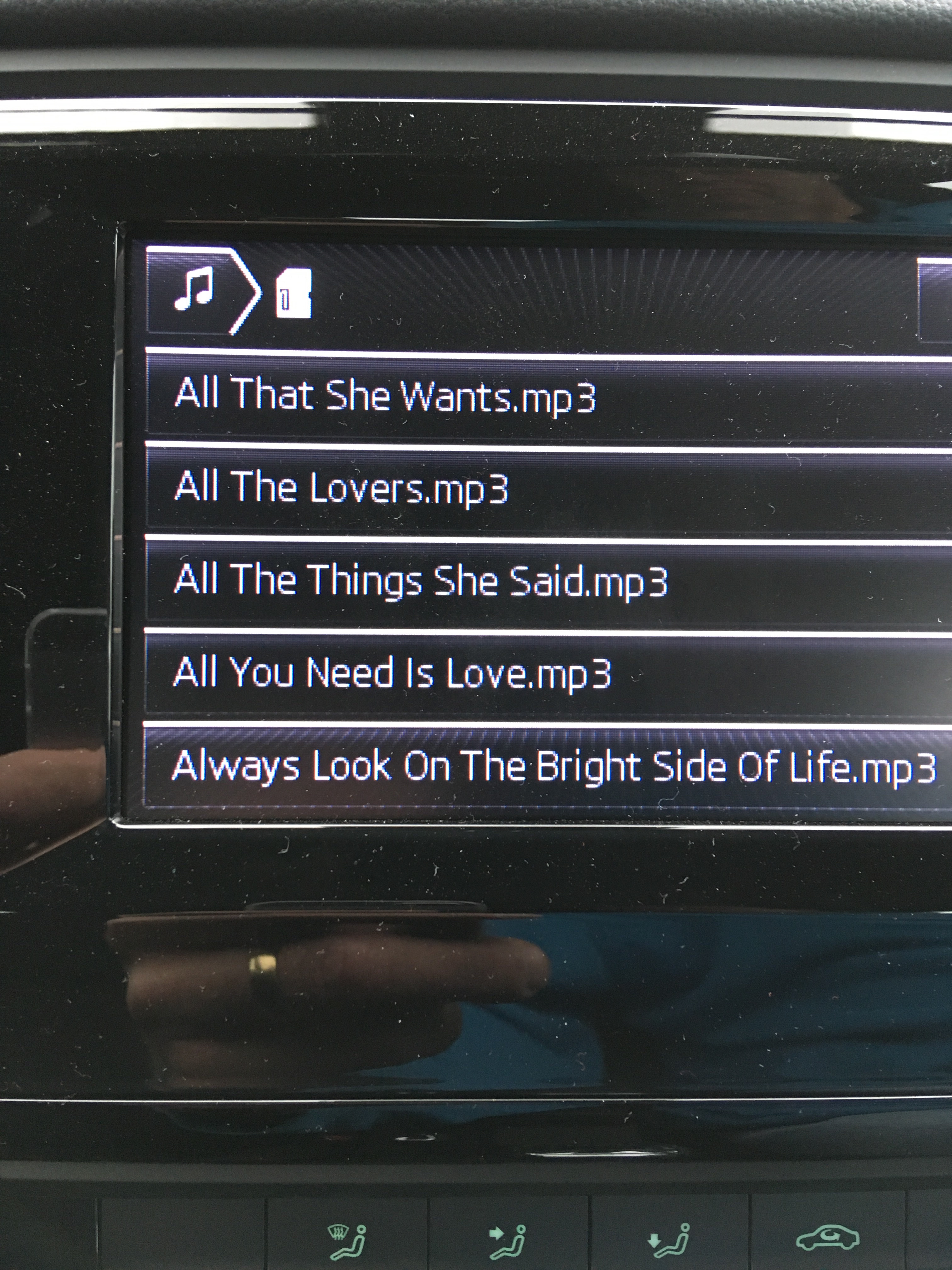

The other photo shows the tracks which are on the SD card and play.  Note that 'All you had to do was stay' doesn't show as being on the SD Card, yet it is.
Do you use a Mac?
I ask because those look like the files that OS X tends to leave behind (and not show when you look in Finder).
If so then that is the problem, and this might help https://lifehacker.com/377011/delete-mac-system-files-with-dotclean

Just now, SWBoy said:
Do you use a Mac?
Aha, yes!!
I use a Macbook Pro.  I don't have a PC.
Looks like you're onto something SWBoy :)
Gaz
