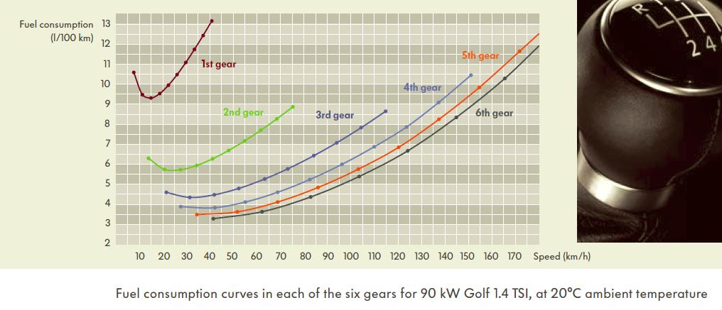

Attached is a graph from VW for the 90kw 1.4tsi for steady state consumption which I find is remarkably similar to my own in the Octavia. It gives a rough idea of the potential for low consumption at lower speeds.
