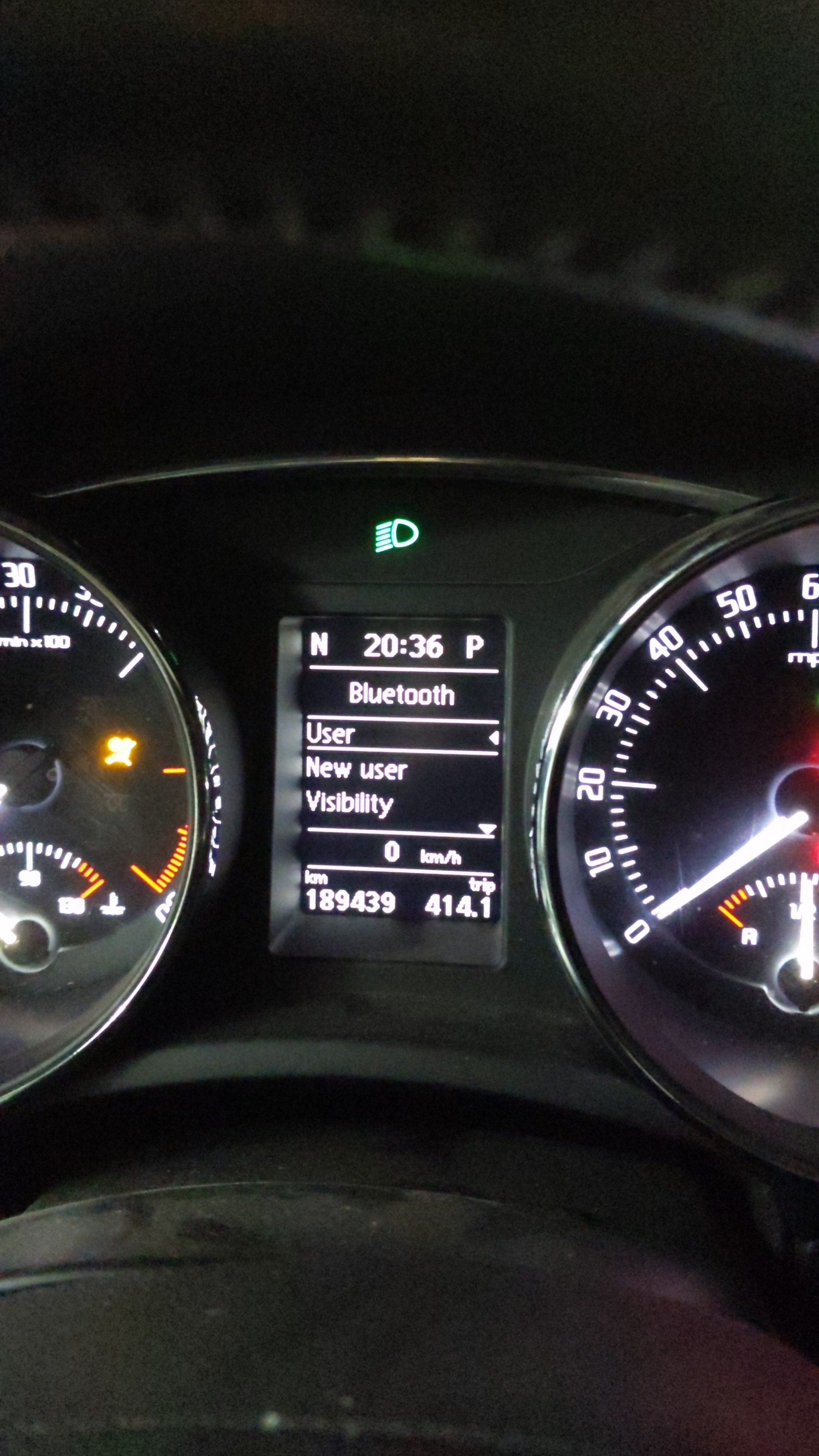

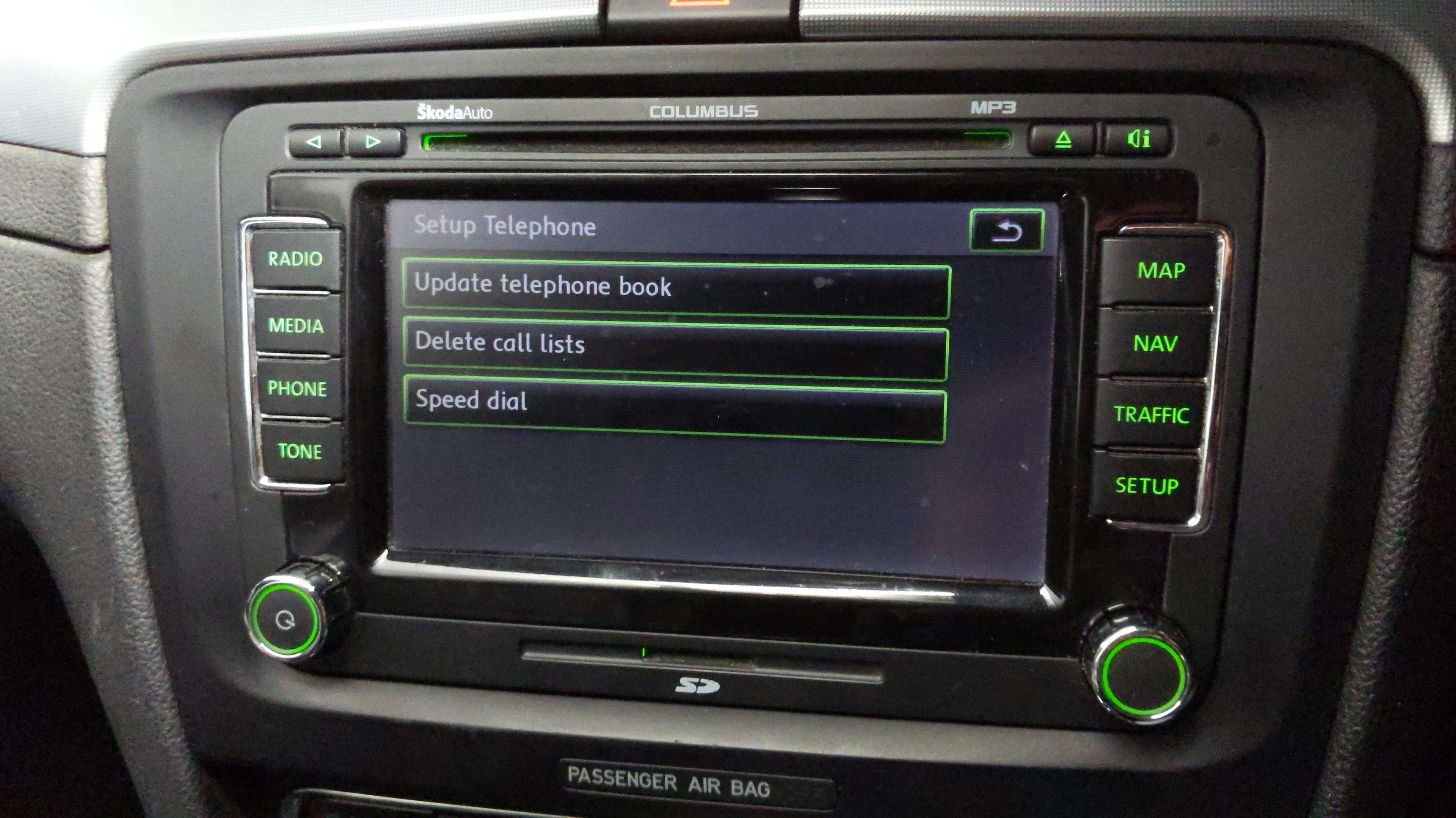

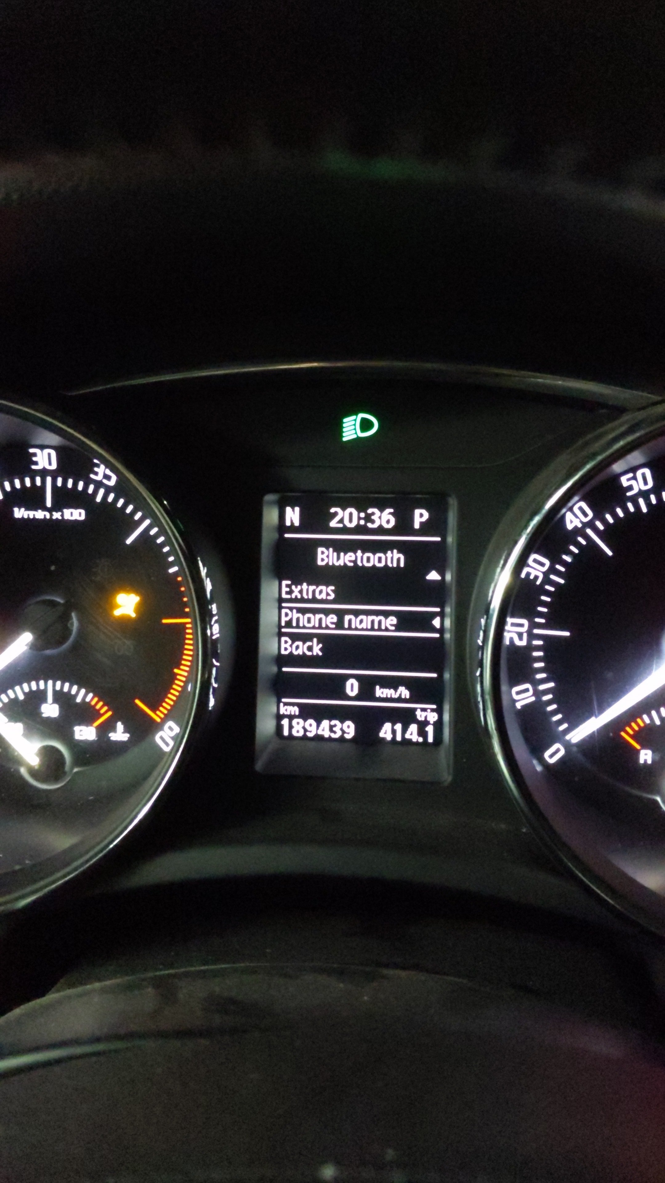

Can't seem to find that option
Perhaps I should have specifically said the Settings menu inside the Bluetooth menu. It's in there somewhere. You can access the setting via the setup menu on the Columbus too.
Pics attached of what I see
Perhaps I'm on an older hardware/software version?
Some bluetooth modules only support rSAP (premium mode) so will always 'steal' the sim.

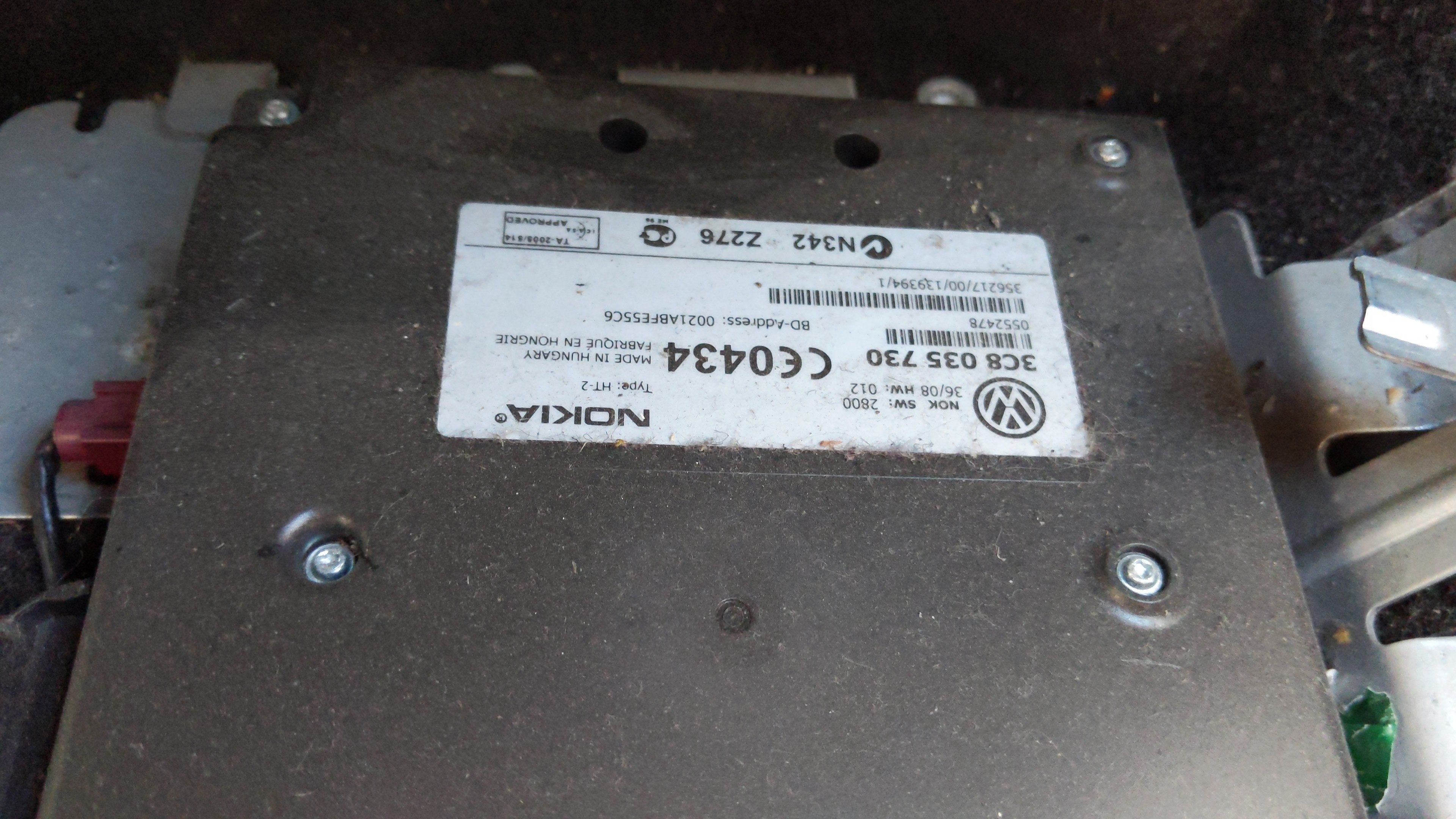

If you can, check the part number of the Bluetooth module. That'll confirm if it supports hfp or not.
At a guess, it'll be under one of the front seats.
Slide back the driver's seat fully and the Bluetooth module will be on the floor covered with a black plastic cover. Slide the cover forwards to get at the module. Post a pic of the label here when you're done.
Yup, that's an premium/rSAP only module which explains the missing menu :)

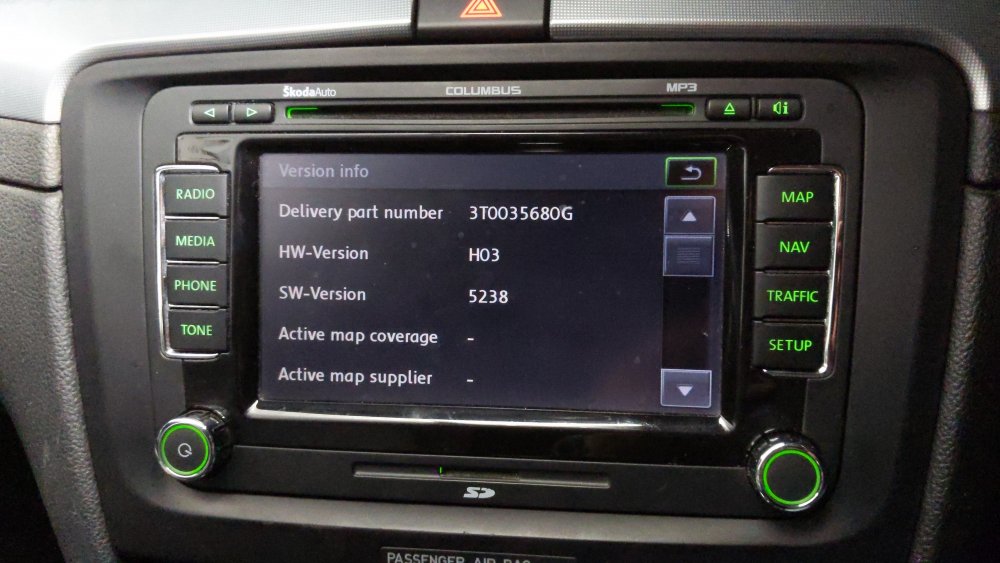

hi...i am owner of a 2009 superb.i the last update i have installed it was 2015.can you help me find the latest firmware version?and maps also sw 5238 firmware and v.13 east europe maps
@parkouropaido19 Google is your best option to be perfectly honest, especially for the maps. Anybody linking to downloads of maps on here is likely to be edited for copyright infringement etc. You can buy copies of the maps on eBay, but you're basically paying someone to download a file and burn it to a DVD. The actual cost to them is probably €0.10. But it is an option. You can also buy the maps from a Skoda dealership, but I'd imagine you will pay circa €250 for them. So figure out the disk number of the version you want (usually do-able through Google as well) and go from there. In terms of the firmware, you'll unlikely to see any benefits over the version you installed in 2015. But if you do want to try a new firmware (and the inherent risks associated with the process) then your best option is probably vwnavi.com. The site seems to be down for an upgrade at the moment, but generally that's where I'd look for latest firmwares and advice on what benefits you may get from upgrading.
