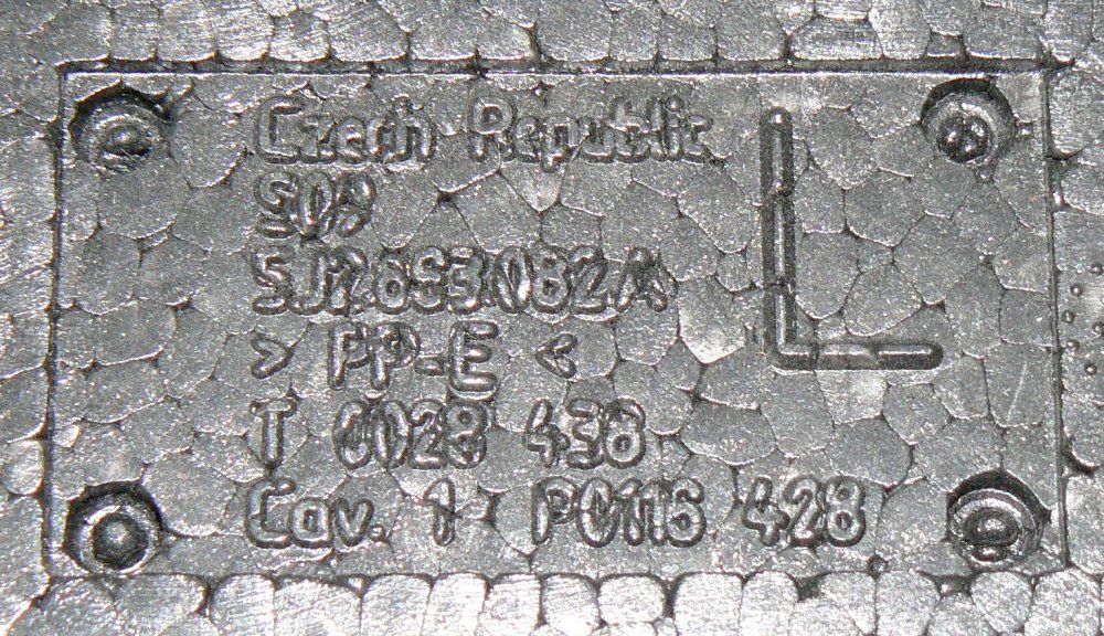

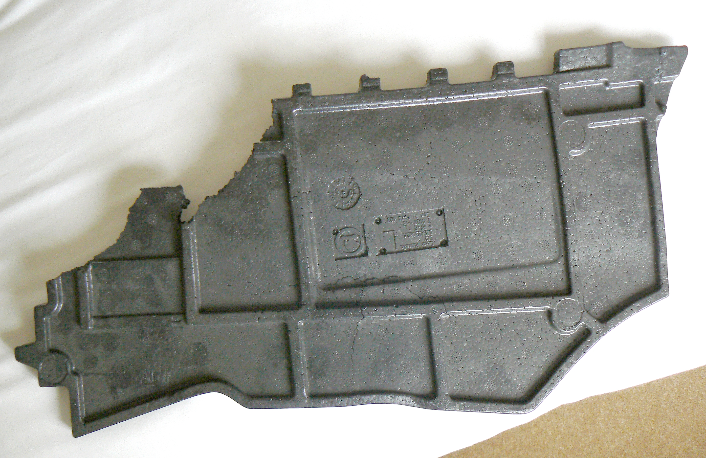

The pollen filter, as mentioned by LGM, is usually covered by a sound insulation cover too. Pull that out gently, try not to bend it much as they start to droop then. Make sure you put the new filter the correct way round, there is a flow indicator on new filters so it flows properly. When you put it in, it can be a bit fiddly to re-fit the sliding clips but be careful and it does work. The whole filter needs pushing in enough, then the coverlet goes a tiny bit further on, slide the clips keeping pressure on them as if to push harder on the filter so they slide OVER the retaining groove things. If they fall back off, you didn't do it quite right. They do go, can be fiddly and you'll most likely be laying on your back, with the set slide back as much as possible, causing a slipped disc, and interesting use of the English vocabulary!
:D
thanks ...i will follow that with close attention..if it can be done wrong...i have done it..but fortunately rectified
i will take a note of any positioning and mark a diagram... and rehearse in the garage some appropriate phrases linked to auto part fitting...worst so far were the vw door lock mechanism springs i did on the 1.6 mk4..i gave up on the boot lock when is finally seized.
thanks again...all this info is well kept for future
mrgf

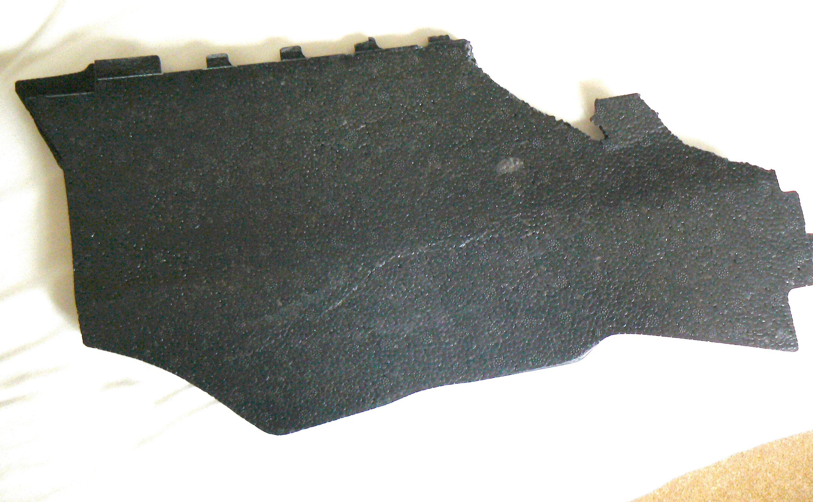

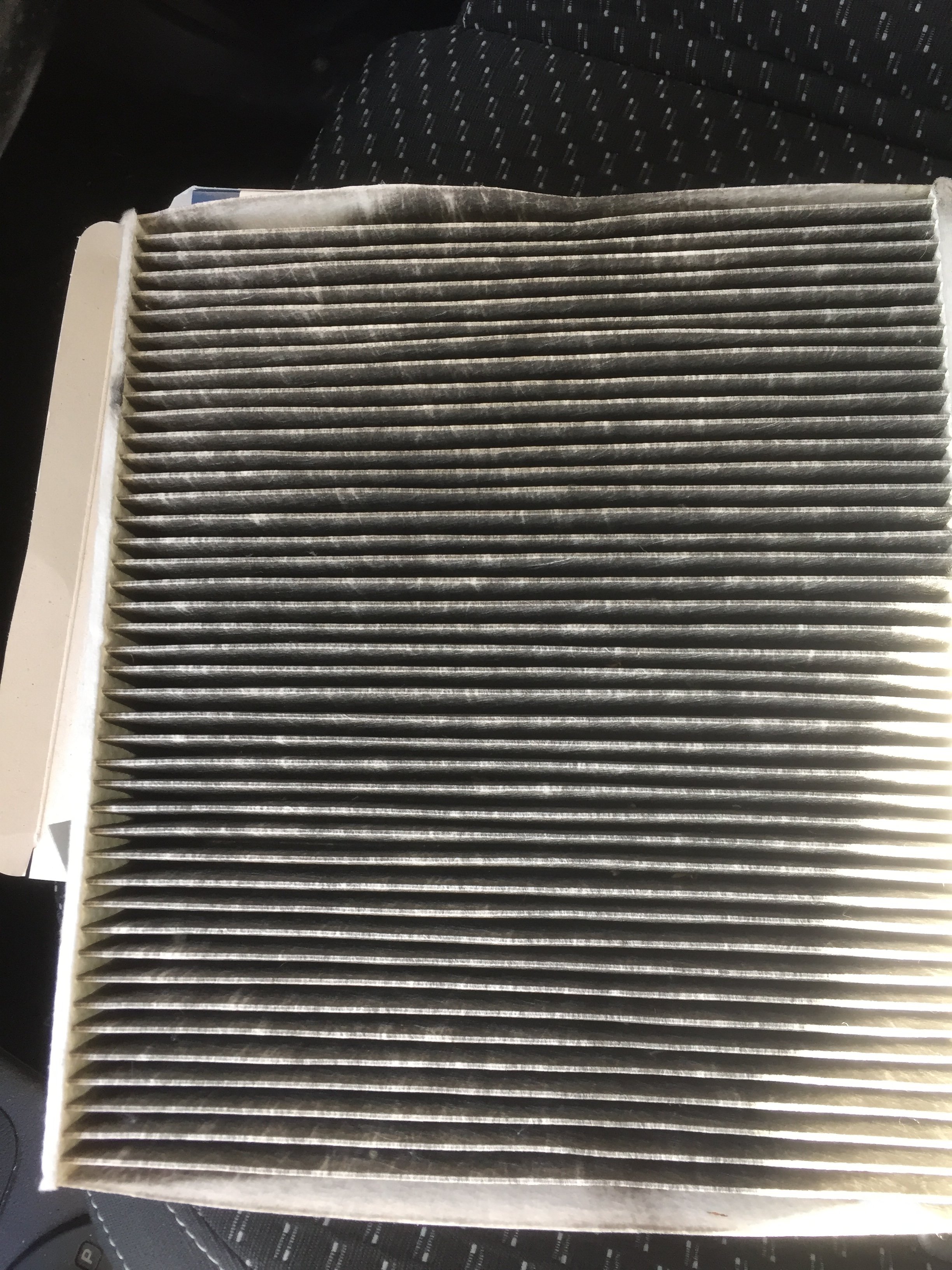

hope this helps...as you can see my soundproofing was wrecked when the person changing the cabin filter didnt bother to remove the item..so at least i still have it...its cracked a bit and i might consider replacing it as well...
the little sliders come and go quite easily but as i dont have the replacement filter..i wont do anything yet
it did strike me it could be already replaced...eg the hamfisted breakage of the soundproofing
in any event good luck with the replacement..and if you are successful..there is someone you could tell where it can be purchased...;)

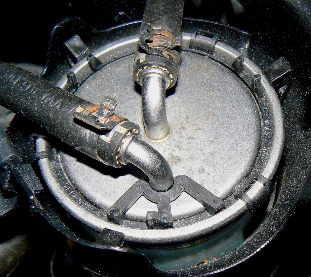

i checked out the fuel filter..and it looks an easy job...not like the u-tube ones for earlier fabia's
the pipes i will take care with removing, especially the clips, and refitting regarding leak checking
i see three spacer items around the rim and that locating item which holds the thing from turning in the holder
after taking off the pipes...what do i do about the three rim clips, and the locating bracket at the pipe
do they all come off as well
havent got the new filter so i dont know if they come with it as fitting items, and hose clips?

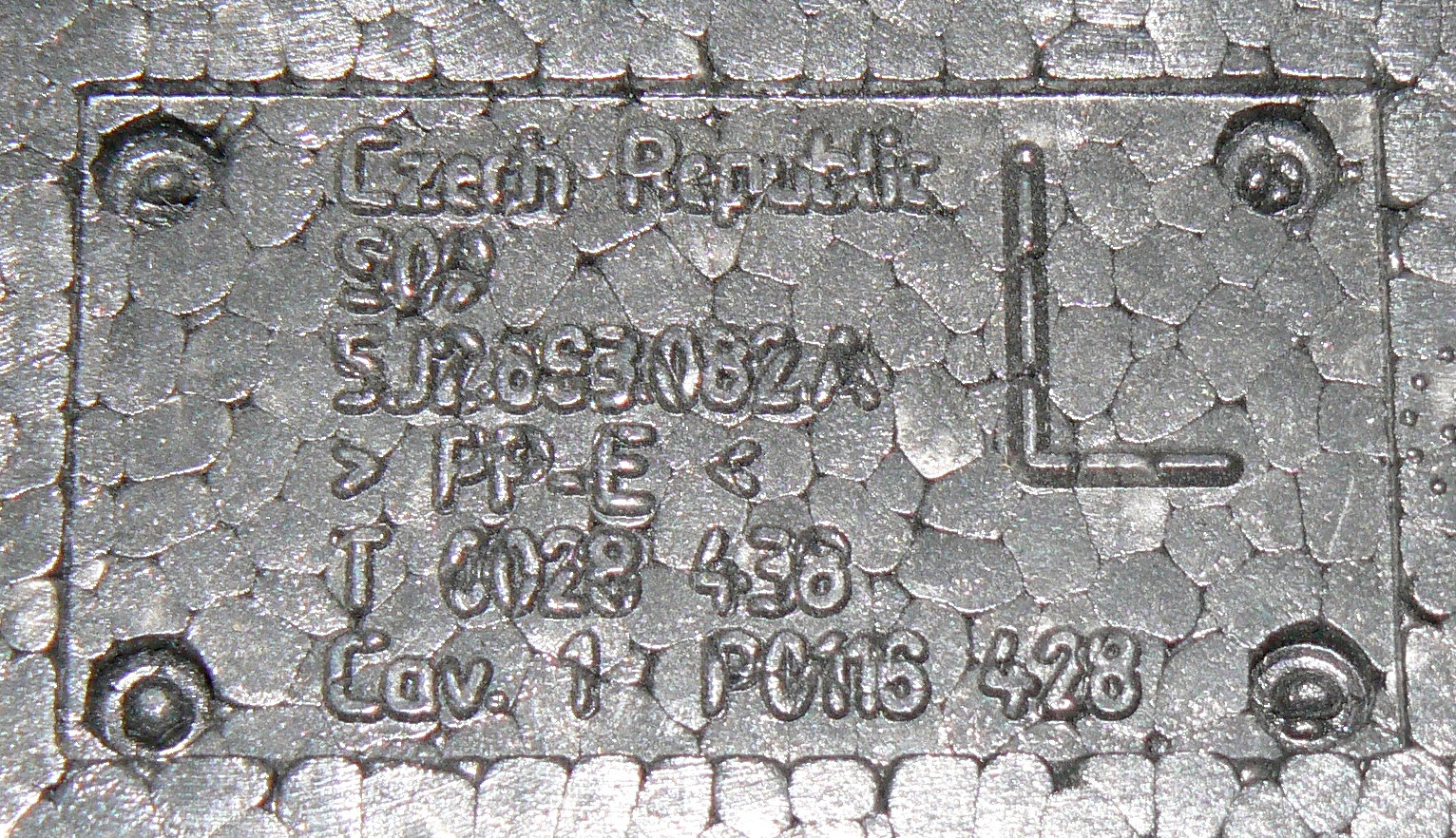

WOW! Thats a lightweight peice of insulation... The one I had was really think, heavy duty stuff that was quite hard to tear, cut etc. " They" managed to bend it so it drooped so I sowed a bit of velcro to it, with a sticky velcro pad stuff on the plastic air filter retainer so as to suspend it better as you tended to keep kicking it but I discovered the whole;e thing missing on changing the air filter one day, way, way after a factory service so had no argument to speak of, in asking them to replace it! The velcro I sowed on was tricky as the insulation was soon tough as to be hard to pass the needle through! Kind of heavy duty carpet type matting as opposed to lightweight expanded polystyrene.
dohh..i think i got the friday night one...:D
its soooo breakable
your idea is good..i will do as you do and stick some carpet tile to mine to strengthen it and make up the bit that got mangled at the filter end..

The plastic lugs or rim clips just pop back, the other plastic ring kinda comes off with the filter. I think you'll get a new one with some brands of filter. It is basically a guide to locate the filter in the correct position for ease of fitment. The filter then just lifts out, if you have disconnected the pipes.
Just as an aside, Haynes have released a manual for the Fabia 2, which is really helpful. the book number is 6033 and covers from may 2007 to 2014 (07 to 64 reg) Petrol and diesel.  ISBN number 978 1 78521 033 4. There are some models it doesn't cater for but they are usually unusual versions.
