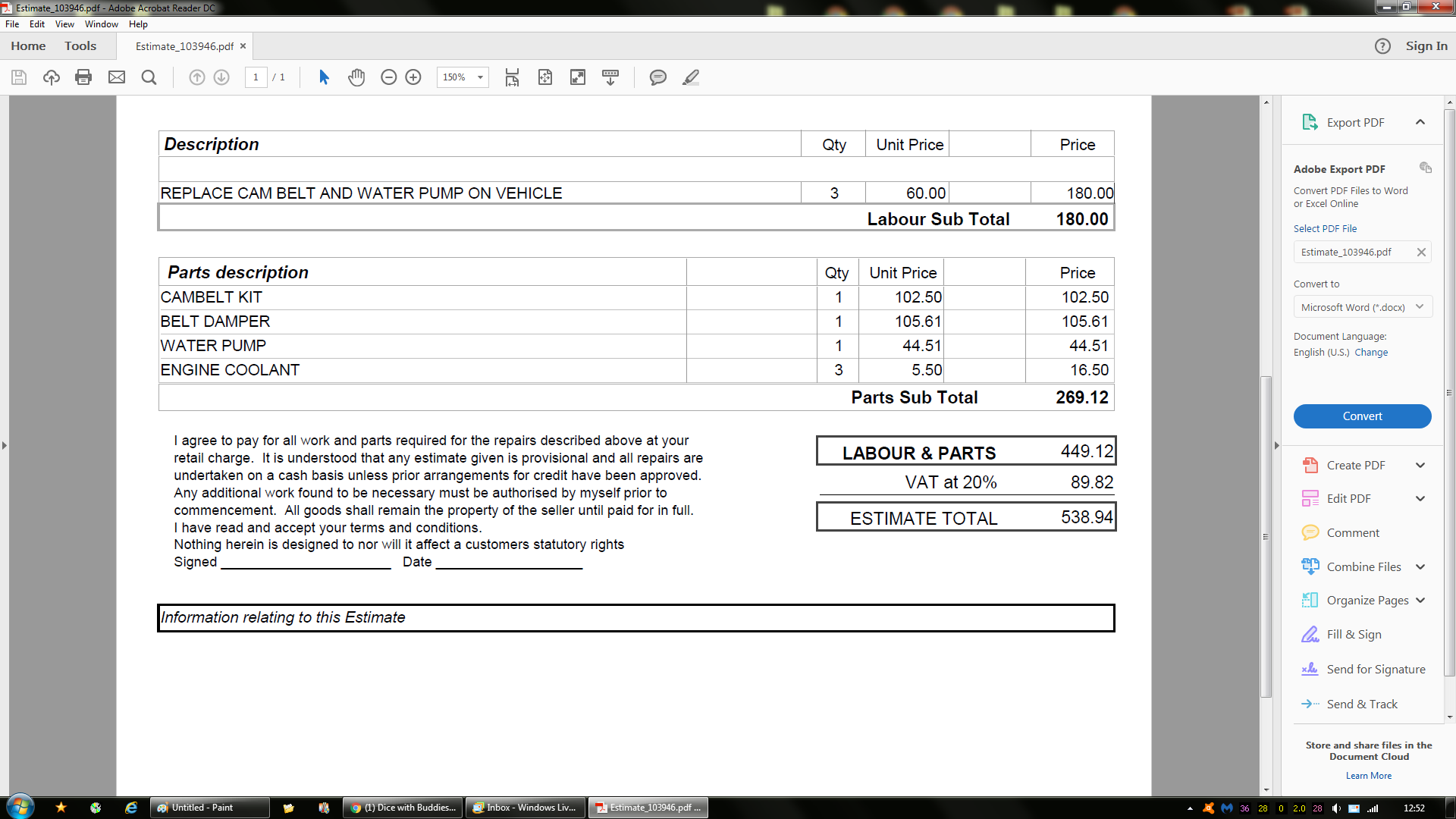

If this belt damper is not needed, then this quote for comparisons sake would be approx £125 less than the total in the attached picture (£538.94), so very close to £412, saving me £73 over Skoda.

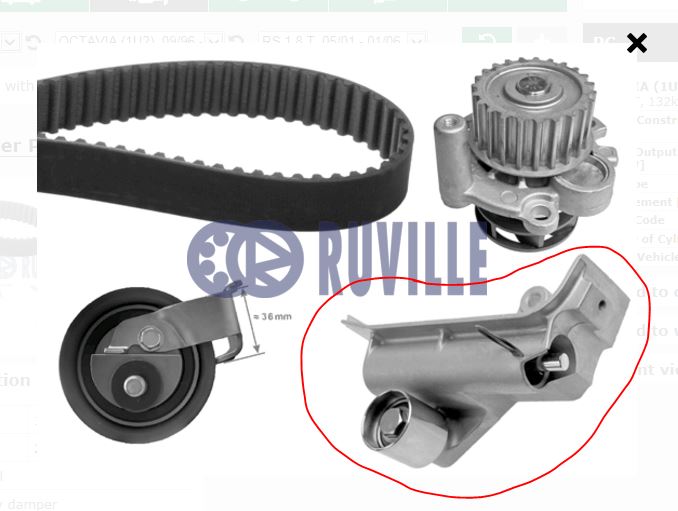

It will be this bit - a decent timing kit will have it in the box anyway

And ref the quotation, who loses 3l of coolant changing a water pump!?

Yep, the hydraulic damper unit, allows the tensioner to move as the belt tension changes. Also has the idler pulley on it, so should really be changed at the same time as everything else.

I see from the quotation they are charging 3 hours labour as well, official time is only 2.2 hours (I did my own - 1st time - and it took nearly 5! Although that was allowing for tea breaks, and quite a while wrestling with the poxy engine mount and a partially rounded damper bolt too)

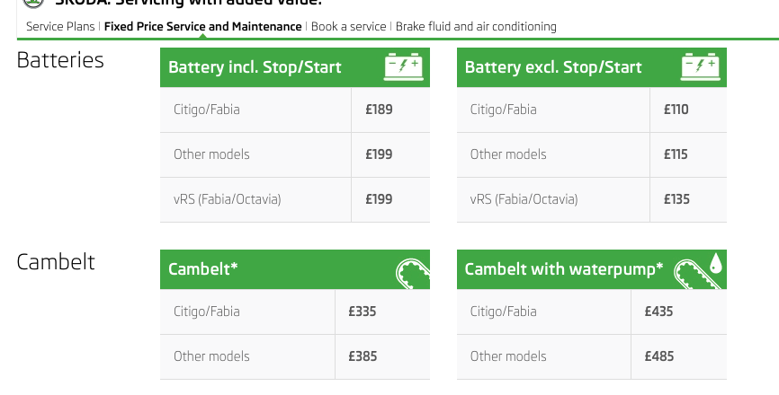

Skoda charge an extra £100 to supply and fit a Water Pump with a cambelt change.
Bit of a rip off, cost of water pump £45 and £55 to fit it, every thing is taken apart for the cam belt and then charge you just to remove and fit a new one.

You can get INA kits with a water pump in them too, part number is 530006730. Also have a look for the Ruville kit (same components as INA) - part number 55442711 - same kit I have fitted on mine, and was cheaper than the INA kit by a few quid.
