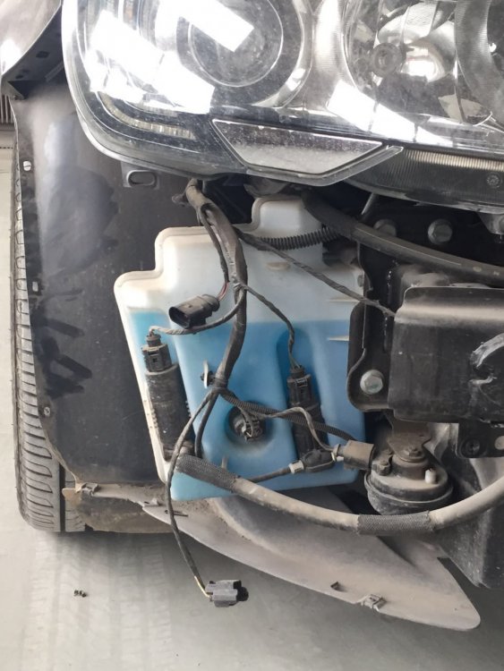

The headlight nozzles are powered by a different pump. Here is a photo I took before, the left bigger pump powers the headlight nozzles and the right smaller pump powers windshield nozzles. In between is the fluid sensor. If you still have enough fluid then there could be something wrong with the pump.
You have to remove the front bumper to get to the fluid tank and pumps.

Thanks for the picture! I will print it out and have it with me when I fix it.
