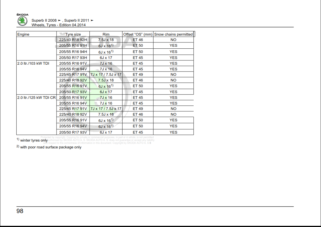

205/55 x 16
Look at the ERWIN screen shot. with 205/55-16 either LI 91 or 94 and speed rating H or V.
If you use an H-rated tyre change the max. speed in MFD.
There is another thread with this screen shot.
Edited by 26DIPP
To be clear, that screenshot applies for vehicles from MY2014 on, and for non-Greenline models. For the Greenline, it's 91H and nothing else.
Interestingly, up to MY 2013 only 94V was approved for use with summer tyres on 205/55/R16 size. All other LIs and speed ratings were winter use only for that size. 91 wasn't even an option for LI.
