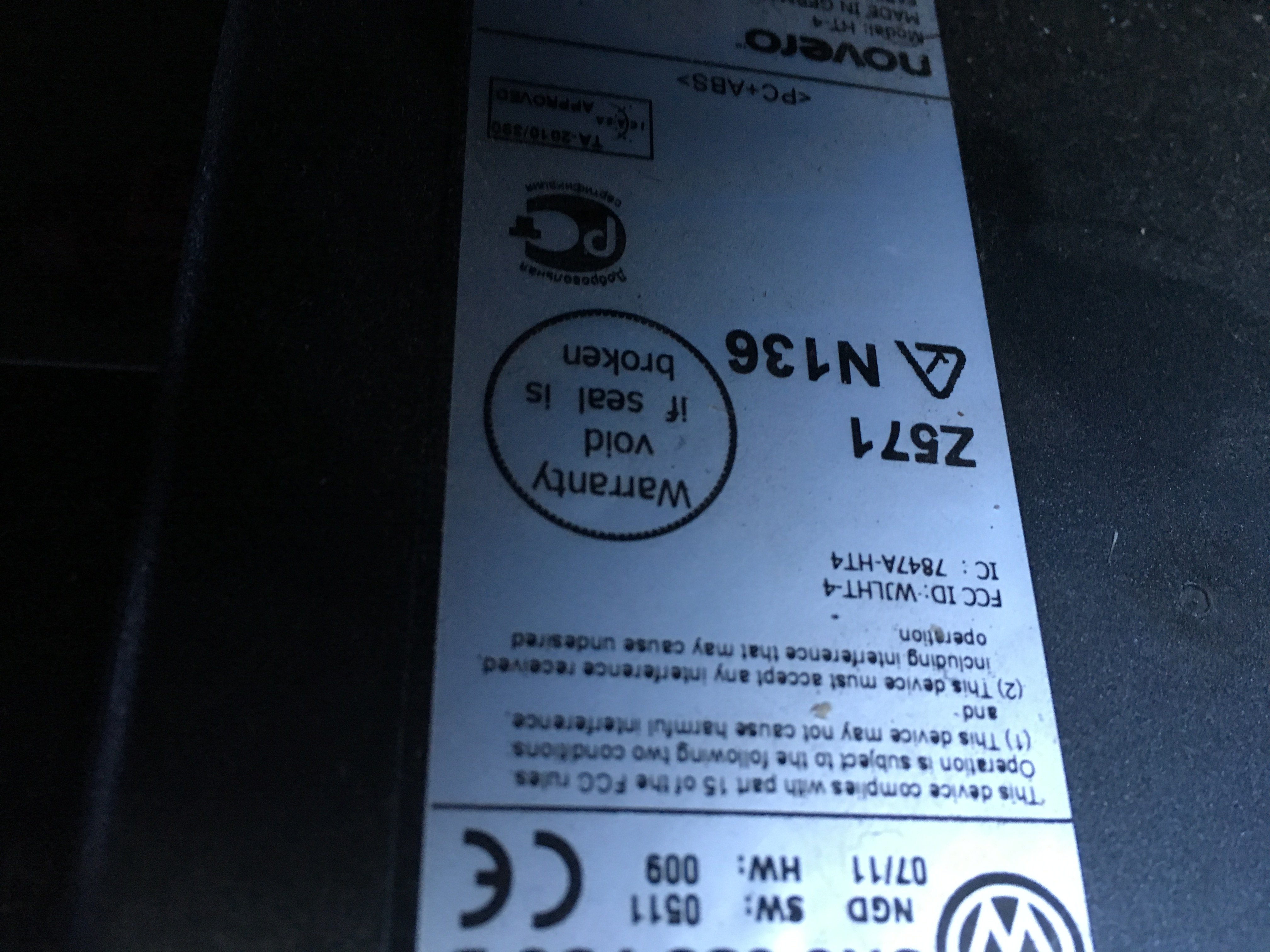

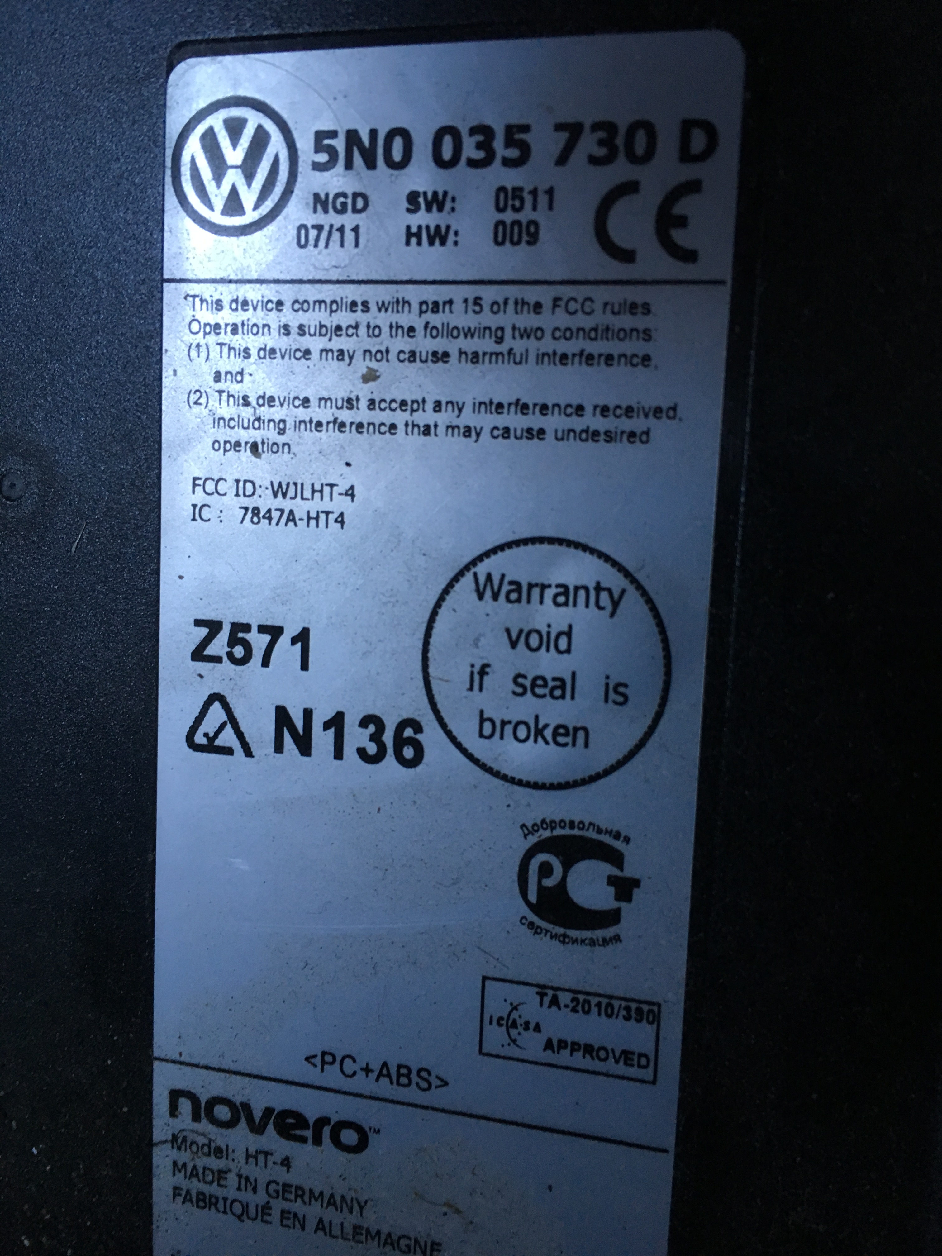

I've had a look at it and it is a Novero unit. It just has a VW logo on it and what looks like the date of 07/11

5N0 035 730 D here...
www.ebay.co.uk/itm/263056019191
Edit, You'll get all the loom etc. but you just need to change the actual box at a guess.
Edited by Rustynuts
