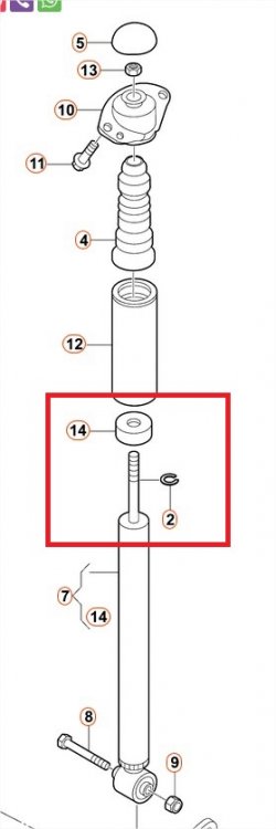

I need to change rear shocks on Fabia mk1, i am curious what are these two parts , item 14 and item 2. Are these parts vital?
I don't see those parts on this clip,
Edited by djordjebg
Item 2 is a snap ring which sits against the top mount hole. It will already be fitted to the new damper rod. Item 14 is the top cap of the damper tube :)
Edited by TMB
Do i need that cap?
I am going for KYB Excel G
1 minute ago, djordjebg said:
Do i need that cap?
No, the new shock will come with one fitted.
Both parts are already on the new shocks.
