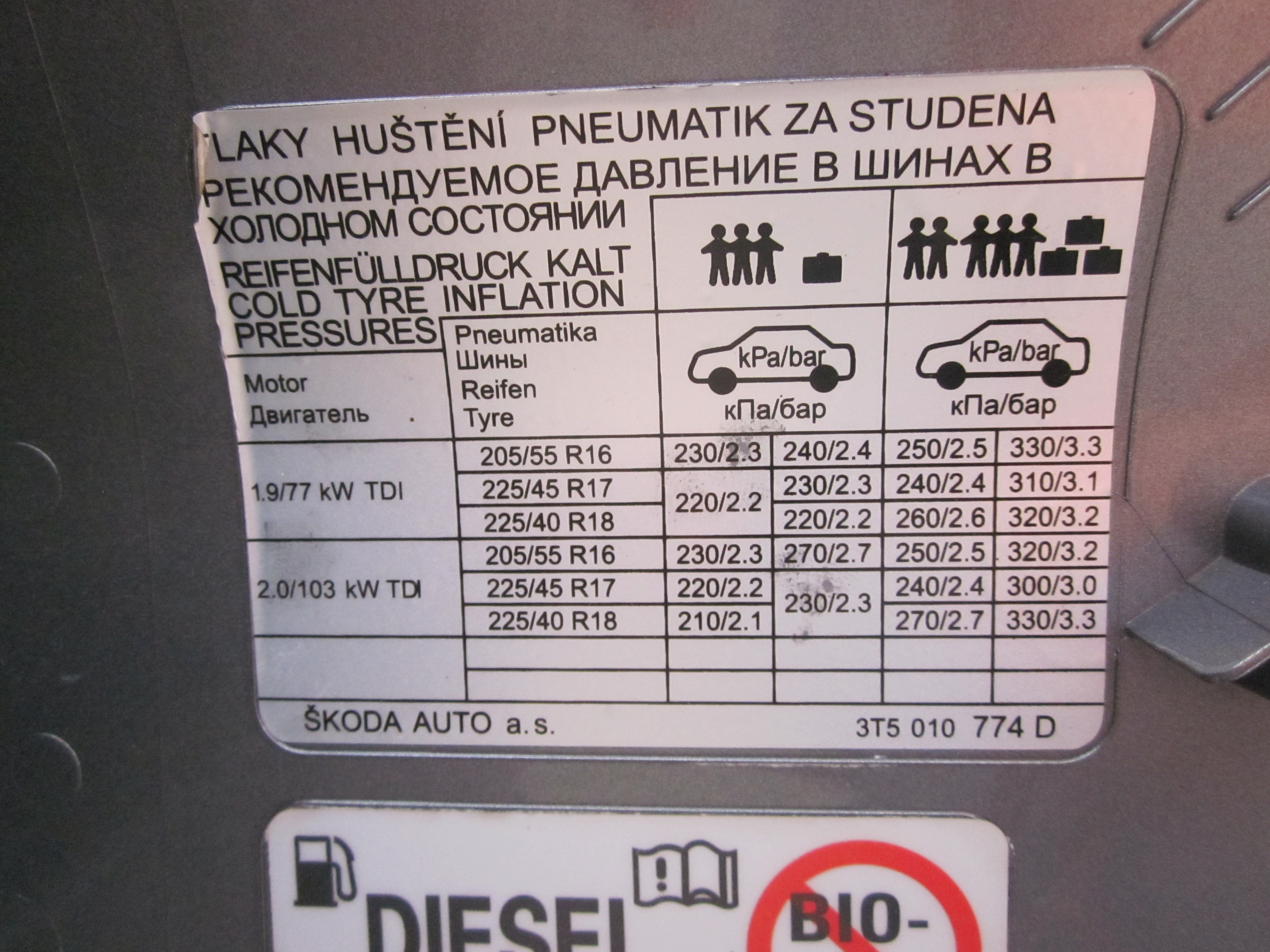

245/45/17 instead of 225/45/17
What do you think? Anyone tried such replacement?
Fuel consumption will increase - hopefully only a bit - but sidewall height will increase by about 9% so the ride should be more comfortable.
And it should look better ;) without going for 18".
The price difference on Uniroyal RainSport 3 is only about £15/piece.
