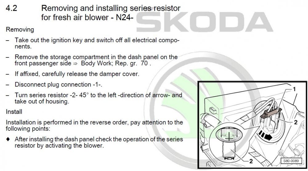

Located on top near the fan. Adjacent to the upper end of the pollen filter.
Probably removing the glove box assembly will give you the required access.
p/n shows as 6Q0959263A

Spiz, thank you very very much. Really appreciate the help. Is removing the glove box assembly easy to Do?
Glove box removes easily. Torx bit required. Remove slowly and disconnect plug from glovebox light whilst half out.

Rotate the resistor to remove.
