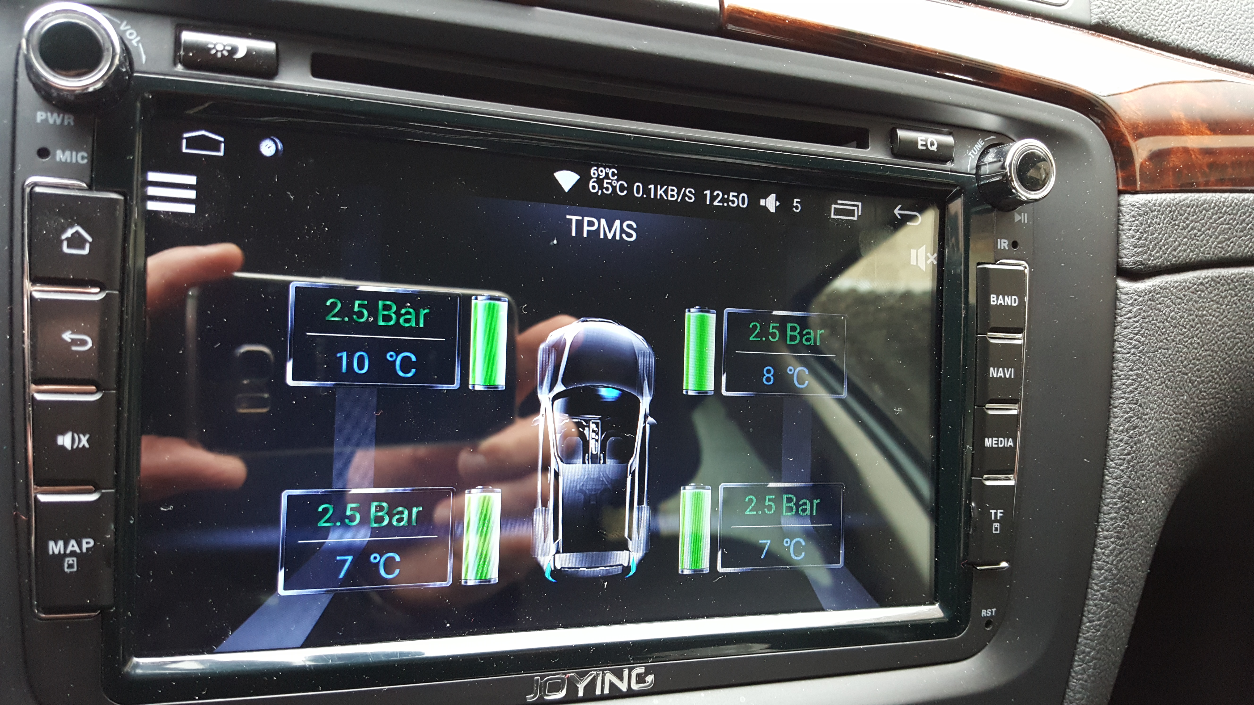

Another gadget to enhance HU usability - TPMS system with software for Android:
TPMS (internal)
HTB1KJ9Wh93PL1JjSZFtq6AlRVXan.jpg?size=1
Ordered it on Ali today after a confirmation from HU's forum mate that it works OK on Joying (Intel Atom x3).
Edited by ste2000
Soft
Just had it installed during seasonal tyre swap, asked servicemen to pump 2,5 - looks like sensors are quite accurate:

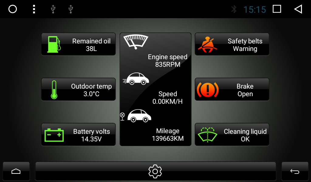

Noddy90, in Joying HU there is an apk showing the following info (CAN based, I presume):
Car Info
Edited by ste2000

@Noddy90 here is the screen I have in the pumpkin. Its an app called Car Settings..
One other thing. In my unit I dont see the Air Con settings on the unit when I change something but canbus for all the other bits are fine.
Do you see the AC settings on the screen when you change temp or fans or something ?
I don't have a page like that (wish I did) bit I DO get a brief notification at the bottom of the window of changes to the AC...
