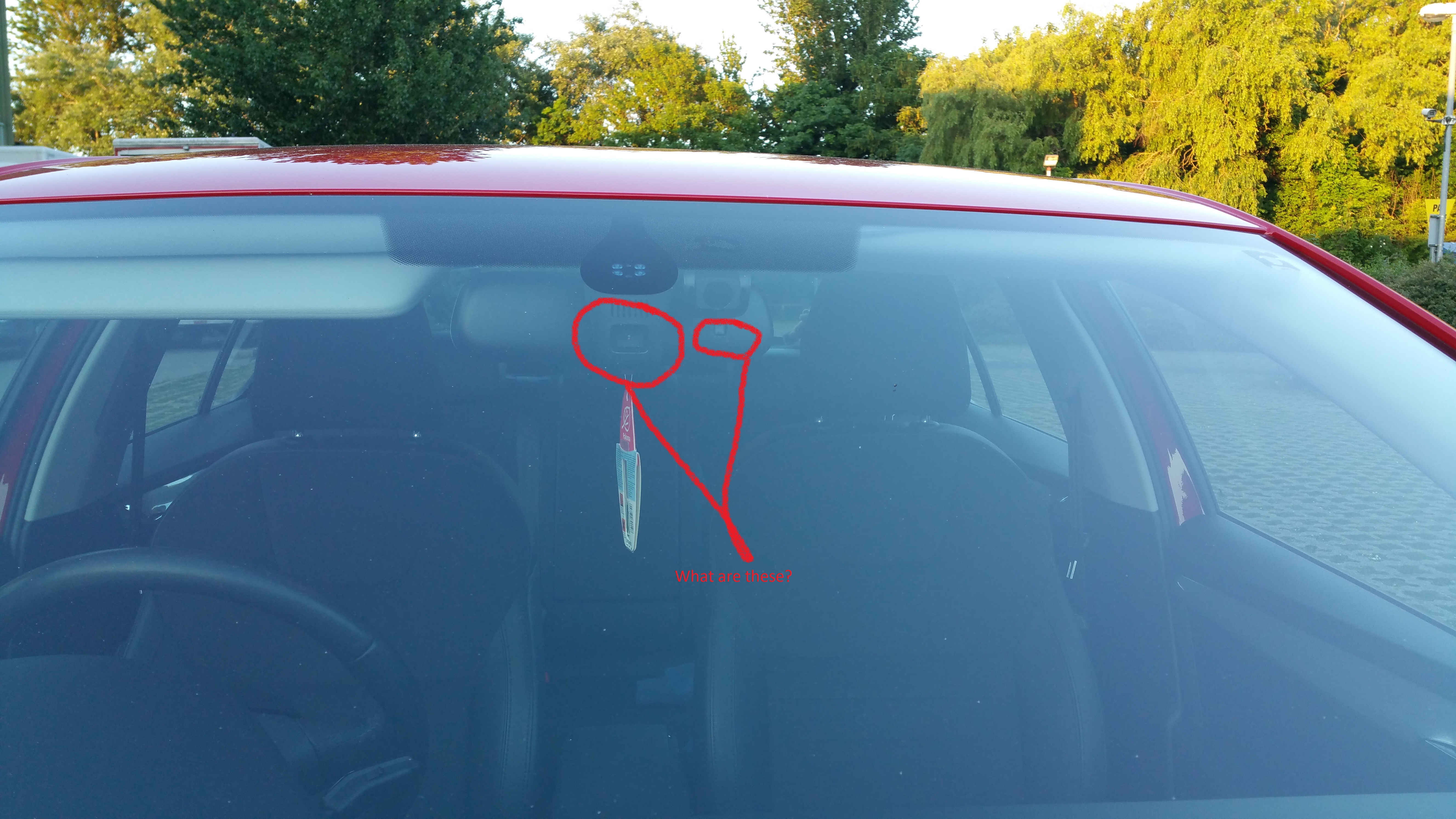

I have a querry about some sensors.
My Octavia is 14 plate and I do not know what are these sensors.
Thanks.
In the center mirror is the light sensor I think. Center one maybe Lane Assist? But should be next to the rain sensor so not realy shure? First time I see that on Octavia.
The one in the left circle is for high beam assist.
The one in the right circle is for the auto-dimming rear view mirror.
Above the left circle, you also have a rain light sensor for auto wipers/headlights.
If you have lane assist/traffic sign recognition, you'd have a much bigger camera fitted.
langers2k has it exactly correct.  I've the same set of sensors on my 2014 Elegance model.

Thank you, that solved some of my dilemmas. If that in the middle is for high beam assist then I have a problem. Every time I try to turn on the high beam is popping out an error as the high beam assists is faulty. Do you know the reason why?
