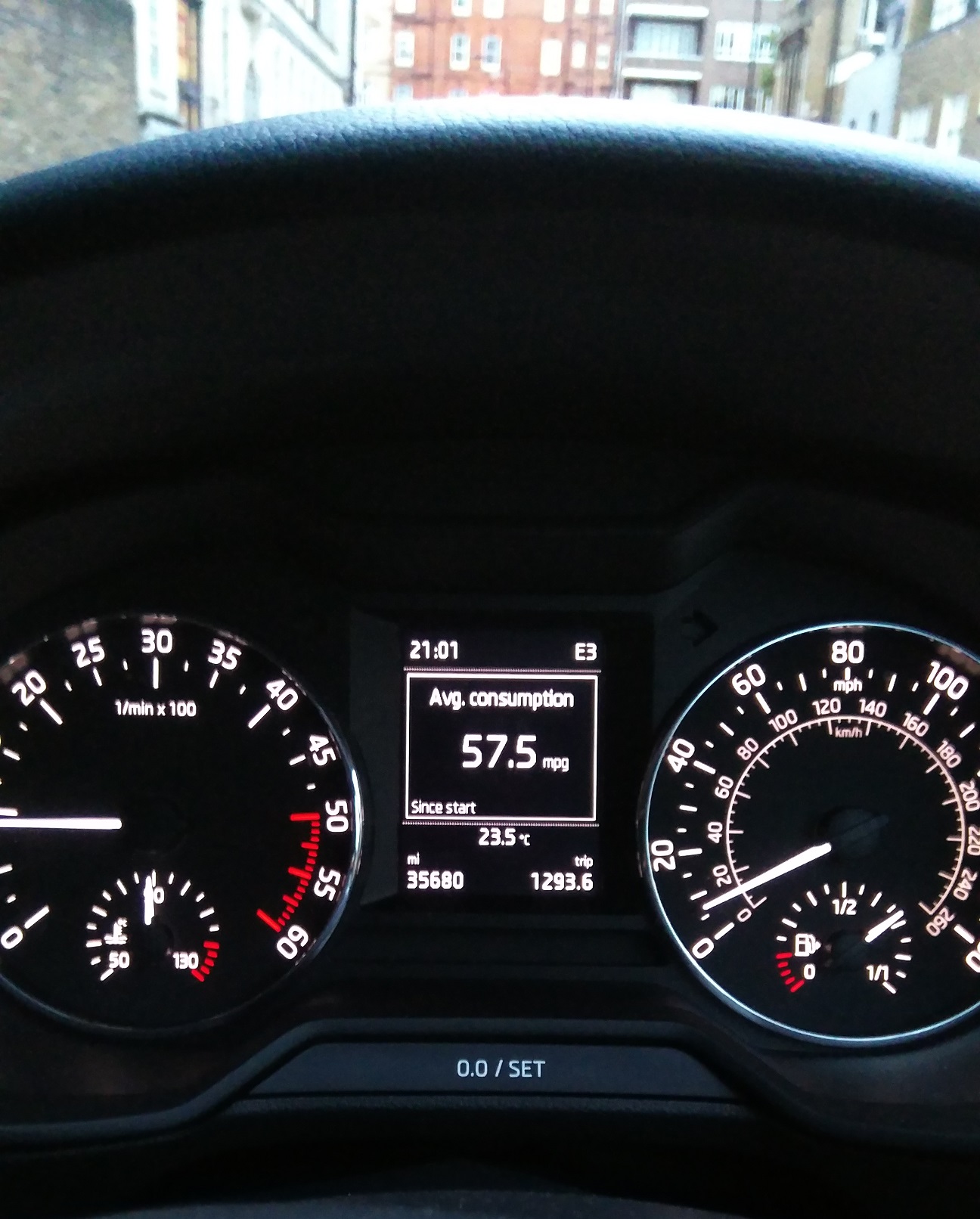

Did 18 miles on motorway with some slow moving traffic +14 miles in central London. 4 passengers +me +4 suite cases in the boot. Look at this amazing mpg figure:
This thread needs to be renamed to "Fantastic fuel efficiency" :D
