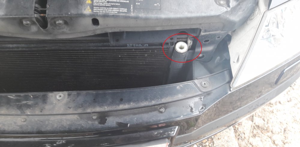

Dealer has diagnosed a leak from my condenser, not from a stone hitting up or owt but from some sort of plastic nut at the end where it attaches to the dryer? Not knowing much about a/c systems other than the theory, does that make sense to where the leak is to anyone and ate they correct in saying the part isn't available separately so you have to replace the whole condenser?
I asked if it's anything in the dash that needs getting to and he said it's all angie bay side.

I've not seen one with the plastic nut as an aftermarket part, hence why I had to change mine, all I needed was the drier pack that hides in there.
Yes the front end has to come off, you don't need to take the rad/radfan pack or the intercooler off.
The thing with the plastic nut is the drier.

Think this is what the dealer is saying is leaking for anyone not following...
By the look of it though, is there not just a replacement plug available from aftermarket?! Someone on the link below said they just swapped one with a scrappy one and it was fixed! If it's possible to do that, and there's a pic of a replacement internal kit which you'd change anyway, then isn't it likely that the white plug is available somewhere? Frustrating if that's all it is and it can be changed without all the faff of taking the front end off!! :dull:

I have the condenser off my car still, if you want the nut PM me your address and I will pop it in the post.
Regarding the questions,
1) You should change the drier every 3-4 years, it contains some sort of drying agent and gets soaked in moisture as it takes the water etc out of the system, also when changing compressor.
2) Some cars its a separate item, not on the octy, nope you take the nut out and fish the drier pack out and replace, that's before I found out VAG don't do the drier pack anymore, so you now have to change the condenser, brilliant:thumbup:
3) That will need a new condenser.

Regarding the photo, yes that's where the drier is, like I said you can have the nut I have if you want it, just remember to have the system discharged first.

Thanks for the offer of the hex plug, but I'm guessing then that if there's no replacement kit for the internals then changing the nut won't matter as I'll have nothing to stick back in once I ge tthe old stuff out! Also, it's been ice cold up until now since brand new so never wanted anyone d1cking about with it so it's got 9 years of condensate use to replace! If it's to be changed every 3-4 years ideally, surely that doesn't mean that every 3-4 years you have to replace the entire condenser?!! Will the replacement one have the bolt on cylinder version so that it CAN be changed in future?? Just I know ECP, etc all do a cylinder replacement so it must fit something?!

The workshop found the same on my car just now..... Any progress on this?
They tried removing the nut but it's jammed in there. I do hope this is a removable part... :(
Pot luck if you can get it off but once you do you can't get a replacement, hence the complete condenser job.
Got the condenser replaced with a Hella one. No stupid white nut, all sealed up so nothing to be a weak point. Got a new pressure switch at the same time as a precaution and cost £343 all in, couldn't bne happier with the work. The guy is a mobile aircon mechanic in Woking, http://autoairconditioningltd.co.uk/ Absolutely top notch, had it replaced in about a hour 45 which was incredible considering other garages were quoting between 3 and 4 1/2 hours labour!!
