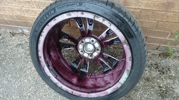

1st Bilt Hamber Korrosol - amazing stuff really, £16 (1000ml) so quite expensive however after using all 3 I always ended up using this stuff to get rid of any final contamination I especially like the fact it sprays on clear and only goes purple when it's working also required little to no agitation and when it was worked in brought the alloys up like new.

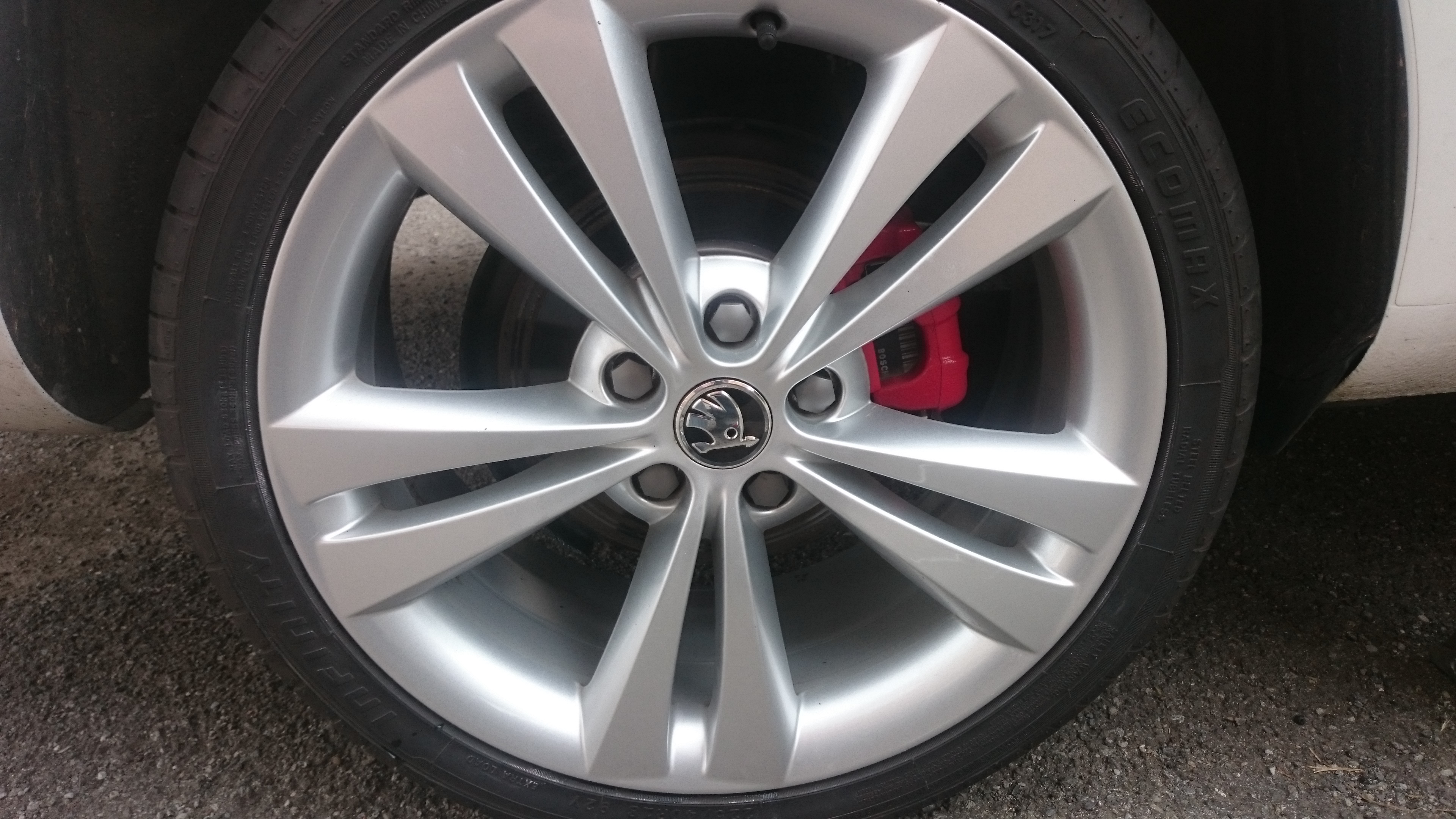

Korrosol the fine spray sticks to the alloy as seen below really well which allows for a greater dwell time
as you can see it does a great job of bringing the alloy back nice and clean

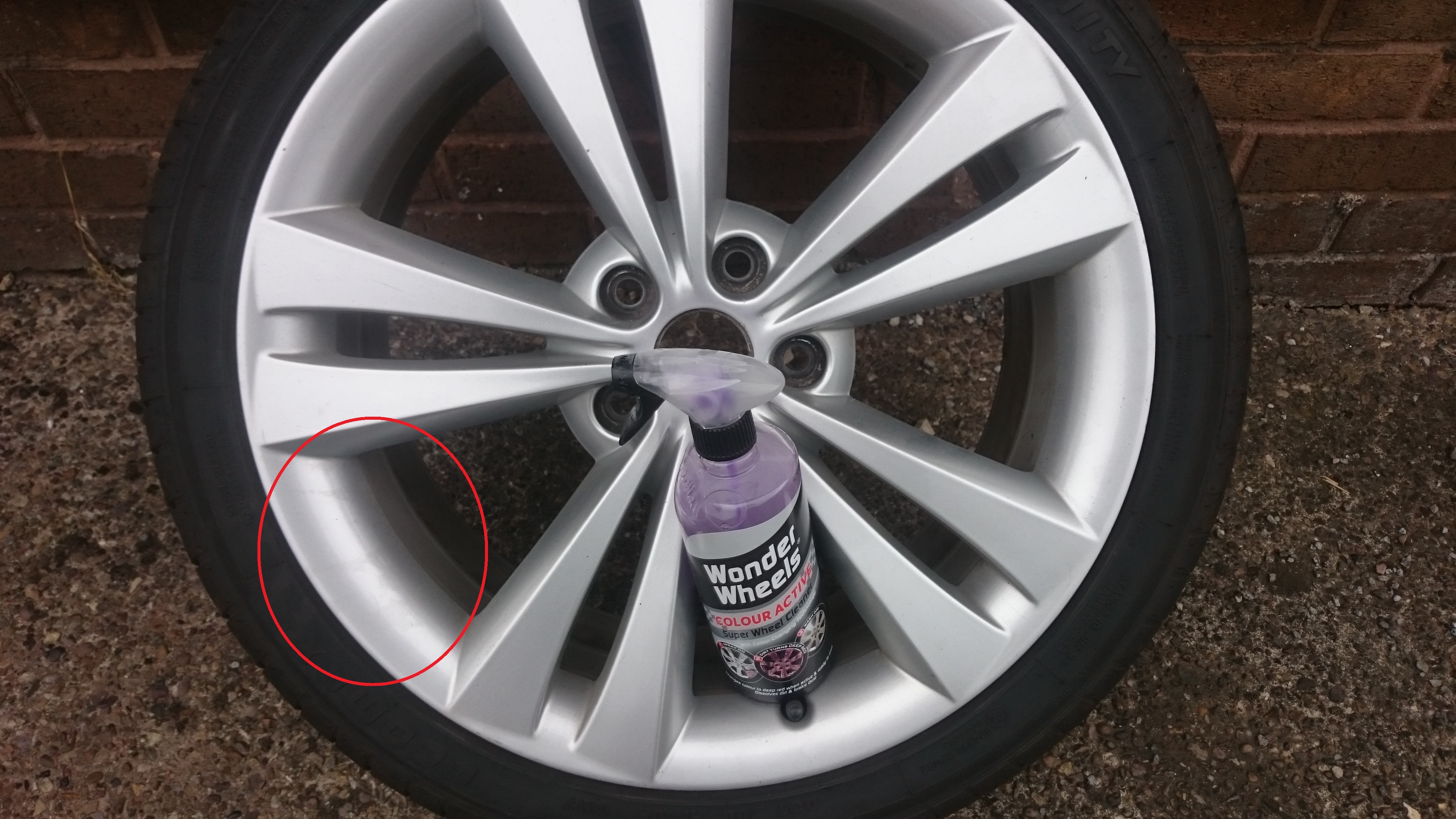

Wonder wheels, as seen by the ringed area, spraying on and rinsing off only, did leave some areas not perfectly clean but after working it in with a brush it did get all areas clean. I don't like its claim of colour active when it sprays out purple to start off with .
overall not bad when worked in and it did get through to the rear of the rim well and cleaned that up nicely 7/10 not perfect but does a good job for the money and time

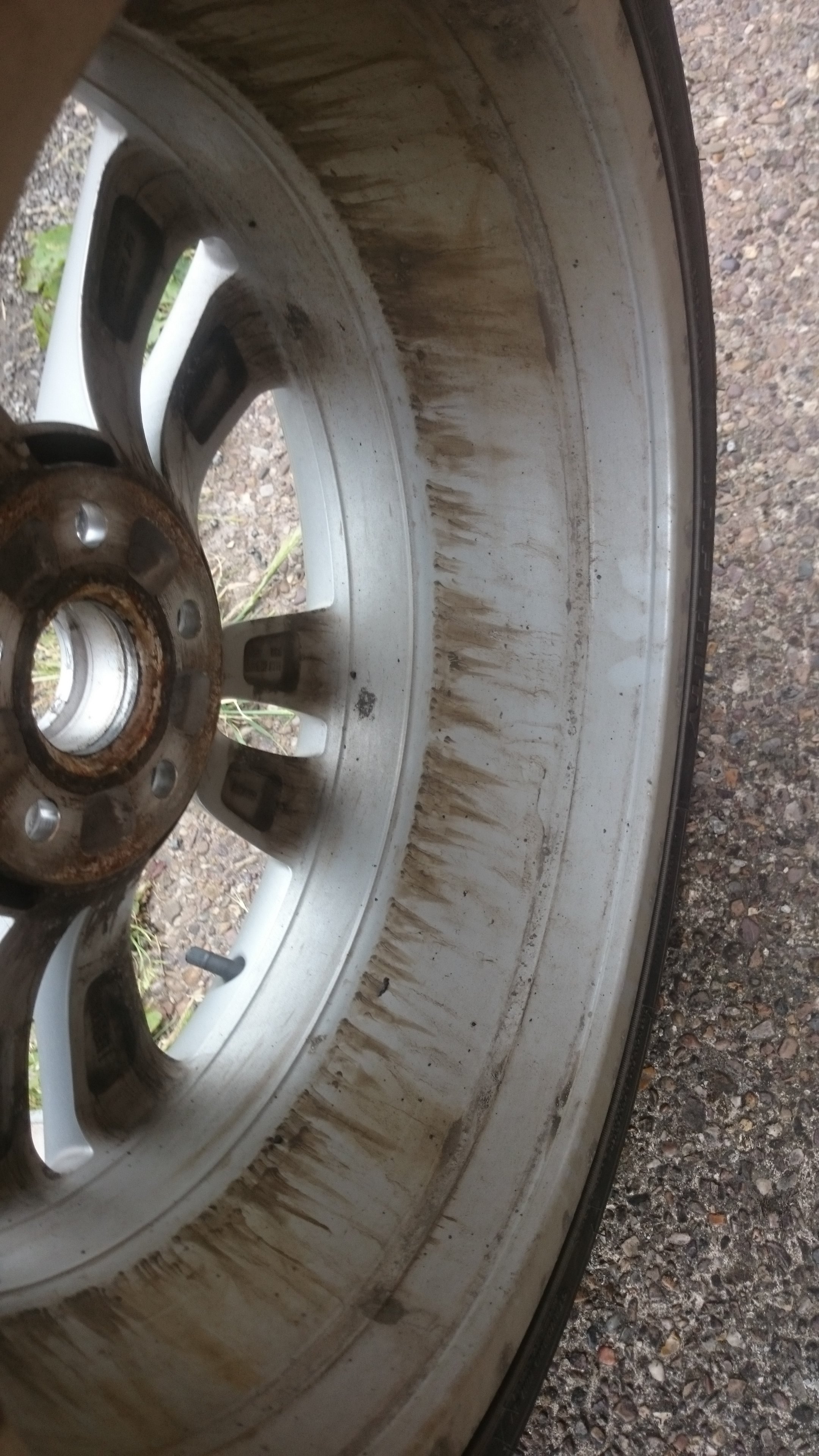

Simoniz - did a fairly ok job  on the front but clearly as seen below not strong enough to penetrate to the rear of the rim and required spraying from the rear and working into the rim to get this off. 5/10 if on offer in Tesco for £3 again possibly, other than that for the £3 more wonder wheels is much better.

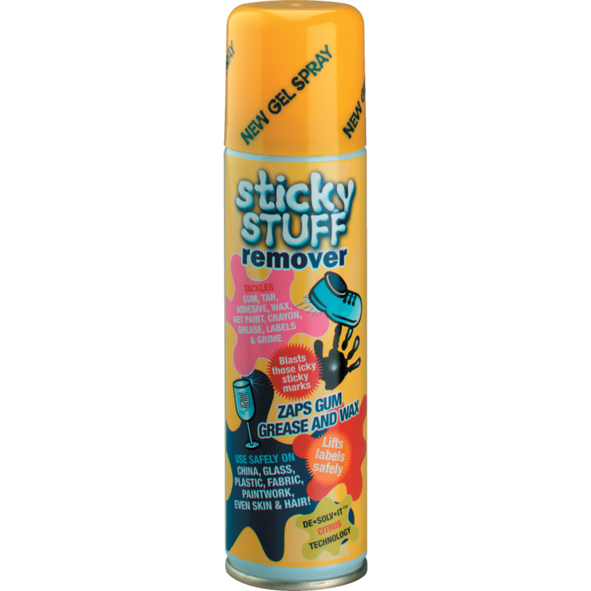

ok so not really a car cleaning review but I thought this product was worth a mention, I've used it to take off all my badges on every car I've had, dead easy, spray it on doesn't run as its a gel, and doesn't damage paint so no need to be careful, leave it for 5 minutes or so, then either pull the badge off or get some floss behind it (what I do) and saw it off, but the best thing about this is the residue that's left behind from the badges then simply wipes off and it also takes any marks left behind with it too, so if you're thinking of removing badges get this stuff

You're a bit more diplomatic than me. I thought the Simoniz stuff was pants. I also got it on offer from Tesco a couple of years ago. I tried it a couple of times and it's been 'resting' in the garage ever since.

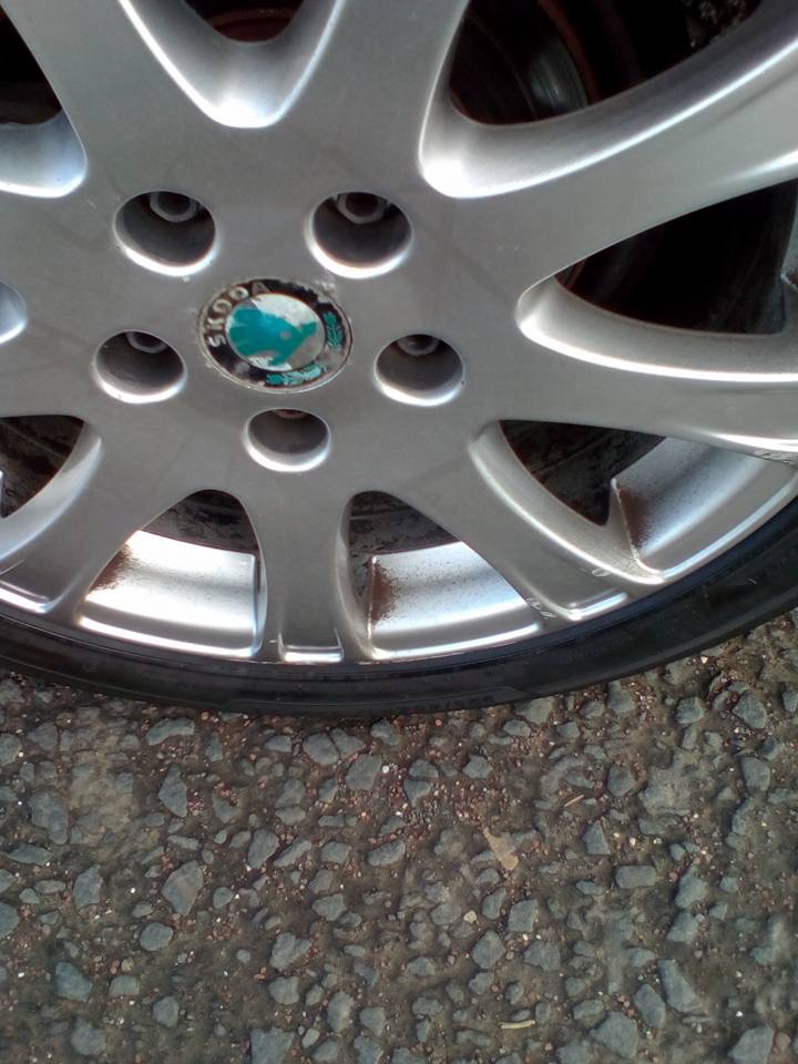

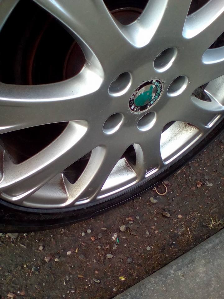

I'd tried the wonder wheels on my alloys and even agitating it done literally nothing to remove baked on brake dust .... Not even a faint hint of a colour change either... I've not tried the Simoniz but have used some of their other stuff which is ok....
The wheels where finally cleaned using WoWo's wheel cleaner which still left some really stubborn spots and these gif cleaned off earlier this week ith the fallout remover from Chemical Guys ... Didn't get a photo as the rain started chucking it down
be careful with your cleaners as you have some corrosion showing on your wheels which will start to come off if using something strong - especially if agitating with any kind of foam or hard brush.
my recommendation to you would be get some korrosol and a horse hoof brush (for applying oil) and use that to work the spray in very lightly then water rinse off (no pressure)  ideally have your wheels refurbed
