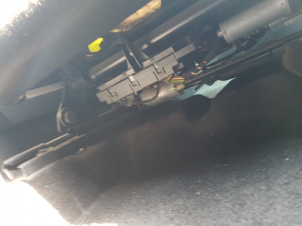

Check under your drivers seat whether there is the phone module under a plastic cover, if there isn't, then BT isn't fitted.
This is under the drivers seat

The module is mounted to the floor like this one.....
Oh, so I dont have it... Anyway, thanks guys for the info.
