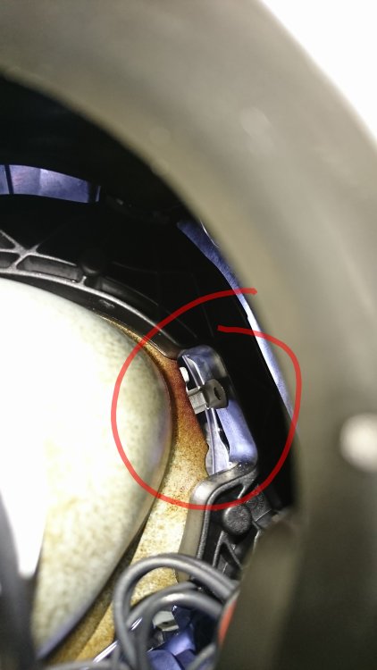

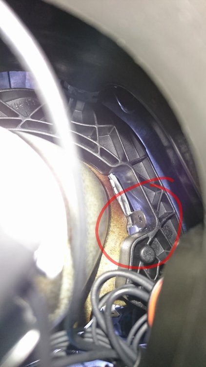

With the lamps on the car this is quite a fiddly job. As you will be going in blind, so that you know you have the right part, the lever is aluminium and will make a ‘ting’ sound if you flick it. This was the only way I knew that I was correctly on the lever. I would also advise taking before and after pictures so that you know you have moved the lever. The pictures shown here are the view looking straight in from the back of the lamp. There is only room on the inside of the bulb so you can’t go wrong.
1. Remove the rubber cap to gain access to the dipped bulb.
2. For the off-side: As you can see in the picture there is a metal lever which simply needs to be pushed down. This is located on the inside of the lamp (right side as you are looking from the front, reverse this if you remove the lamp and can look at it straight on). I could put my finger on it but couldn’t get enough purchase to actually move it. However, if you carefully manoeuvre a flat head driver you in there will be able to gently push the lever down.
3. For the near-side I would advise releasing the battery (but leaving it connected) and sliding it over to gain access to the lamp. The leaver is on the inside of the lamp again (left as you look from the front) and functions up rather than down. Again I have attached a picture to demonstrate the positions.

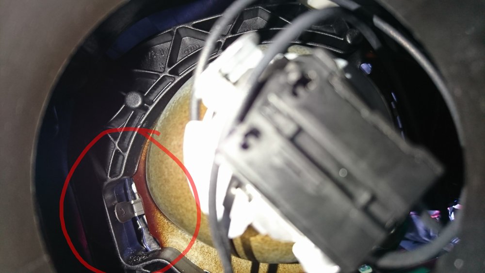

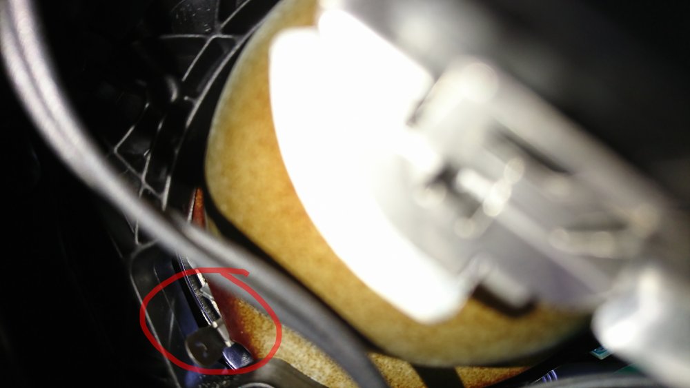

Sorry guys, this is the off-side in the UK position...
And this is the off-side in the adjusted position.
This is the near-side in the UK position...
And the near-side in the adjusted position.
Hopefully that gives everyone a better idea of what you are looking for :-)

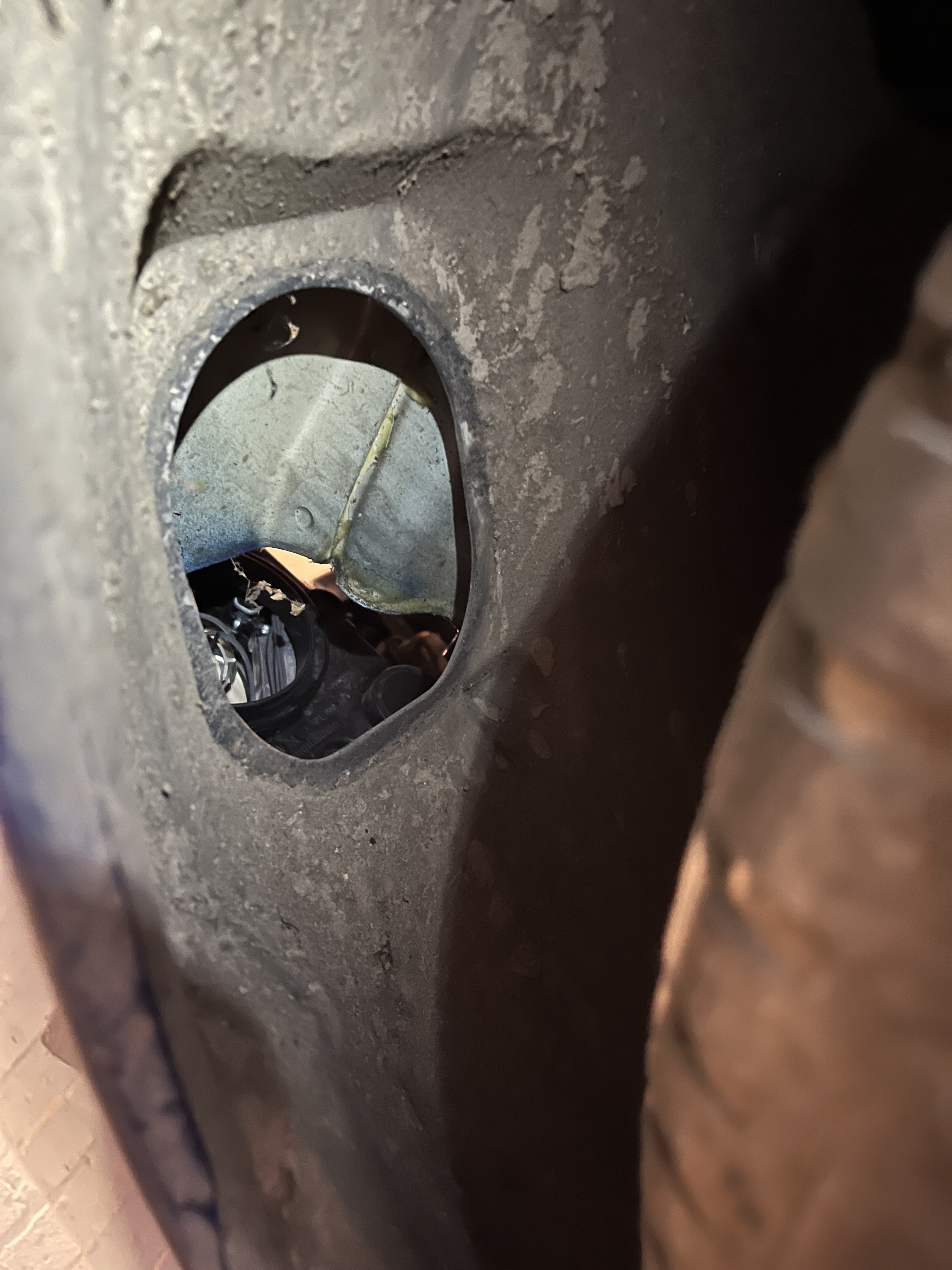

Hi - these tips were a godsend! Just adjusted the lights on my Fabia and all's well for our trip. I removed the plastic covers in the wheel arch and could see the lever shown in these photos. The levers moved really easily when pushed gently with the end of a screwdriver. Thanks again.

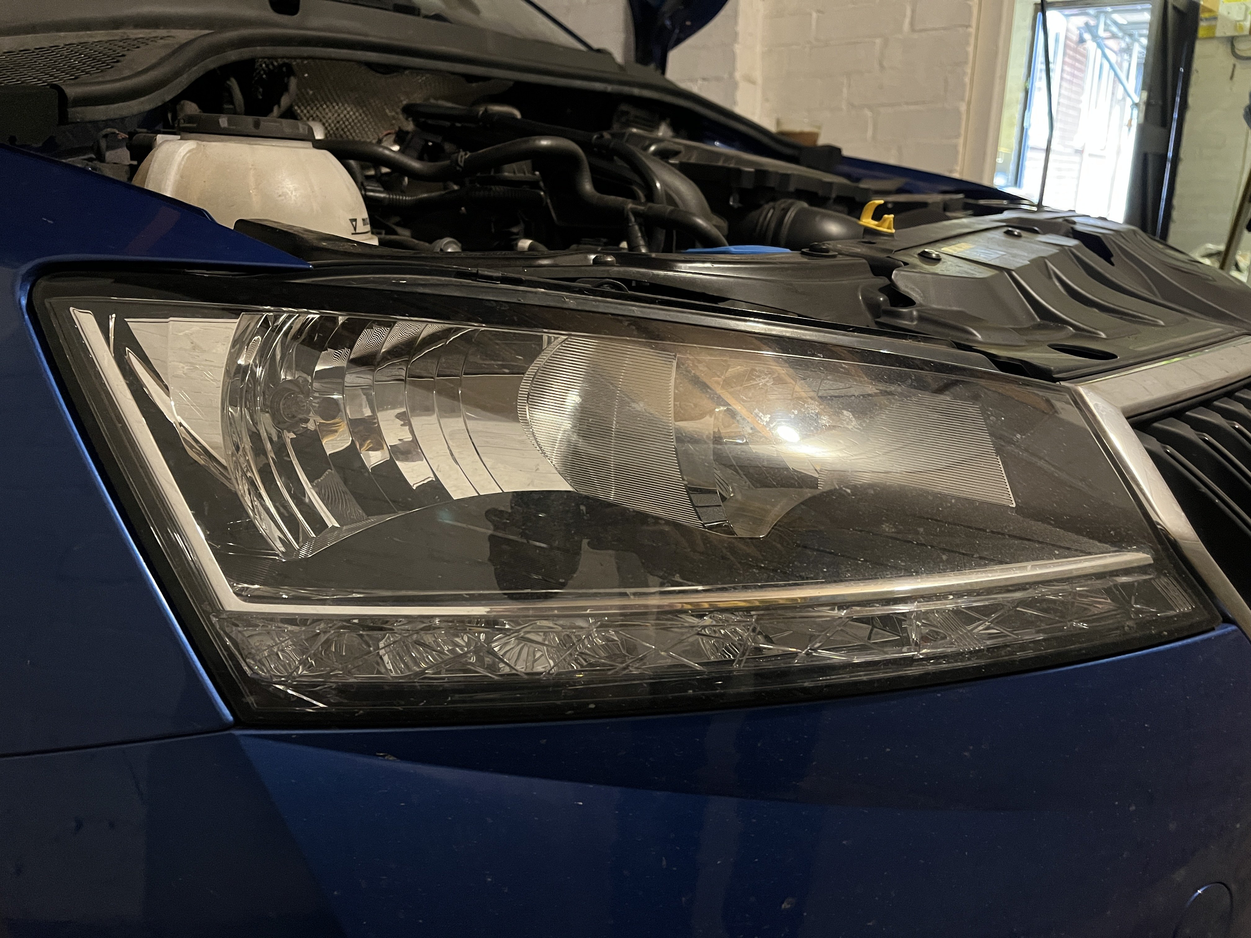

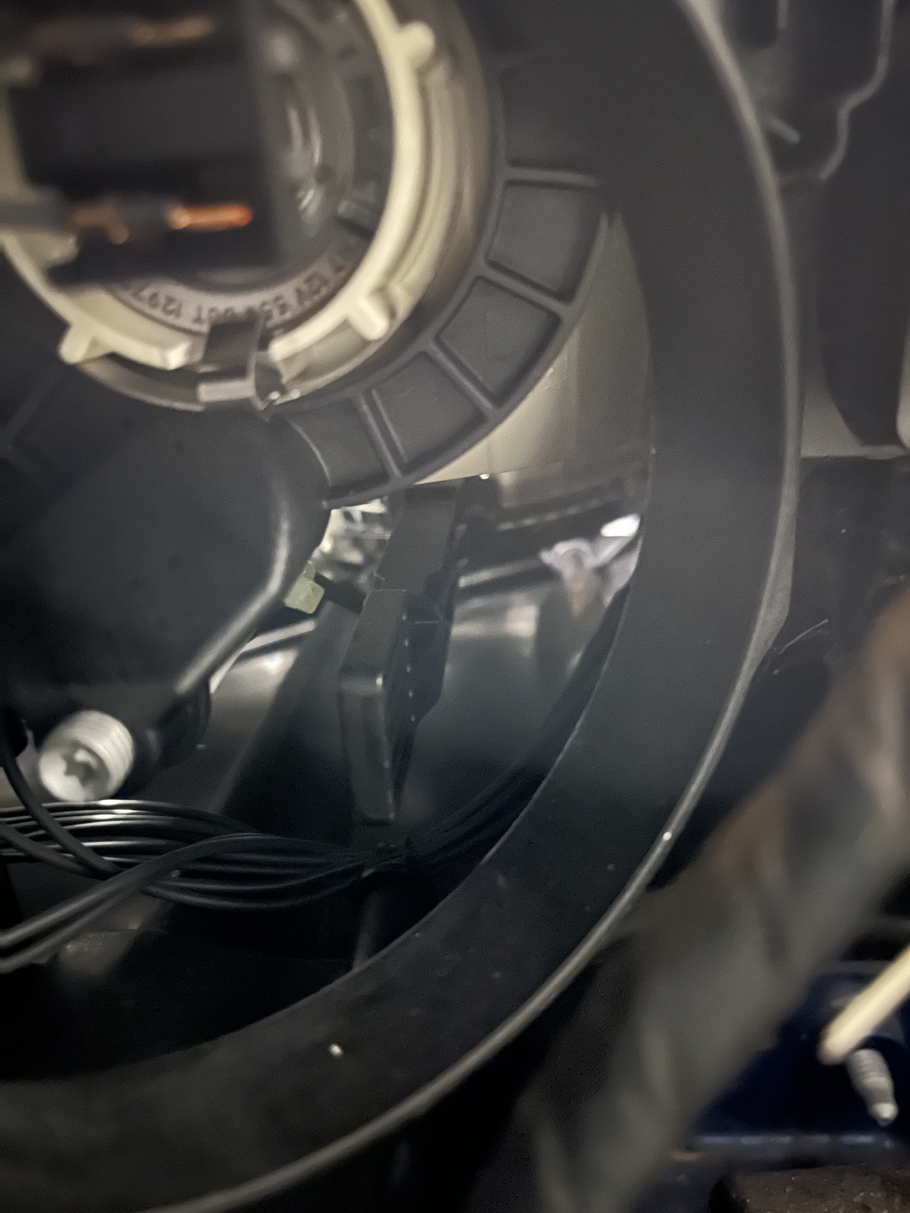

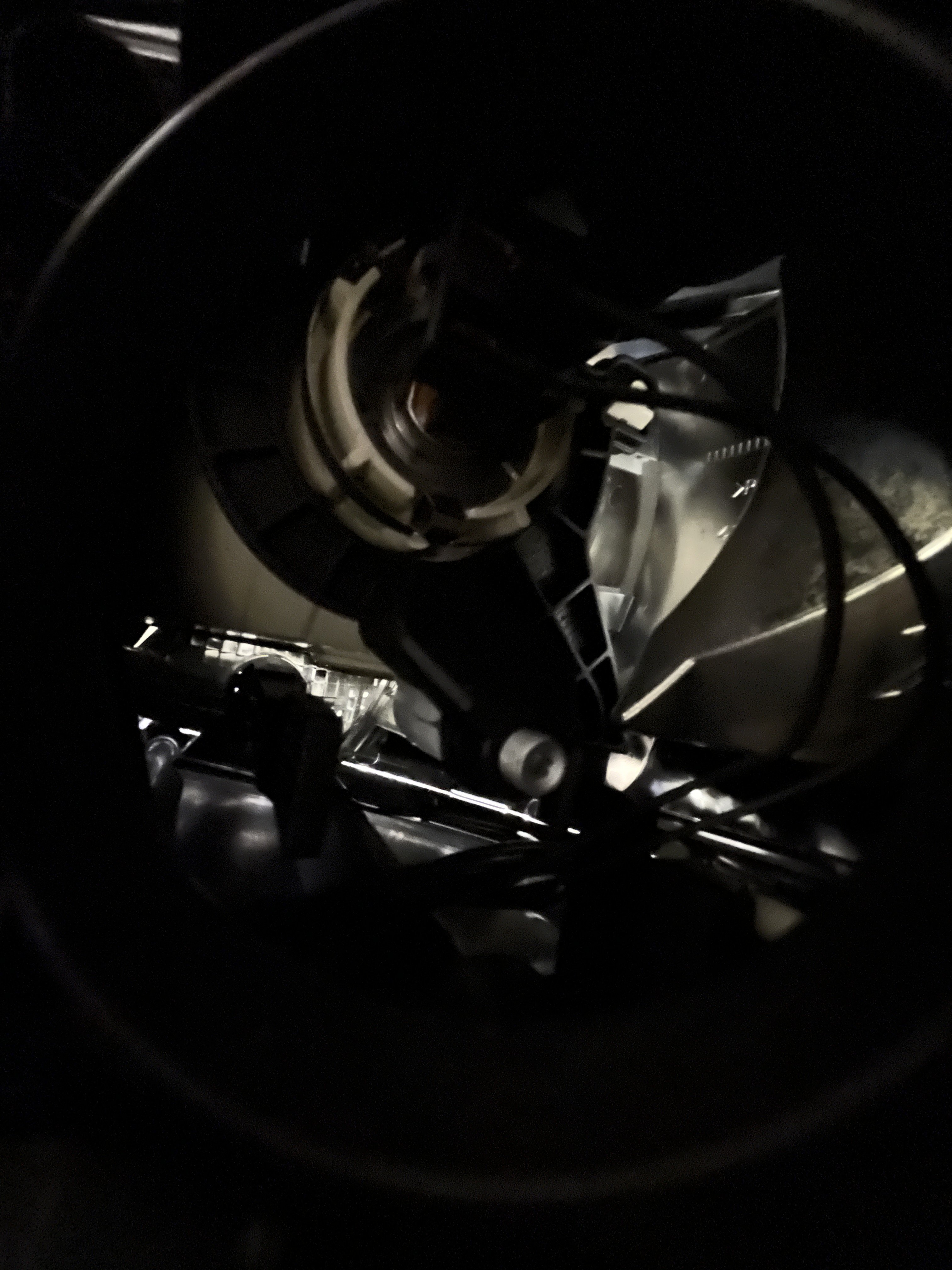

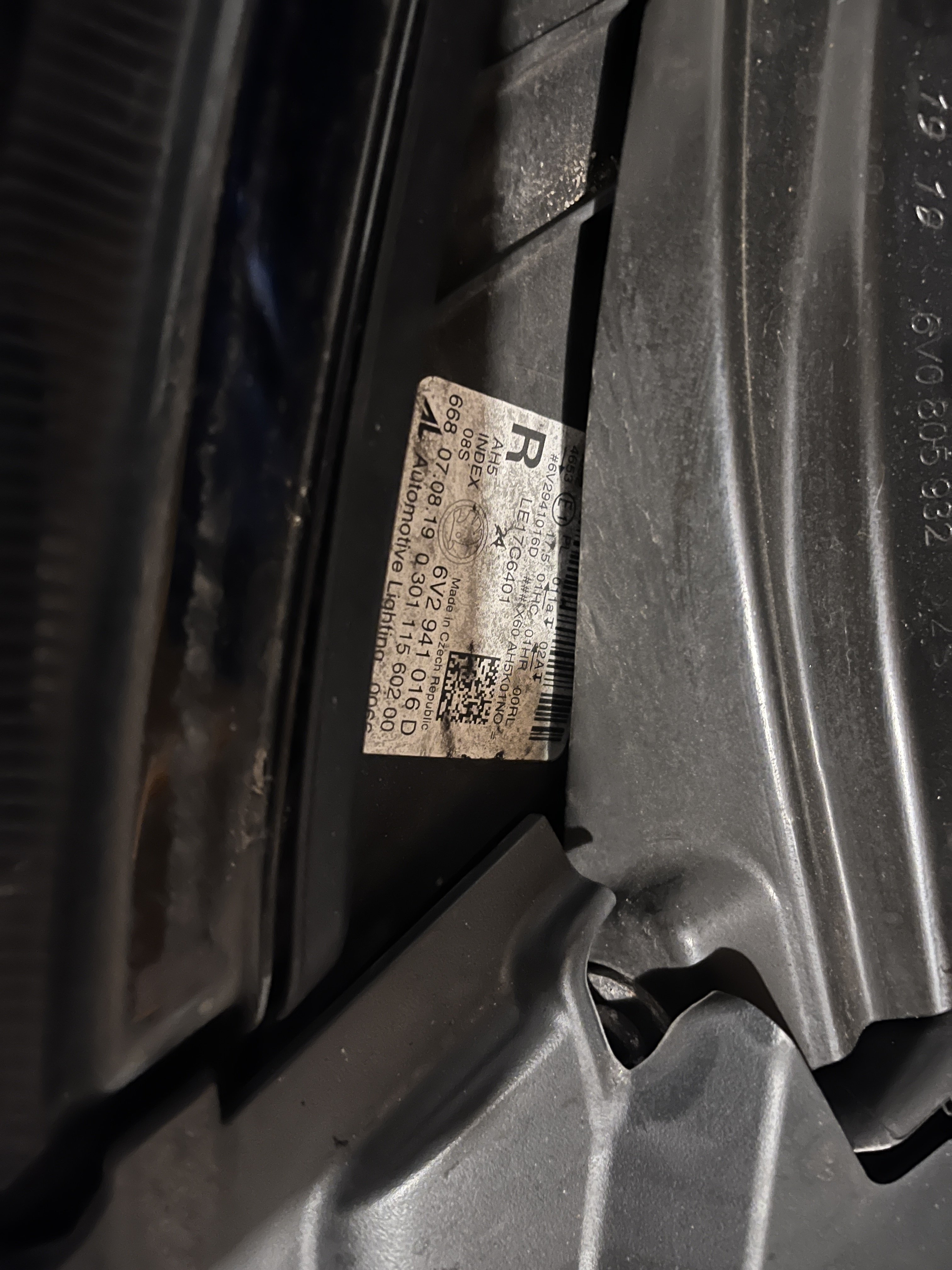

Sorry to bring such an old thread up but I’m often travelling to Europe by car and would love to figure this out. I’ve had now two attempts at finding these levers but I think my assemblies aren’t the same? I have a mk3 Fabia estate se. Photos attached. I simply don’t see the levers? Could anyone help me please.

I don't think your car has those type of headlights, yours look to be halogen type.
For a Mk3 Fabia (2020) If you have LED type headlights you adjust via the infotainment menus but I forget if I've seen how to adjust them for halogen,

If you have the 4 x H7 headlamp type unit then:-
You want to remove the rear bulb rubber covers from the dipped beam bulbs.
These are the outer two which are almost under the wing.
Then look for the small silver lever.
Are your photos of the inner two main beam bulbs?
Thanks. AG Falco
Oh my word I didn’t realise there are two covers! I must have looked at the outer larger ones. What a numpty. I’ll check later and get back to you. Thank you!

So I found the outer lamps (how was I so blind) but couldn’t really see or get to the levers. Starting to think that it’s probably not feasible to adjust these on the Eurotunnel if I can’t even find them. I did however find the handy inspection covers in the wheel wells giving better access/view into the lamp assembly.
As with aa lot of items on modern cars your dealing with black bits of plastic against black background, often other bits of black plastic, in dark areas that can be awkward to view and the bits are often cover in black oil and debris and/or mud.  on my wife's 2015 the covers are to access the incandescent DLR bulbs which are a PITA and wrist to get at and despite being cleaned and lubricated the covers are awkward to pull off with the wheel/tyre in the way.  I've had to take them off twice already as the bulb holder or wiring or something doesn't seem to be up to the job of keeping 21w bulb alight and will have to do it again to swap to LED bulbs so the DLR can be switched back on as the car owner wants. I have real difficulty refitting the bulb holders so have my, normally very relucent and absent, glamorous assistant do that part.  Gawd knows how I'd get to the other bulb through that access.
