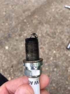

well thank fook I changed all 4 then! lovely to get the denso's in and response is much better from engine - see old plug they were all like this!
