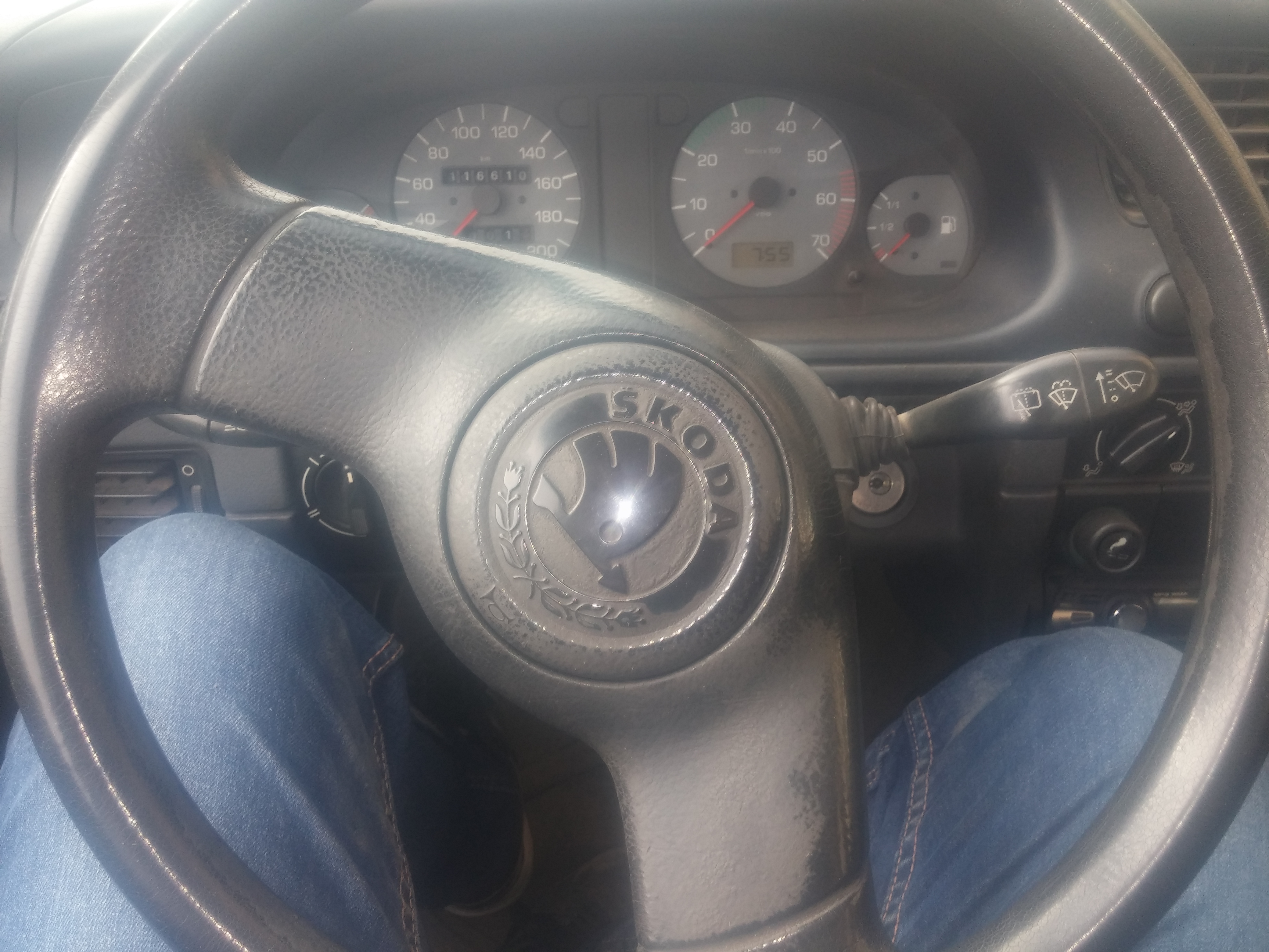

Hi all members i have problem with the steer lock  after i pull the key the angle of lock on the right side should equal the left side but in my case the right side is lock correct but left one i should move steer much over the normal to lock
this problem occurred after i changed the gear steer because the old one become crusty

this is what i was talk about  first pic lock on right side

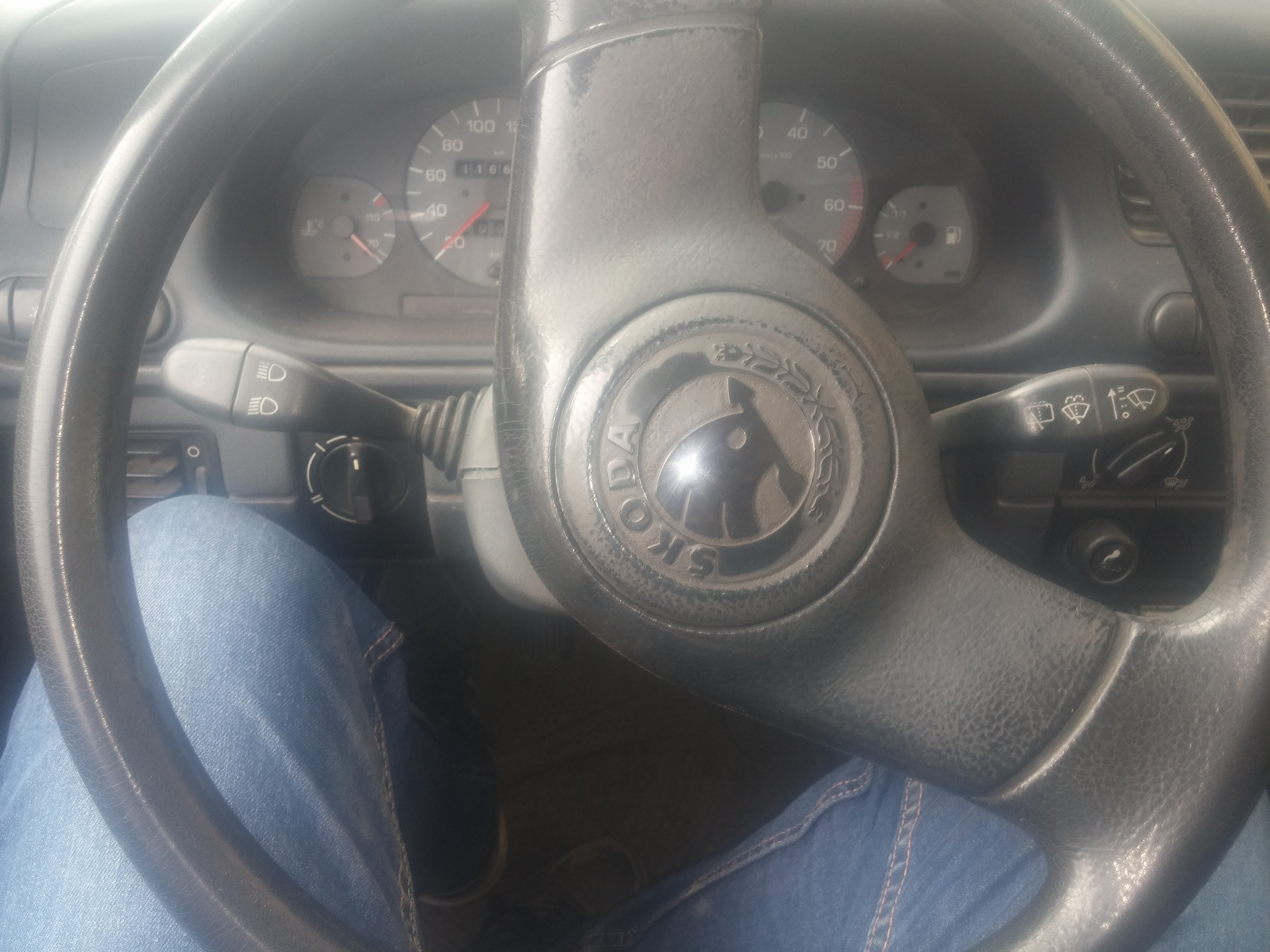

second pic the lock on the left side and diffrent

@captain_crunch - It looks to me like the locking pawl is engaging the wheel/column in a different place. Did you remove the ring that the locking pawl locks into when changing the components?

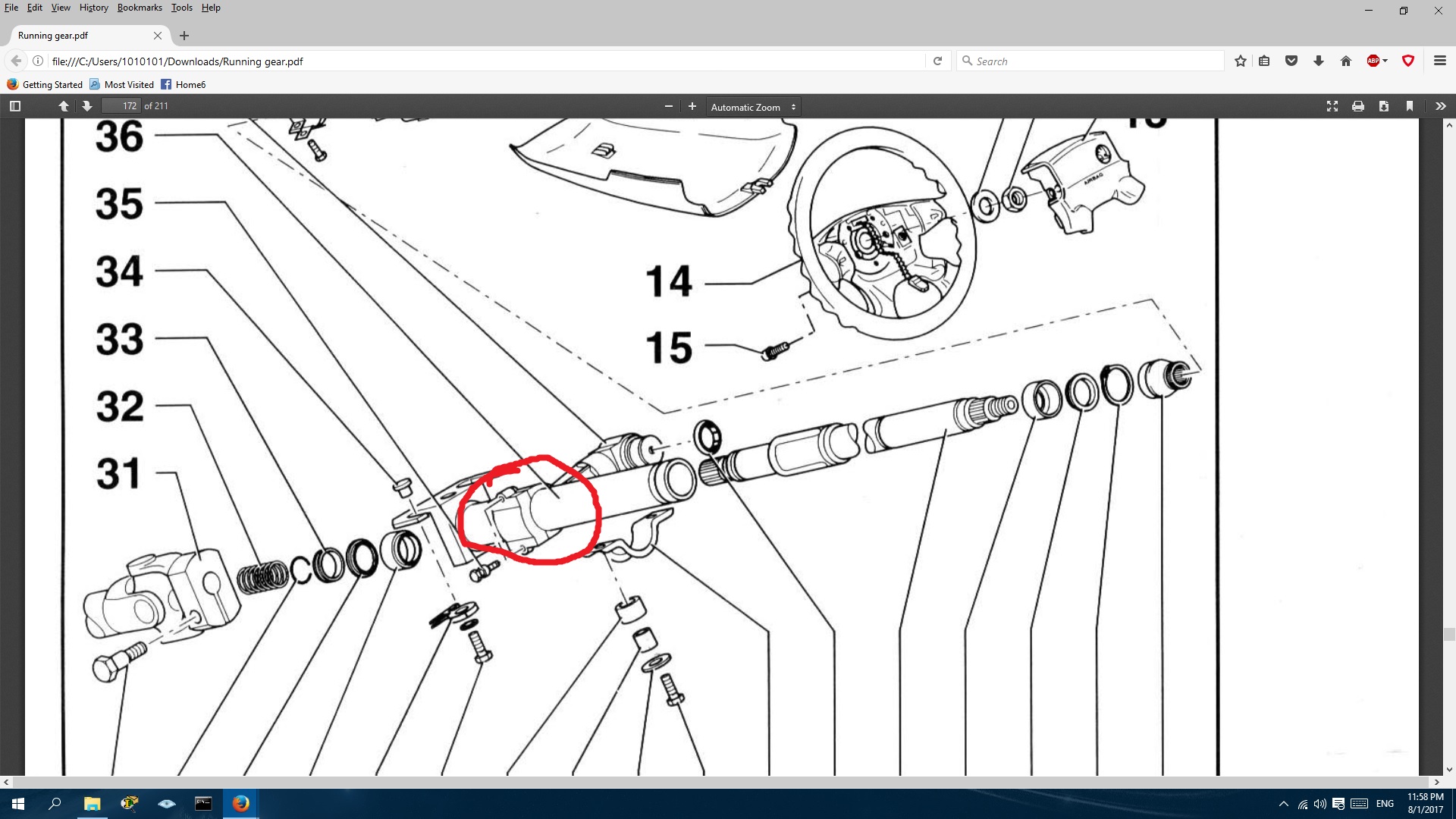

did you mean this part
@captain_crunch @RicardoM Well, this now looks to me like, at some point whilst the steering column was disconnected from the rack, the column was given a part turn, which has moved the slot that the locking pawl engages in away from the "straight ahead". Yes, that slot is inside "part 36" on the exploded drawing.
To fix this means stopping the car straight ahead, disconnecting the rack from the column, turning the column until the steering lock engages, reconnecting the rack, and then re-moving and refitting the steering wheel as close to ahead as the splines on the wheel allow.
