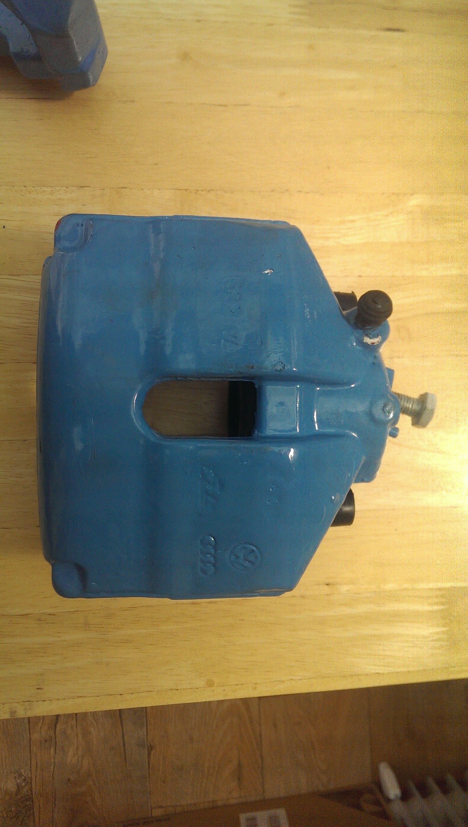

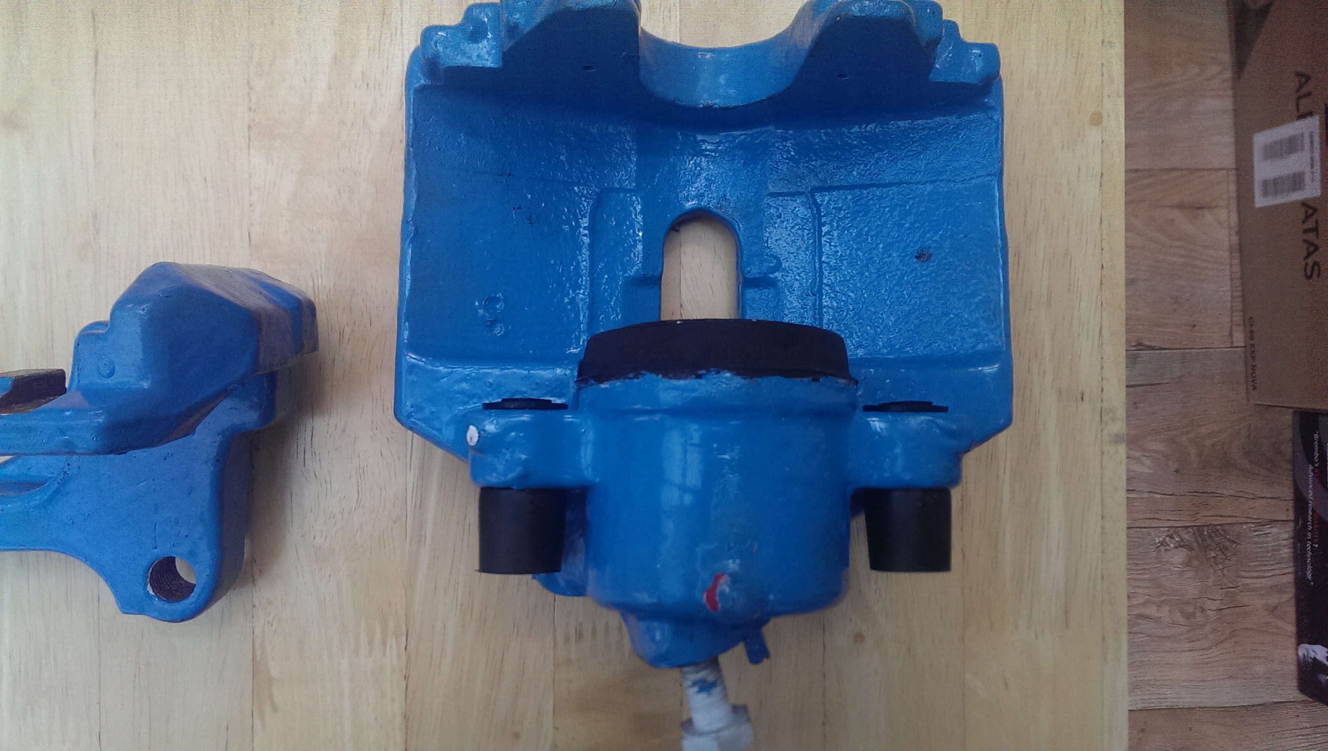

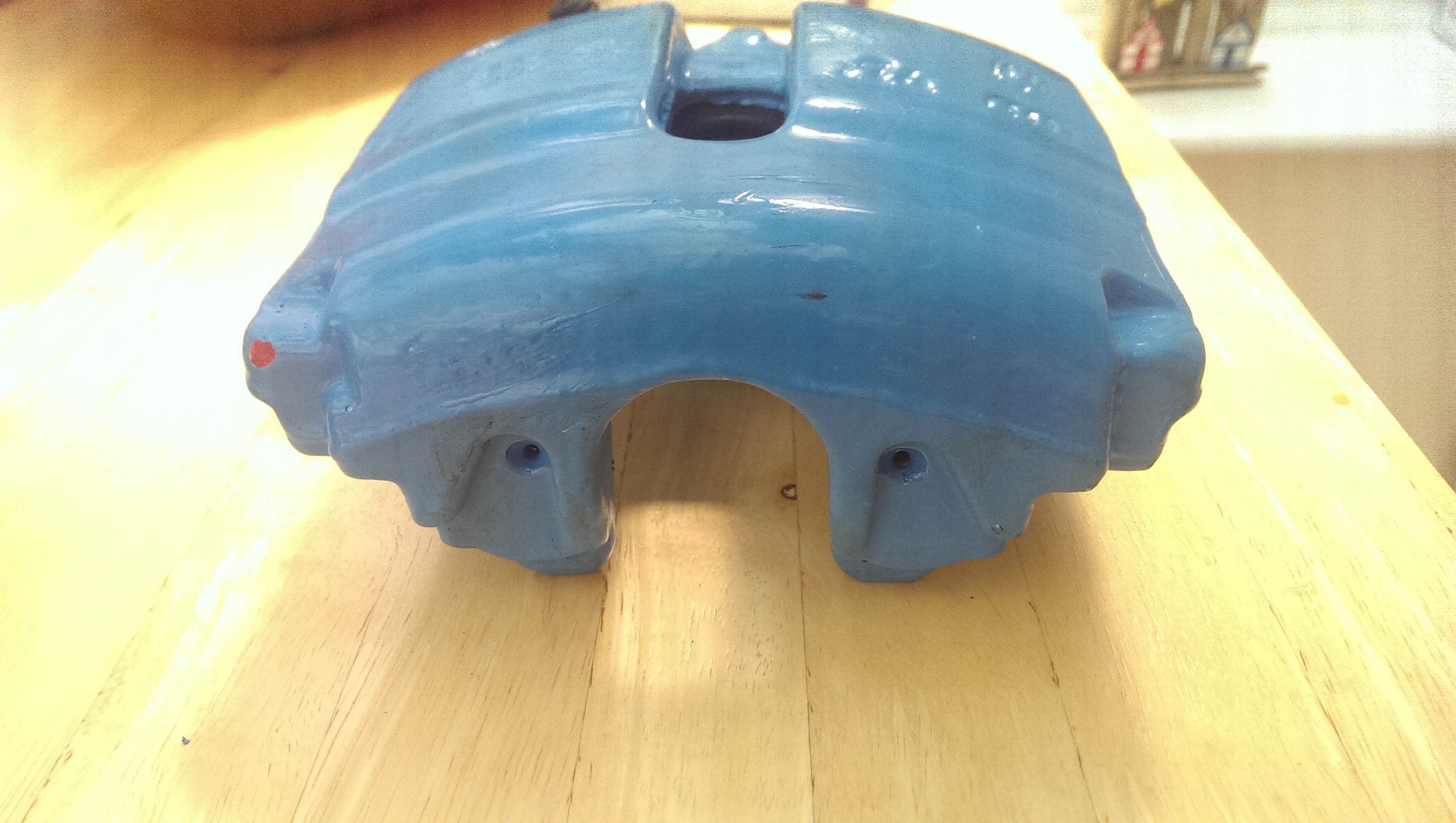

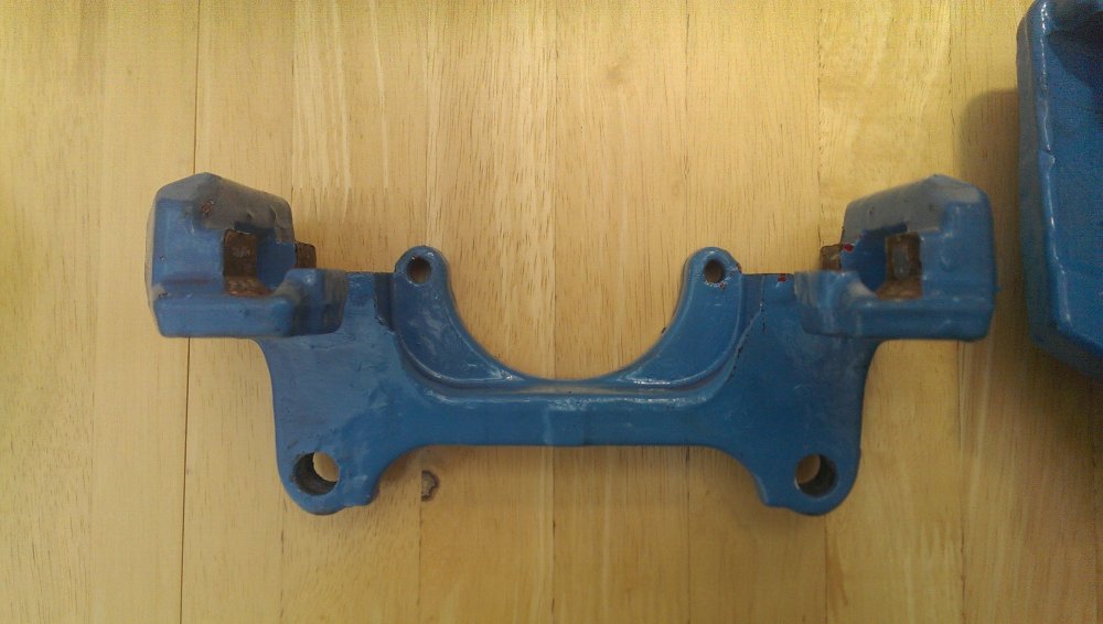

I've bought the seat Leon calipers/carriers to attempt the 312mm front brake upgrade on my mk1 Fabia VRS. However I've come the find the carriers are to big.
What carriers do I need that will fit the the front hub ?. The Audi tt mk1 carriers look the right size, but will my calipers fit ?.IMAG0725.thumb.jpg.e1efa176e9a8a8953878b0a0b14b1c31.jpgIMAG0724.thumb.jpg.709cd0f38de29883f028d724125b8b38.jpgIMAG0726.thumb.jpg.d0e033a082a09046b38f2b4447fc8db6.jpg
any help/points much appreciated.
Just for reference I bought some low mileage audi tt mk1 calipers and carriers off ebay for £50 the pair.
There were plenty of others on there as well so keep looking you can get them cheap enough
I have the correct size carriers on the way now. Thanks for the info
