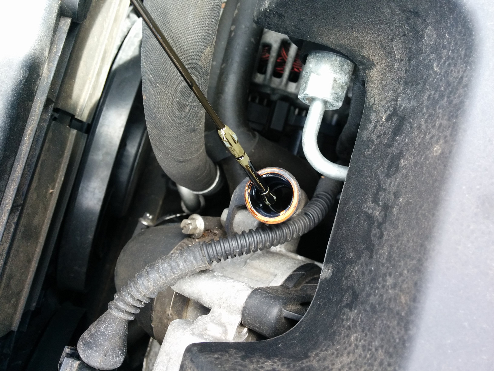

I went to look at an Octavia Scout (2011, 2.0 TDI 140bhp) this morning. Car looked generally good, but I put a fault code reader on it and it gave me a PO403 error, "EGR flow circuit malfunction". The seller seemed surprised by this, but his wife had seen a warning light come up and had had a quote to fix it. Anyway! The car drove as normal (as far as I could tell), and had no warning lights on the dash currently. Both the seller and I started googling EGR problems on Octavias, and it seems to be common and potentially expensive. Some posts on here suggest a cost of between £500 and £1600 to replace, because the valve is a bugger to get to. One post quoted the cost of the valve alone as £700 from Skoda. Seller's local garage quoted £550 odd. There's also the option of deleting the EGR - but I'm not sure if that would lead to MOT failure, increased emissions, ECU problems if not remapped etc.
The seller also said the car had been serviced in March of this year, but couldn't find the paperwork. I will ring the garage in question tomorrow and check. However, I looked at the oil, and it was black and gunky. (See pics attached) I've not had a diesel car before, but if the oil was changed in March (and the car has only done a few thousand miles since) shouldn't the oil still be reasonably golden and clean, not black and bitty? I could be wrong about this, perhaps the oil on a diesel may go black more quickly than a petrol? I guess diesel combustion by products are blacker than petrol... Service indicator on the car said a service was due in 15600 miles if I remember right. (It might be that the garage have claimed to have changed the oil, but actually haven't of course)
Anyway, what's the best option if there's an EGR problem? Walk away? Clean the EGR with Wynns or similar and see if the fault comes back? (Which it probably would) Bypass the EGR? Get it replaced by the seller or myself (with an appropriate discount on sale price - and what would an appropriate discount be? I'll ask my garage for a price to replace tomorrow, but an idea from the forum would be useful)
Given the EGR problem, the state of the oil and missing history I'm slightly inclined to walk away (at least until I talk to the garage that should have done the work), but Scouts are fairly few and far between... And this one is quite low mileage, reasonably modern and a nice drive. Discuss?

Fresh oil will go black almost instantly in a diesel.
Right, thanks. Different to petrols then!

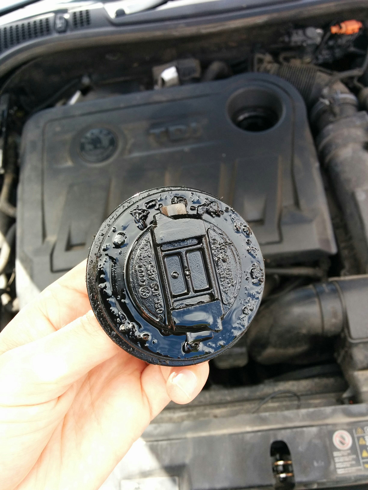

That oil filler cap looks a bit odd....whats with the lumps on the seal,with that & the possible big expensive of the egr valve/cooler replacement & the lack of service history i personally would walk away from this one.

Agreed about the lumps of swarf (or whatever) on the oil cap though. And the egr problem. Hmm.
I can also confirm to you that fresh oil turns all black after only running the engine for like 1 min after the oil change... so no worries there.
As for the lumps on the cap - they all seem to be on the outer edge of the cap, where the valve cover meets the cap. This can be caused by dirt & oil rubbing between the cap and the valve cover? I must say though, mine doesn't look like that.

As others have said, the oil colour is normal. The crud around the edge makes it look like there may have been excessive muck around the cap that may have fouled the seal when the cap was last removed.

Thanks Langers. Hopefully it's just dirt from the engine bay, not bits from the engine!

The debris on the oil cap is normal, it was a regular occurrence on my vRS, Scout and current Superb, a quick wipe with a rag soon gets rid of it but it would always return. I'm pretty sure it is debris that collects around the cap that falls onto the seat of the filler hole when the cap is removed. I've seen dead flies and grit etc.

I cleaned the debris off the oil cap, and it doesn't seem to have come back, so I think it is mud etc. settling in the cap area. My scout does seem to be fairly muddy in the engine bay.

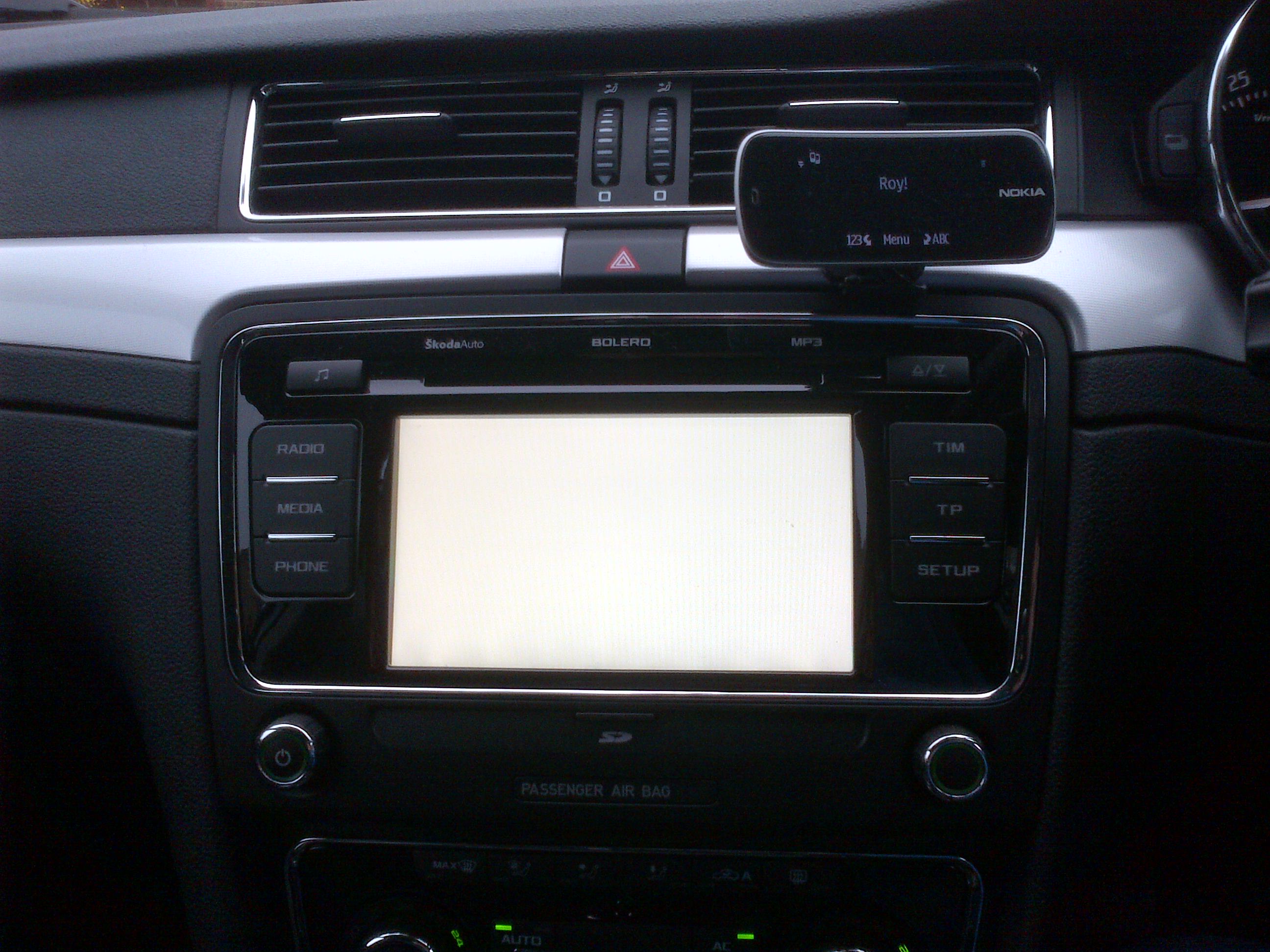

Is the radio a Bolero, Amundsen or Columbus? If it's the Bolero do you get an all-white screen at the same time as no sound?

The radio is a Bolero. The screen stays on, displays and responds as normal, just no sound from the speakers...
The Bolero seemed to have a bad time during 2011, there are quite a few issues reported, mine was the white screen but fortunately it was picked up whilst the car was still under warranty...
Bugger. Mine hasn't white screened yet, so hopefully it's not too bad. Also mine seems to have the Skoda logo on the startup screen, so it may have been updated.
