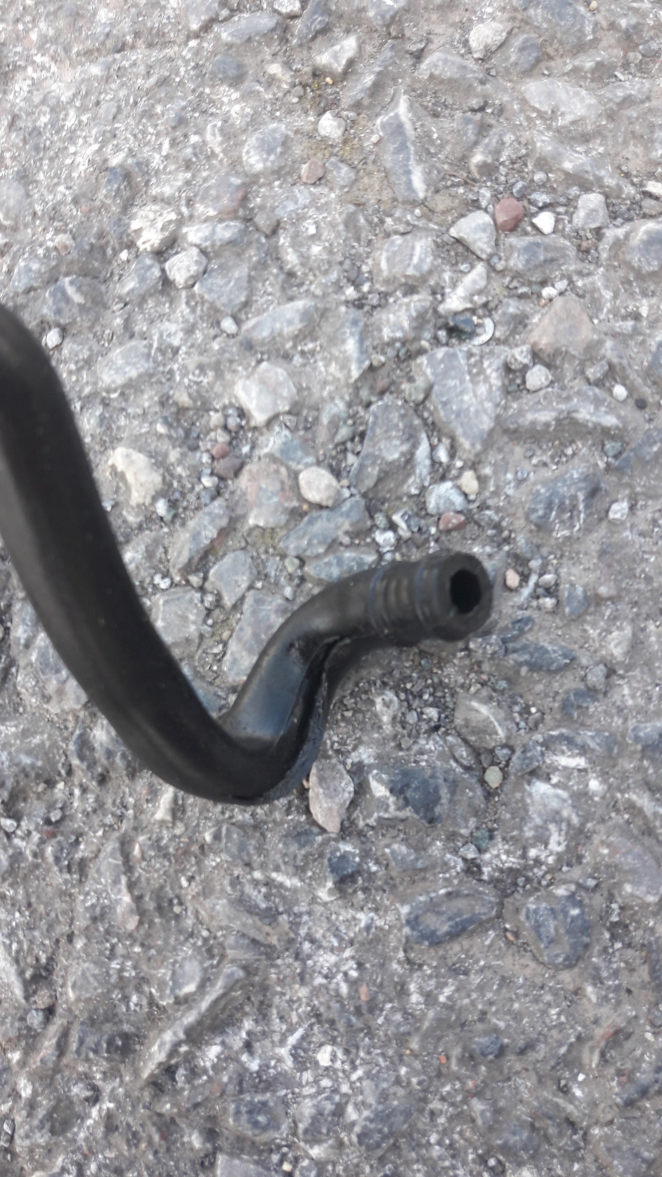

Hi folks. Was driving car a couple of weeks ago and the throttle kept cutting out. A week or so before that I changed the throttle body gasket and cleaned it out. I managed to catch it before it died in could keep it going and the throttle would return. Looked under bonnet and car had 2 problems.
1. Coil no1 wasn't pushed in properly.
2. Have a massive hole in vacuum y pipe.

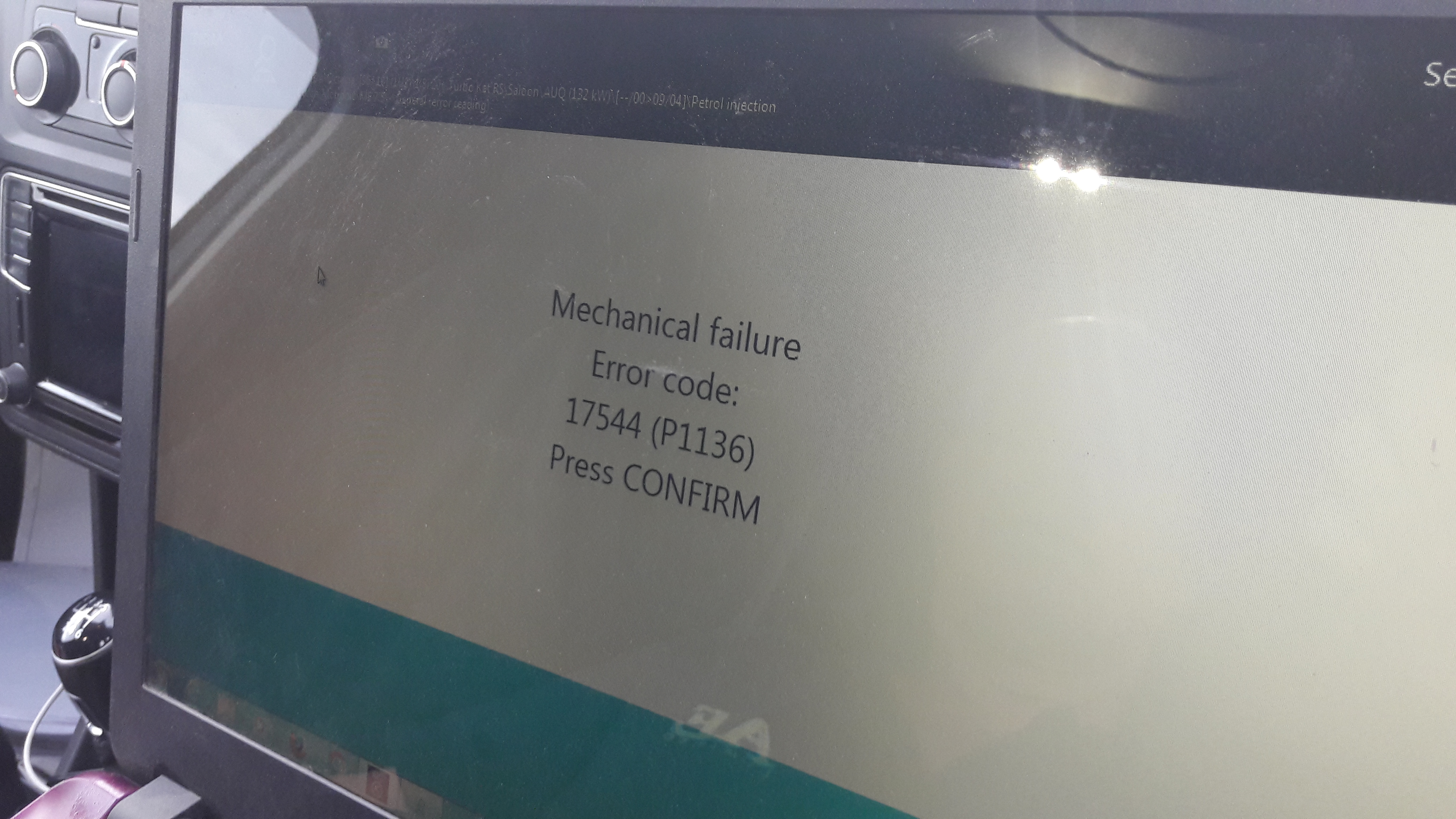

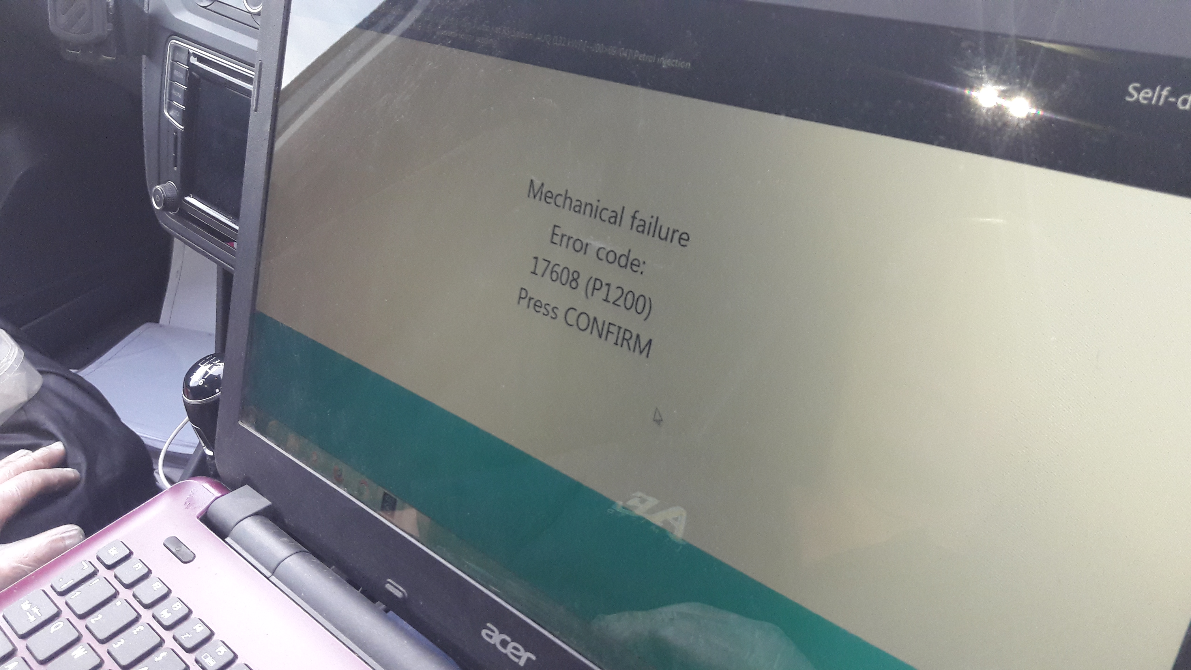

Recently car drove sweet till today. Sitting at lights and the revs died. Took a good few cranks to start her back up but when I was cranking it, there seemed to be a lack or juice from battery. Could be a possible fault however once started it drove along sweet again. Got home turned her off and a minute or so later started her back up no problems. Getting really browned off with the car. Spent a fortune on her with suspension exhaust bushes etc and tbh I'm getting really disheartened with her. Anyone have anything similar and or a reason or theory as to why and how to fix it. I've attached 2 codes that were read a couple of weeks ago by a auto spark while he was in my workplace.

http://wiki.ross-tech.com/wiki/index.php/17544/P1136/004406
The p1200 code relates to your n249 valve, which will most likely go away when you resolve your vacuum leaks. Do the Y-pipe, clear the codes and you should be golden
I hope so. I'm assuming with the vacuum pipe being Pete tong that it would cause the car to hesitate on the accelerator and possibly cut out. I've lost alot of boost as well.
Yeah it will throw it in limp mode, screw all your MAF readings and generally cause the engine to behave like a bratty child

Anyway a small update. Replaced the y piece hose with a part from skoda. A genuine part through my work as they are a skoda dealer. and so far the car ain't cut out. However the boost is still not there. It pulls but not great. What is the best way to test all boost pipes or test the intercooler. Will try and get codes read again in the mean time and clear all faults.

Just a small update. Ordered a new pcv system and still waiting on it to be delivered. Got it from main dealer through my work who own a skoda dealership. Parks motor group is who I work for. Was looking around for other boost leaks while I was in engine bay and found a hole in the hose at top of diverter valve. So did a bit of botching to the pipe and cut off the part that was knackered and refitted the pipe. Bit of a stretch though but just enough to refit. Will replace that soon too. Cleared all vault codes and car goes like a bullet again. Still changing pcv system as it definitely has a leak. Oil residue over inlet and engine covers and still can hear a slight leak from the inlet area. But fibally getting there with the car. Will do a write up when I do pcv system hopefully soon.

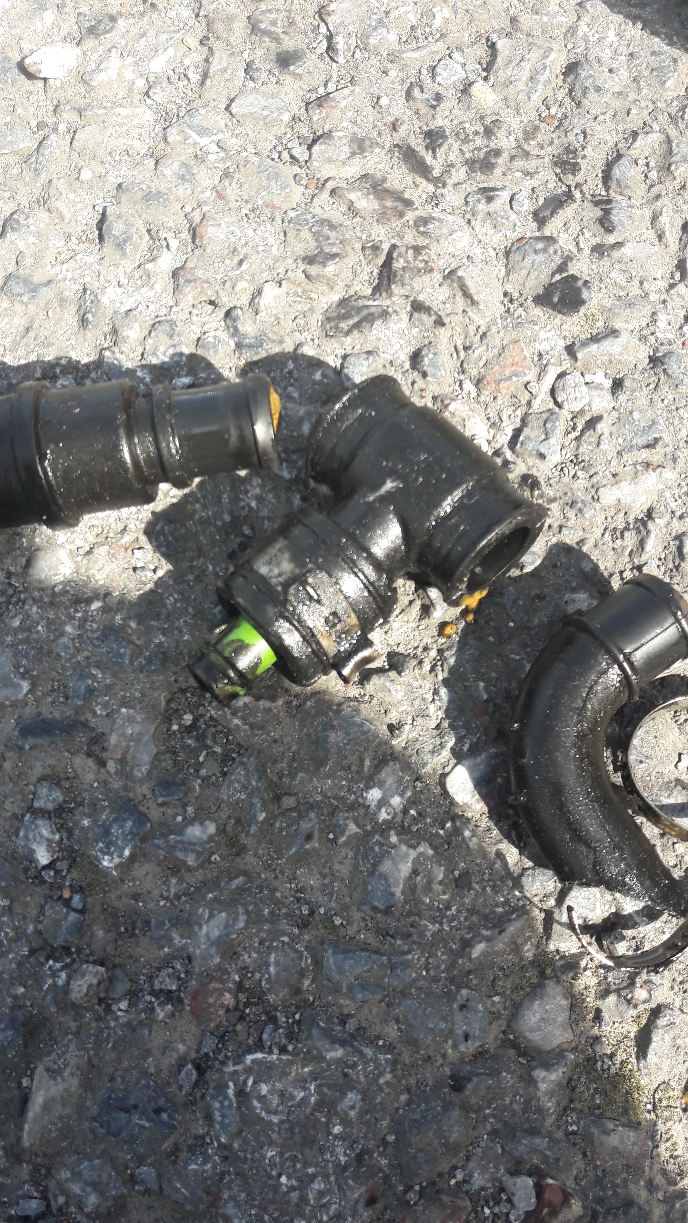

Another update. Took car to torquay today and it broke down. Had to get it recovered. The hoses perished and crumbled in my hand. Anyway need to order the pipe directly under the inlet manifold that connects to the t piece. Anyone got any idea what the part number is or where I can get it.
Cheers
That will be either hose 9A or 10 in the link I posted earlier in the thread, depending on which bit of the t piece your hose has self destructed on. the part number is to the right of the illustration number in the list of written descriptions.
Yeah kentphil1 it's the s shaped hose number 9 hose from the crankcase breather to the t piece that destroyed itself. Car won't start at all and I'm assuming that with the hoses being buggered this will do this. I'm still waiting on the new pcv system being delivered from my work. Hopefully be doing it on Thursday on my day off. Sick of walking to and from work. Lol. Tbh was considering even doing the pcv delete and putting in a catch can but even after reading the how to guides I'm not confident at all.

Right guys replaced the pcv system. All hoses including check value and hockey puck. However car still won't start. It has definitely got compression, ignition spark, charged up battery and fuel etc. I also just changed the 409 fuse tonight and nothing.  When I got mechanic at work to test electrical connections he said there was no power going to the pump. And when i browsed internet something about the 447 relay was mentioned when someone spoke of a 1.9tdi cutting out. Has anyone got any ideas. Also where are the fuse boxes on the car. I know of the one on the drivers side and the one at the battery. Is there any other one. Thanks in advance guys. I'm at my wits end with this bloody car tbh. Oh and here is a couple of pics of the pcv install.
