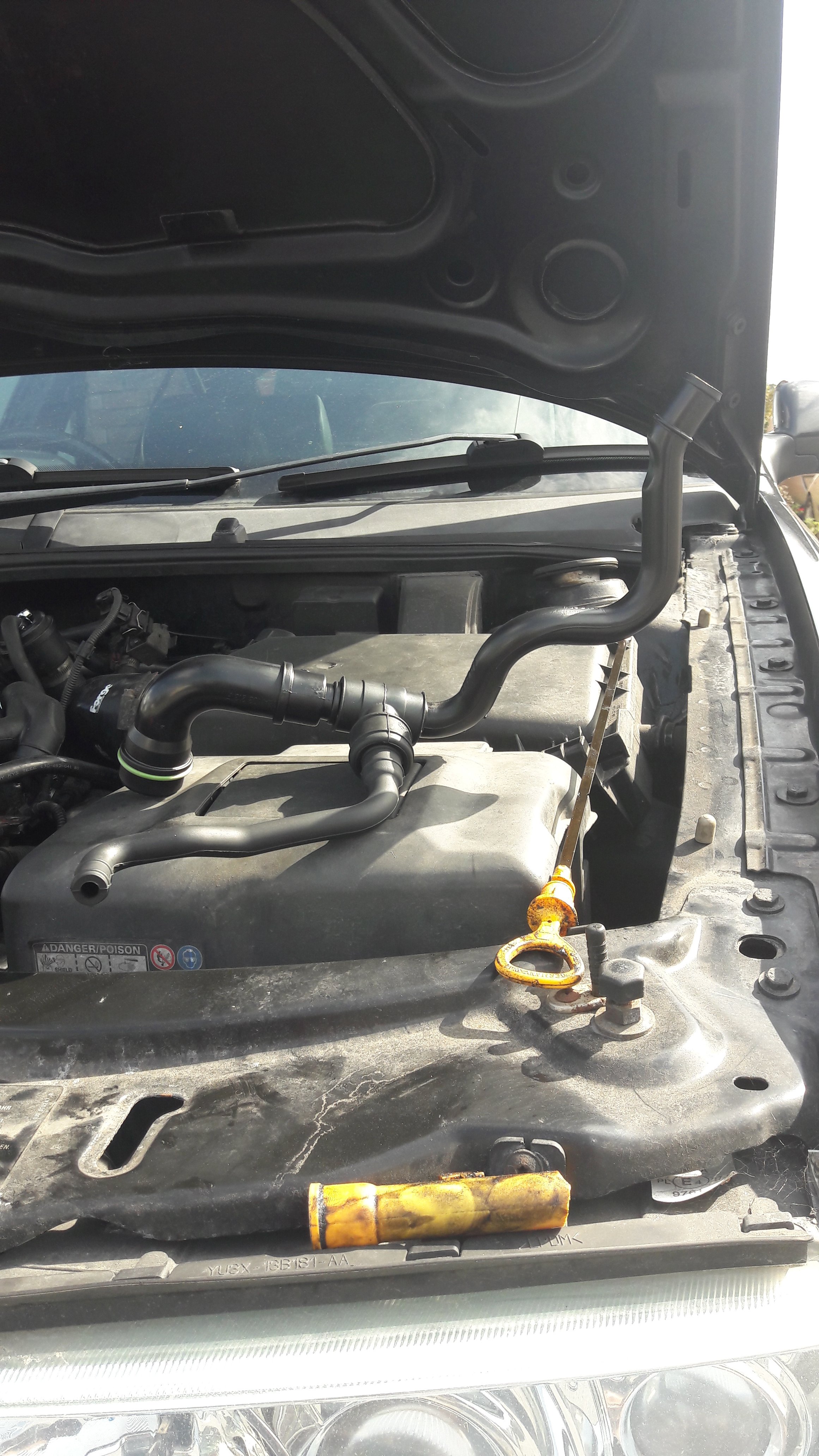

Sorry for the lack of installation pictures I was too busy swearing as I have huge hands and it was such a tight space to manoeuvre my hands.
