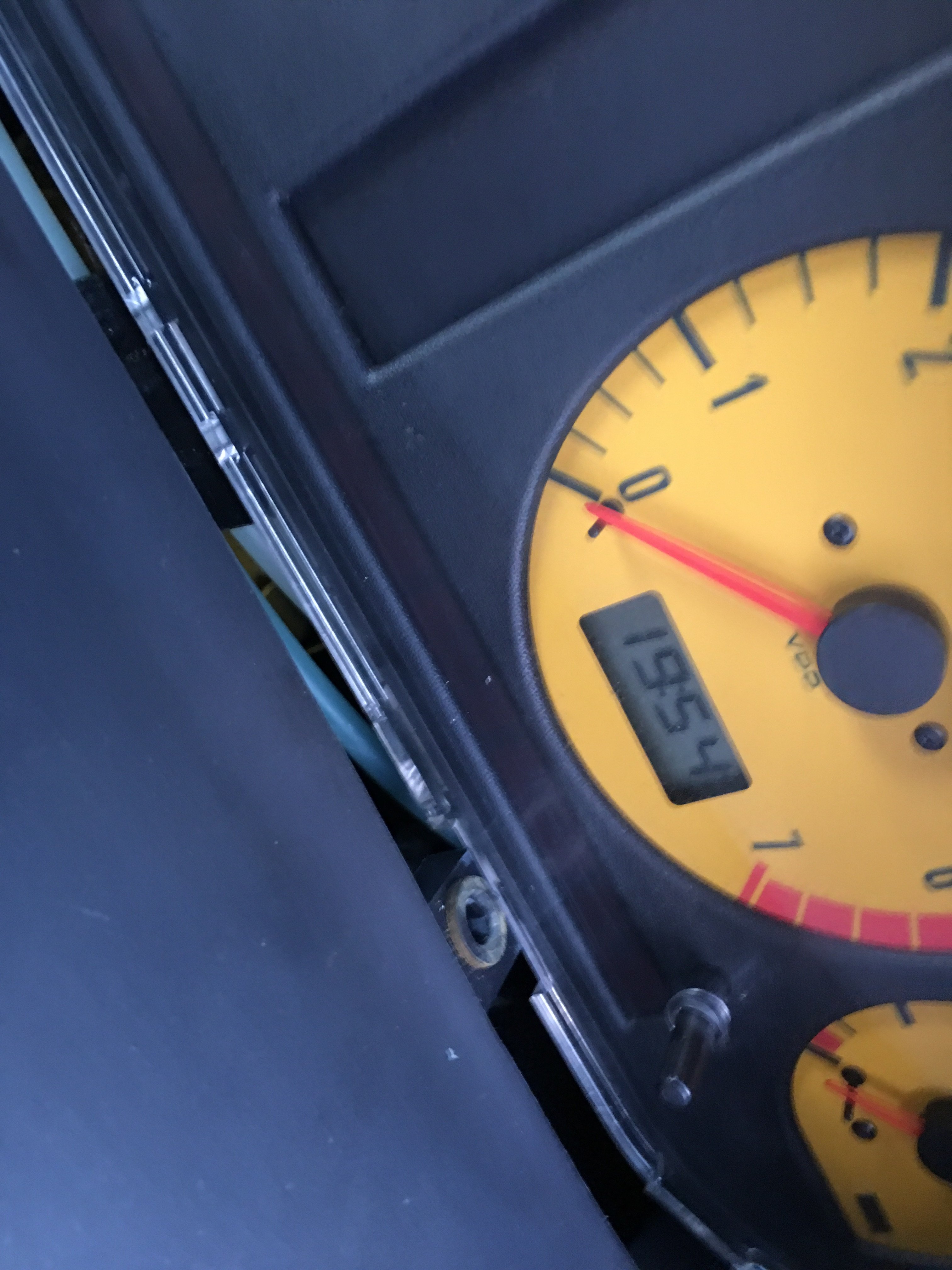

been driving my skoda and suddenly the millage clock sometimes stops and starts working but the speedo works fine, justwondering if anyone knows what this could be.
The "millage clock" (also known as mileage counter or odometer) stops working randomly due to a sprocket that slipped sideways.
Thanks do you know how I can get to this and fix it
Thanks fixed that issu now having a pain in the back side trying to close the dash up with the speedo cable attached any tips or tricks just can't pull the clocks out enough to click it into the housing
Do it from the other end.......unscrew the cable from the gearbox (make sure the gear doesn't drop off the end) pull clocks out, push the cable into the clocks, refit everything and the reconnect the cable to the gearbox. Access to the cable on the gearbox is dead easy too.
Sounds like a big faff, but isn't really and does save a lot of time, swearing, nicks to your hands etc etc.

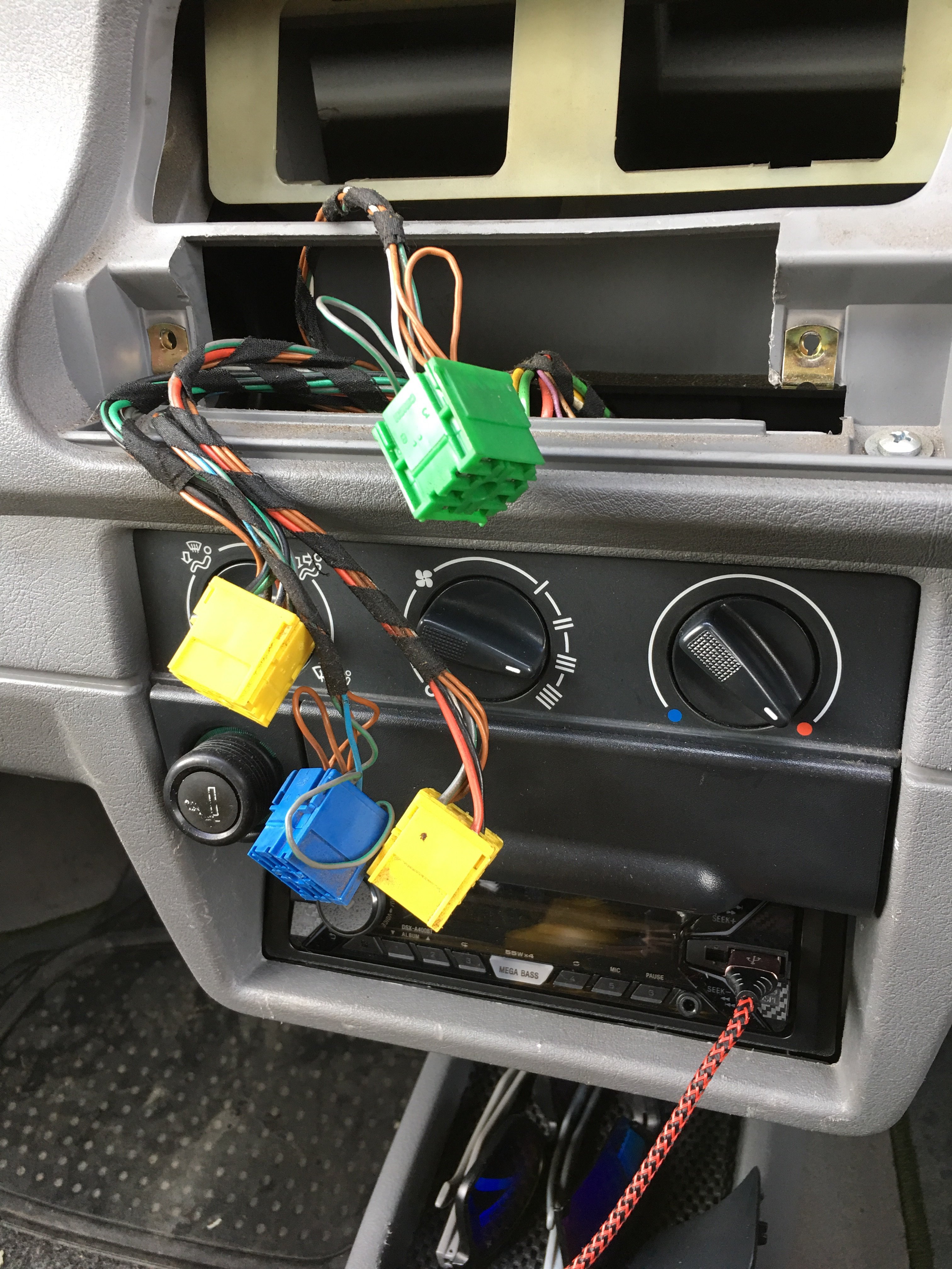

Anyone know wat this mysterious green connected is thanks
It is the rear window heater connector for hatchback Felicia.
If you end up with a Truckman top, you'll find that they mist up quite nicely in winter, and take ages to clear. I had plans to install a fan heater in the back, and connect it to this switch (switches are quite cheap), so you'd be able to clear the rear by pushing a proper rear window clearing switch. ;)
If I recall, the connector is part of the connection block down behind the passenger kick panel. There's the connectors for the rear speakers in there too. I installed a pair into the removable panels in the sides in the loadspace (the ones at the back)......worked quite well with the hard-top on. ;)
