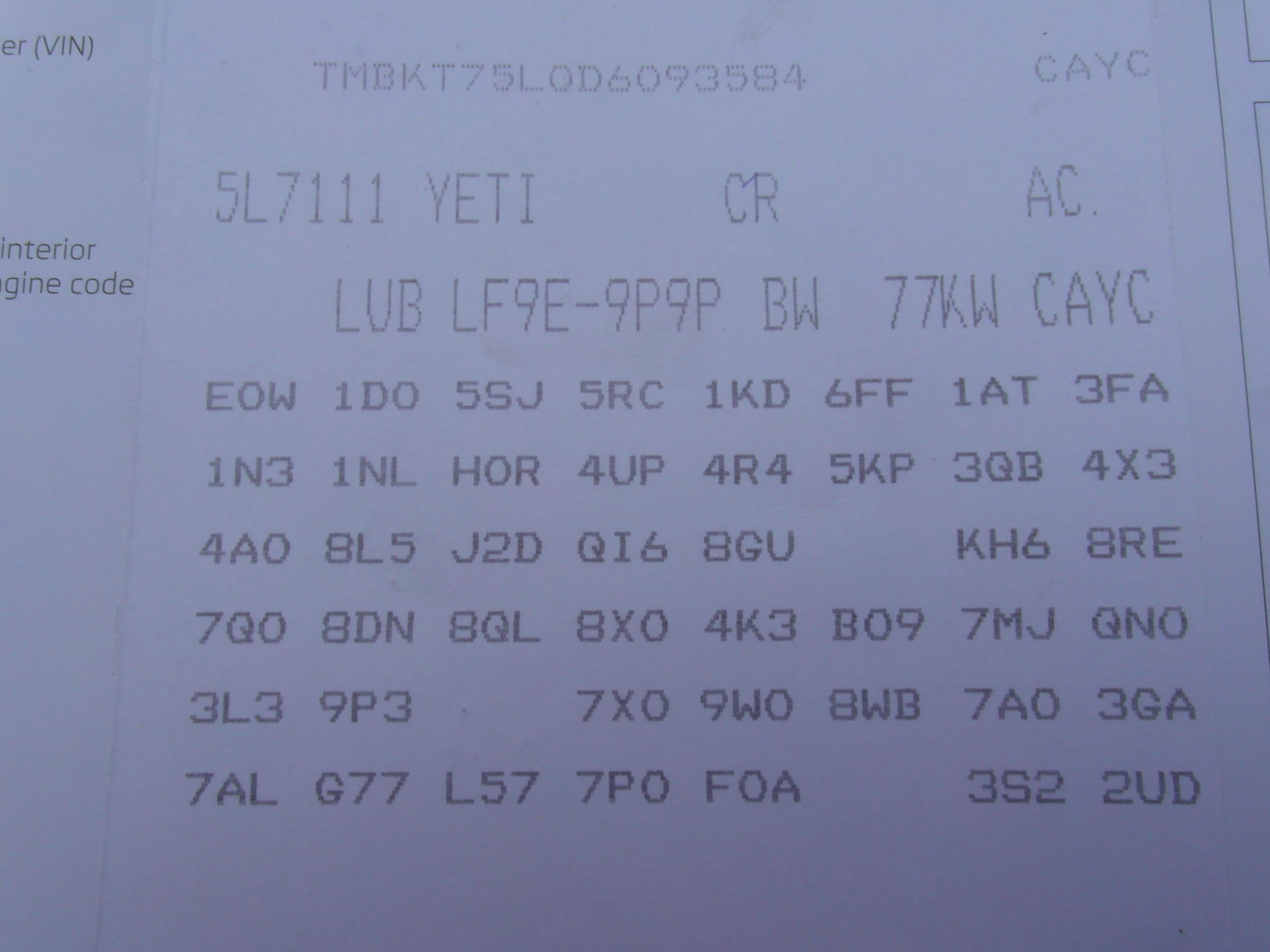

Can you stick up a photo of your options sticker (usually found on boot floor and in service book), obscuring the VIN if you want? Or just look through all the codes looking for ones that start 1Z, and 1K. If you're lucky, you'll find one of each, then you can look up what's what somewhere like this (scroll down to bottom of page).

Wino, thanks mate for the link, it's very informative. I think i've found rear disc size, using label in my service book but I can't get any info regarding fronts. I can only see the 1KD.....
Will try to upload a pic now.
Mally.
P.S. my vin number isn't recognised using the checker, (it maybe that my car doesn't have front brakes)
Me too.

Yeah, that doesn't surprise me unfortunately.  For some reason VAG don't feel front brakes is an important enough item to put on the data sticker, I wasn't sure if this was across the board, looks like it may be.
You can get a full 'car data' pdf or print-out if you are on good terms with your parts department at the dealership, or you can pay 7 Euros + vat and get it via erWin, but it may be easier just to measure one front disk.  The full car data has about 6 times as many PR codes as the data sticker, and will include front brake code.
I wouldn't expect any help from putting a VIN into the site I linked, it's not a genuine VW group site, so won't be linked up to the necessary database, I shouldn't think.

Front 288X22MM PART NUMBER 1K0615301AK and 1K0615301AS or Economy JZW615301A
PR-1KD Rear 253x10mm 1K0615601AB
