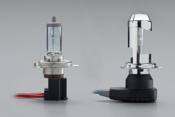

There are two types of HID kit that can be fitted to a H4 headlamp.
The chavs usually fit the cheap, non shielded version, which does cause glare and the undefined beam pattern in the pic way back at the top of the thread. Illegal and dangerous.
The reason is that a H4 filament bulb has a shielding cap moulded into the glass at the tip. Therefore, all the light is reflected back onto the reflector, thus providing an accurate beam.
The chavvy HIDs do not have the cap, so light can project forward as well as onto the reflector, hence the glare.
The other type uses exactly the same burner but has a shield covering the end of the burner and also the top, when fitted into the headlight. The shield has cutouts on the bottom side, which provides an accurate beam for dip and high beam.
I have the shielded kit fitted to my bike and the beam pattern on dip and main beam is identical to the halogen OE bulb.
Left is a conventional H4 bulb    Right is a HID H4 with shield.
