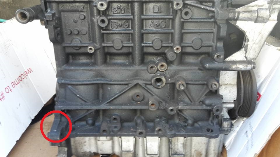

Check in the front of the engine block on same location as marked here on the rear side

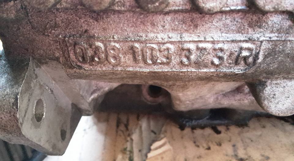

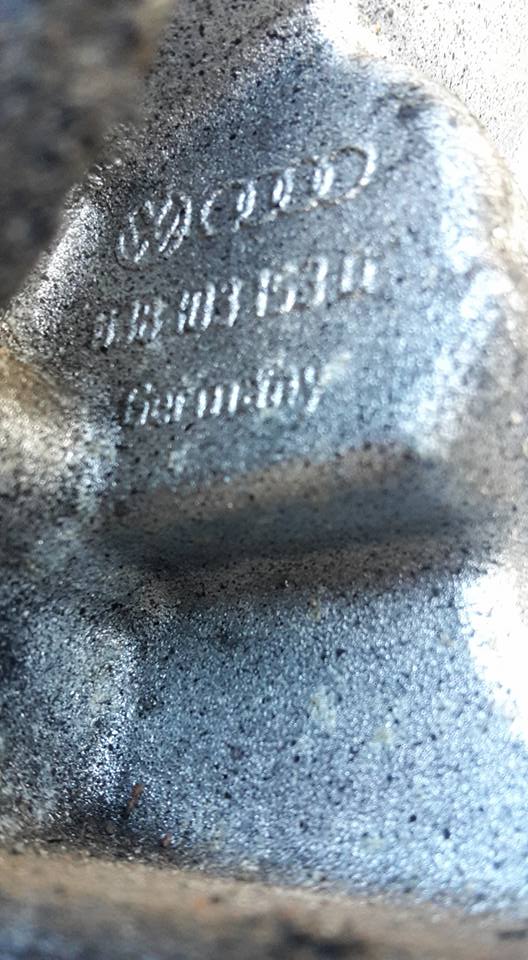

or here according manuals
There is engine code together with engine serial number only stamped in, therefore it is usually corroded out and hardly seen
