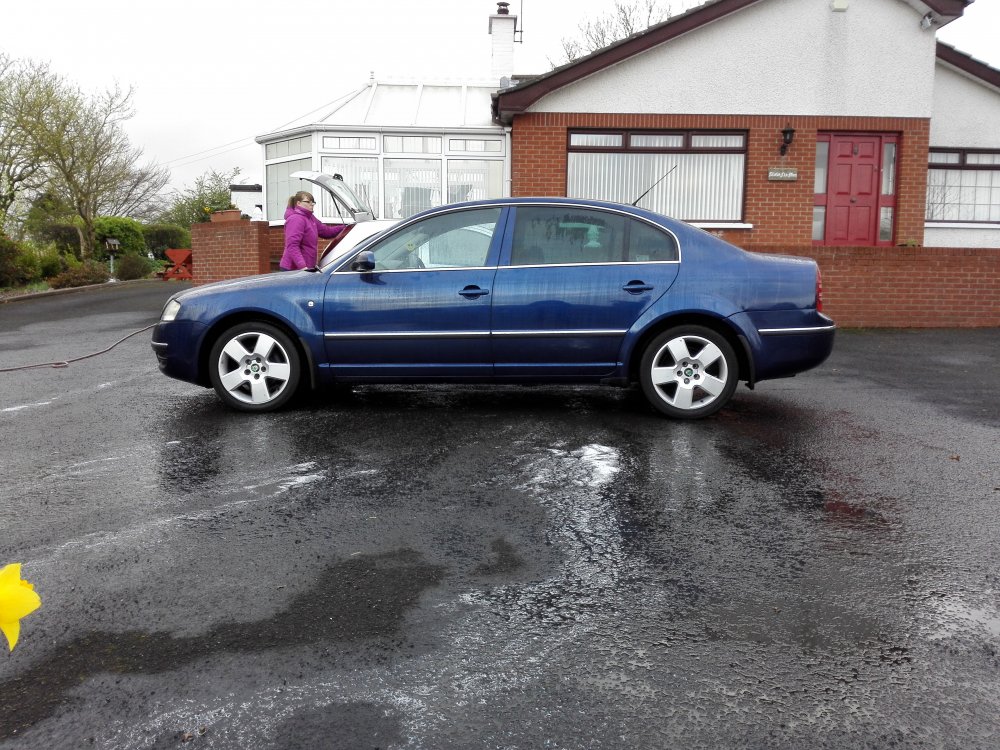

Hey folks I'm new to the forum I picked up my superb about 3 months ago plans are to get it dropped on air suspension out of my old Passat , anyone else on air? Thanks
