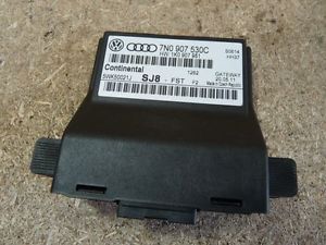

Not sure where the CAN gateway is located in a LHD Yeti. It might be in the drivers footwell above the pedals but I can't be sure. It'll look something like this, it'll probably have a red connector:
no its a uk origin car, so rhd
Could be in the same place, might be behind the glovebox.

what are the approx. dimensions of the canbus box so I know what to look for?
ok now found the box, it is behind the glove box, code on it is
7NO  907  530  AK   with a blue plug, the obd is pinkie coloured
for langers2k  -  what next?, I presume the cables(colours) on the box are the same as the obd socket?
