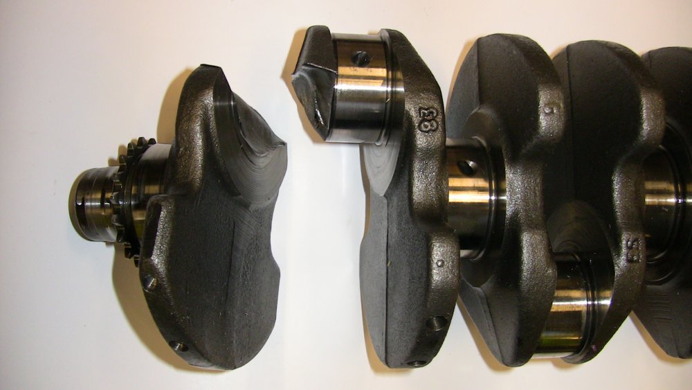

The 2.0CR engines have massive issues after DMF to SMF conversion showing there is a very real practical need for them.

There is a big issue! Other issues there may be but this is a BIG problem - SMF flywheels are not prone to these huge mechanical issues....
