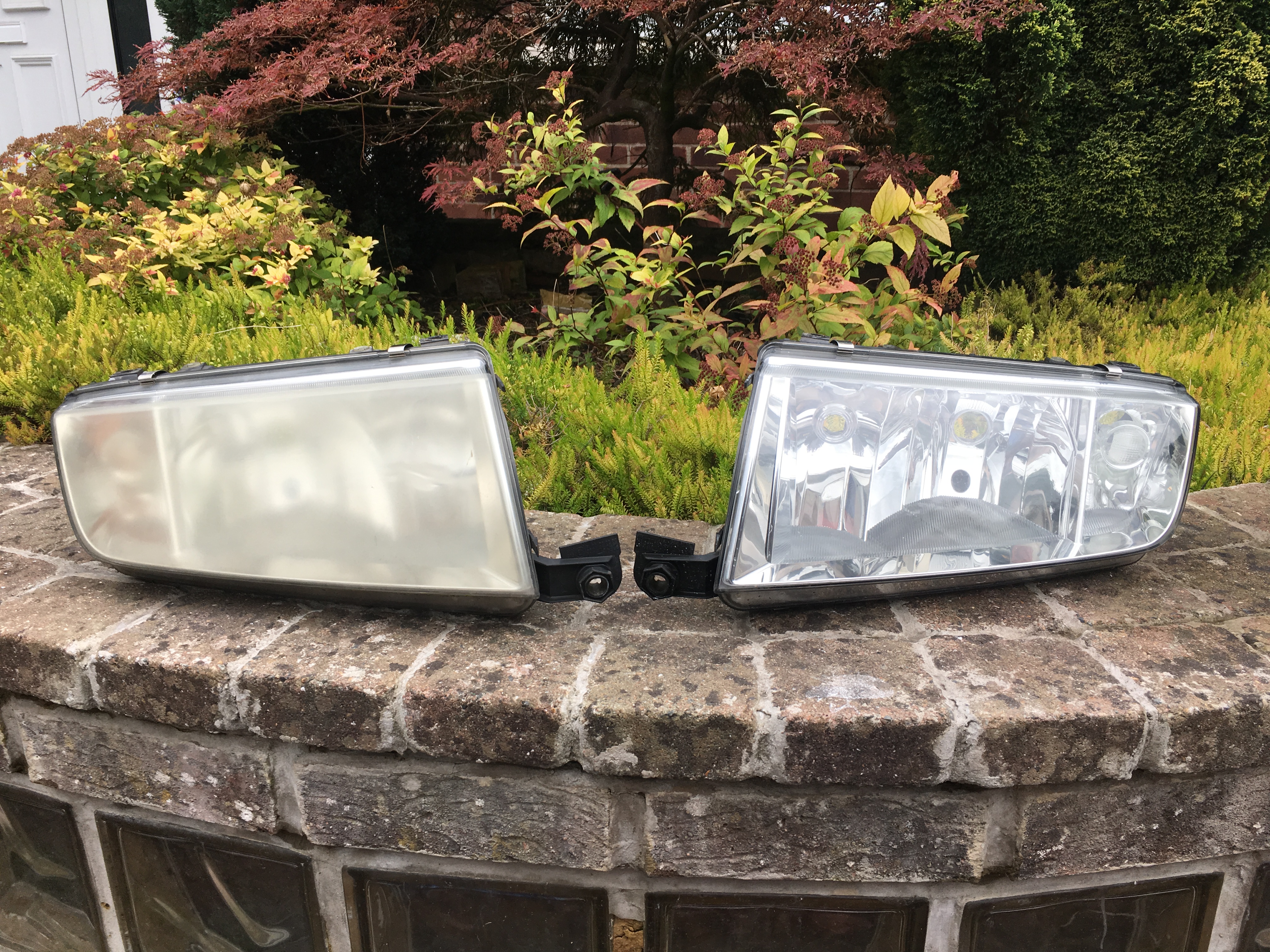

Headlights on my fabia have always been a bit oxidised. Bought a kit from Halfords (a maguire one that doesn't need the drill), and it does make an obvious difference, they never look "new".
there appears to be some clouding on the insides of the lenses, although I think the worst of it is on the outside.
Is there any better way of polishing up the lights, maybe a kit that requires a drill? I'm guessing taking the lights apart is nigh on impossible. If not, any idea where to buy cheapest new lights from?
You've got to be careful with the heat from using a drill otherwise the polycarbonate melts and smears and you'll never polish it out.
I just used really fine wet and dry with lots of soapy water to get the oxidised layer stripped right off before polishing with finer compounds. Easier to remove the headlights and work on them in your lap.
I did an old set I got from the scrap yard and they came out like new with a wet sand and a machine polish with a few different compounds.
And yes you can take the lights apart to clean but probably not necessary as most will be on the outside surface

Not tried toothpaste, but have heard that one before. I have used T-cut, which did have positive results, but with the right care wet, sanding and machine polishing trumps everything else I've given a whirl.
