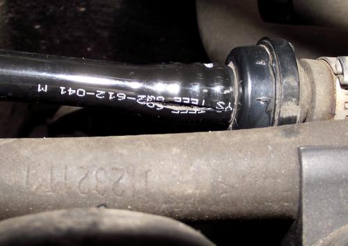

Check your brake servo vacuum hose.
OK. Will do. You are suggesting unmetered intake air leak?

Interesting but relevant? Doesn't look big enough to let in much air although enough to reduce servo vacuum. Rest of hoses are good. (Explains why the normally very fierce brakes are a little more controllable). I will seal temporarily and have a drive.

I cleaned throttlebody and EGR pipe and replaced gaskets. Did TB and on the second EGR valve adaptation, both successfully. Found the split in the hard portion of the servo hose this morning and temporarily sealed it. So I cleared the code and it's taken 15 miles of town driving for the codes to return. Same again; Idle rough as rats. Almost stalling.
