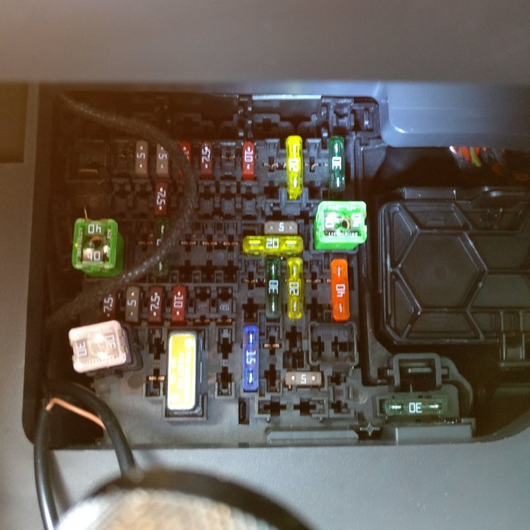

the usb port is no longer charging my phone either and check the box, there appears to be no fuse in the slot!??!?! slot 9 from the manual

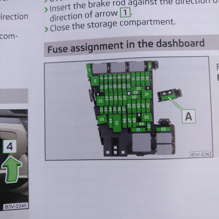

can anyone do a "spot the difference" between theirs and mine if they have a pic handy? pics attached

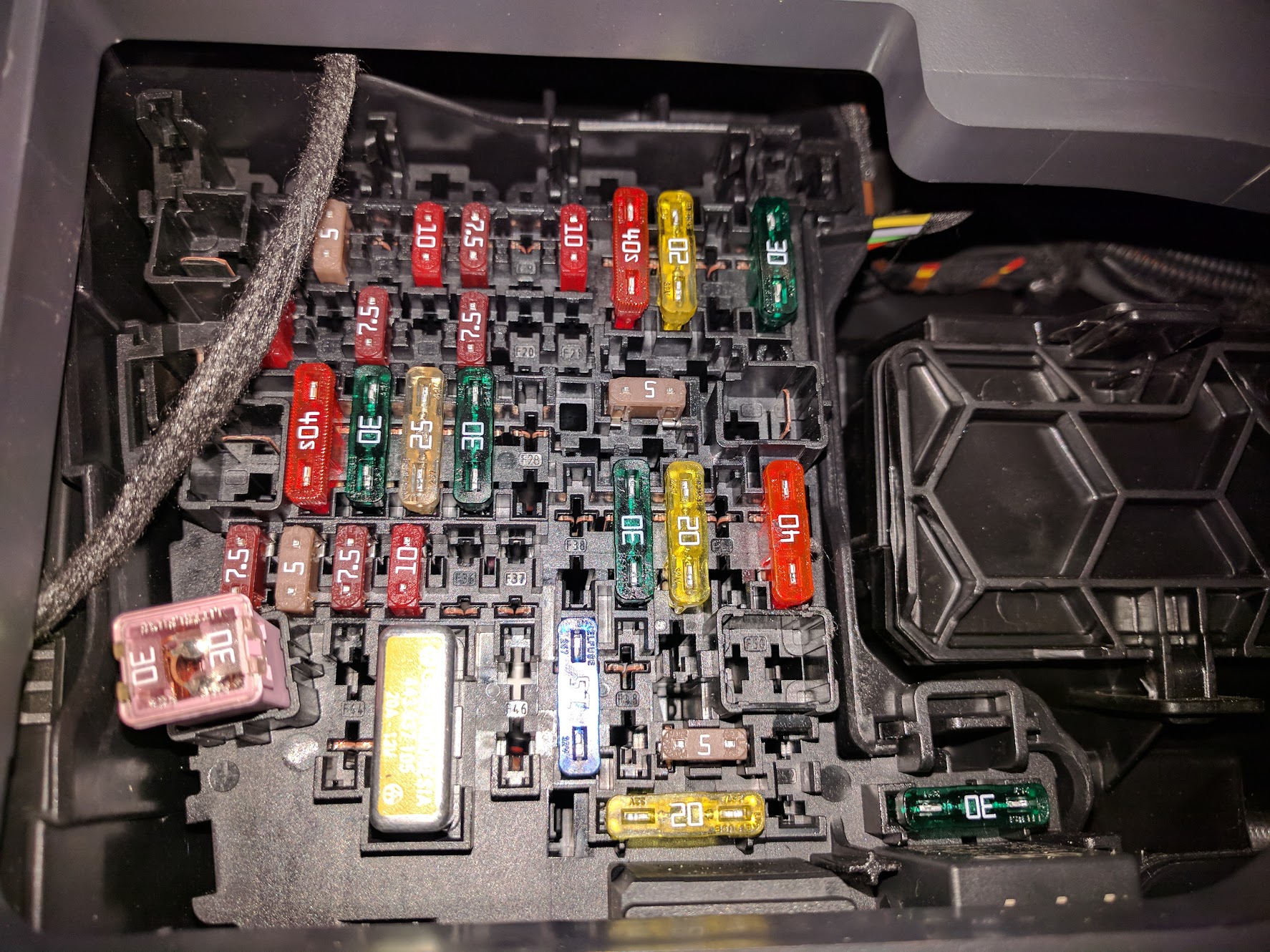

Heres a photo from my SE technology (2018 spec).   Looks quite a bit different to yours?
Yours looks like it has panoramic sun roof, amp and heated seats. Posh git! Well jel.... Trying to see the others missing on mine but usb isn't on your either... Unless the manual is out dated?
