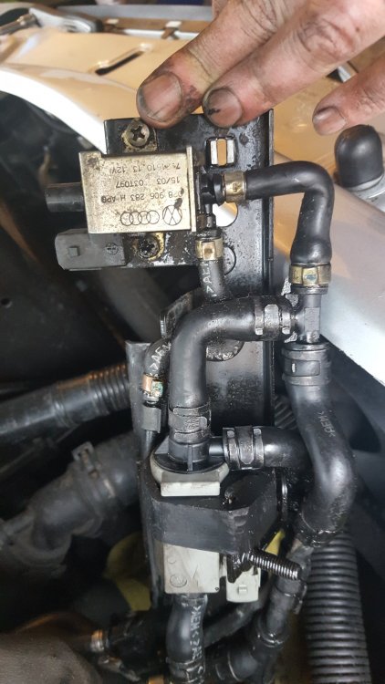

N75 - boost leak/ maf HELP PLEASE
Skoda 53 plate 150,000 miles full service history and look after.  About 12 months ago ECU light came on and was scanned by local specialist advised incorrect flow detected secondary air system.  I know the pump needs removing and bolted together again but ain't got round to it yet.  But I have lost all power from the turbo.  Used to get a nice sound and a kick in the back when I put my foot down now nothing at all, runs like normal 1.8 petrol motor.  Changed the hockey puck and diverter valve  oem stock parts from TPS. Carried out a new PCV valve under manifold as it was caked in dirt and oil.  This made the car run much better and less oil loss due to reduced crank case pressure.  The crank case pressure is still quite hight again and the performance is down.
 I have a very limited funds but would like to get the car back to normal performance with the turbo working. Be really grateful for some advise or anyone near Northamptonshire who could help even locate the problem in exchange for a few beers.  Perhaps offer to scan the car and clear the code logged etc..Happy to get my hands dirty and learn but need some guidenace of where to go next.
Some of the parts replaced !! Together with valve locations under the metal plate adjacent to the manifold.  Wondering if one of these valves might be responsible for no turbo ????anyone ????20170226_132221.thumb.jpg.0909ce08aa570468c3504a2db321c3fe.jpggenuine diverter 20170303_141647.thumb.jpg.92ba0ead214752bd785b6c980f1f8eee.jpgnew pcv valve and elbow joint below the manifold.20170303_141538.thumb.jpg.e8a4b2cdad405707e2137ee87bb62908.jpgpcv valves under metal plate any help idetiyfying these please ! How to test or clean ??20170226_114338.thumb.jpg.56b8900787149487f2ef6528aeac2d9f.jpgnew hockey puk

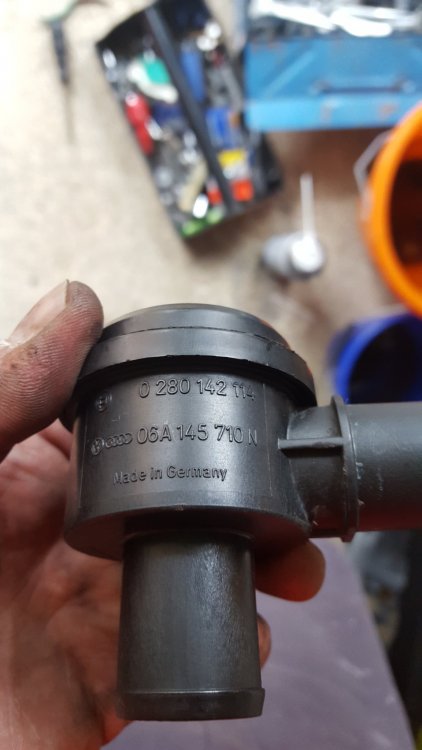

I lost my clip and the plug came out of the N75 valve and I lost all power from the turbo. Could be that or yours is broken
Hi Kennedy
No the clip is still intact and connected so I guess the n75 is knackered but don't really want to replace if I can avoid it.  Can they be cleaned ?? Happy to purchase one but not for £68
quid from local dealer. Does anyone have any other recomendations for oem part !!
Quote
Yes, indeed they can be cleaned :-
Remove N75, and using suitable carb cleaner aerosol with nozzle attached carefully spray into hose spigot, put finger over end and shake, allow liquid to drain away.
Repeat for remaining spigots and allow to dry. I cleaned mine a month ago with nothing coming out. I have a Oil Catch Can fitted so really didnt expect to see any oil contamination,

Thanks for the cleaning tip I will give it a go at the weekend got to be cheaper than a new valve !!!  I guess the same would apply to the valves under the manifold n249 etc.... oil catchcan sounds great but would prefer to keep the car as stock as possible, not keen on modifications happy the way the car was running before the lack of turbo so just hoping to get that back. Thanks for your advice lets hope it works although I think  new valve might be in order with 150 k on the clock.
I understand your reluctance to do any "mods" , but I guarantee you if you take one of the smaller hoses off and look in them they will be partially clogged with sludge.
The standard hose bore diameter is about 6 mm, the blue fluro-lined silicone ones ive fitted for the OCC are 19mm bore. (fitted in Oct 2010, I bought the car in 2006).
As you say with 150k on the clock maybe replace but give it a clean first and see if things improve, also it wouldnt do any harm in checking and cleaning all the other components.

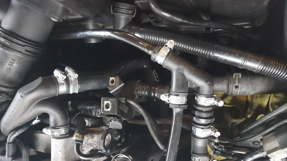

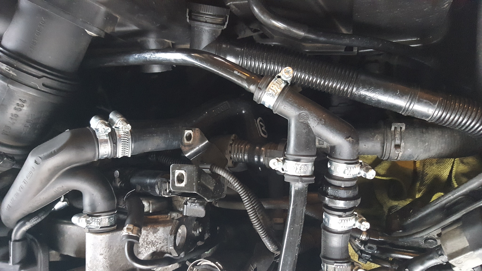

NB:Ref: Kennedys pic, can you see the top hose ( Y shaped, one end comes from cam cover), they tend to split, squeeze it, you mightl find its very soft, consider replacing that one as well with fluro-lined
pipe.

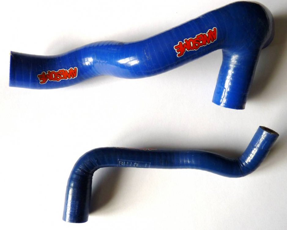

going through all the parts I removed when fitting the OCC I found these 2 hoses I bought from AwesomeGTI years ago. One is the upper hose mentioned in the above reply and the second one (also prone to failure) goes from pcv to underside of inlet manifold, They were only on the car for a couple  of months  Both are silicone fluro lined (Forge ones are £74 for the pair) you can have them for £30 if not they will go back into my filing cabinet. Let me know.
Peter
Edited by Silver Bullet
Thanks for the offer!  I replaced the Y hose (breather) with part from TPS  and bought a silicone one from creation motorsport  for the underside of the manifold with new pcv valve as pictured so all that has been done about 10 months ago replaced a number of hose clips with s steel jubilee ones as the picture shows to ensure no leaks I will check again all the hoses At the weekend and get back to you on this might take you up on your offer.  Have you done the whole PCV delete them without performance issues  !!!!
Hi,
Im glad you have replaced those 2 pipes, to be honest I dont see reason to replace them again if they are made of silicone.

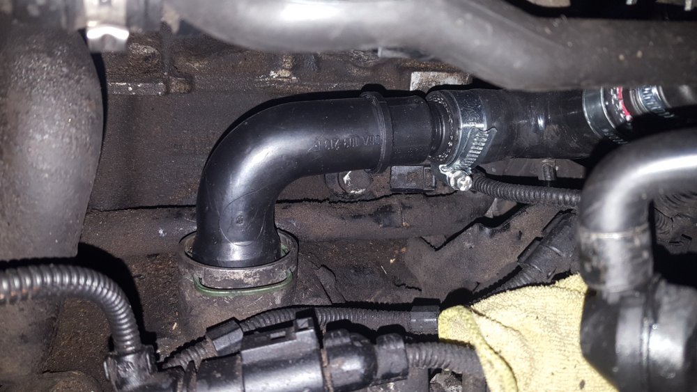

All good advice here,  one thing I would look at if I was you would be the rigid plastic elbow from the crank case breather thingy that your silicone replacement pipe attaches to.   This is how mine looked on an engine that had done just under 130 thou miles when I bought my current vrs.  despite cleaning out the gunk, I ended up replacing it as the ply had gone brittle.

If it was my car (you say you have no boost at all), I would first check every hose (from the turbo outlet through to the throttle body) ensuring all are secured and tight,
On the drivers side at the back of the engine the stainless boost pipe turns at 90deg towards the ground, A rubber hose with a rubbish seal  pushes into the end and
is held in with a clip that locates on 2 barbs to hold it all together. This is covered by a flexable heatshield that clips together (2 pop buttons) This rubber hose can become disconnected,
and you wouldnt know as the h/shield covers it all up.
