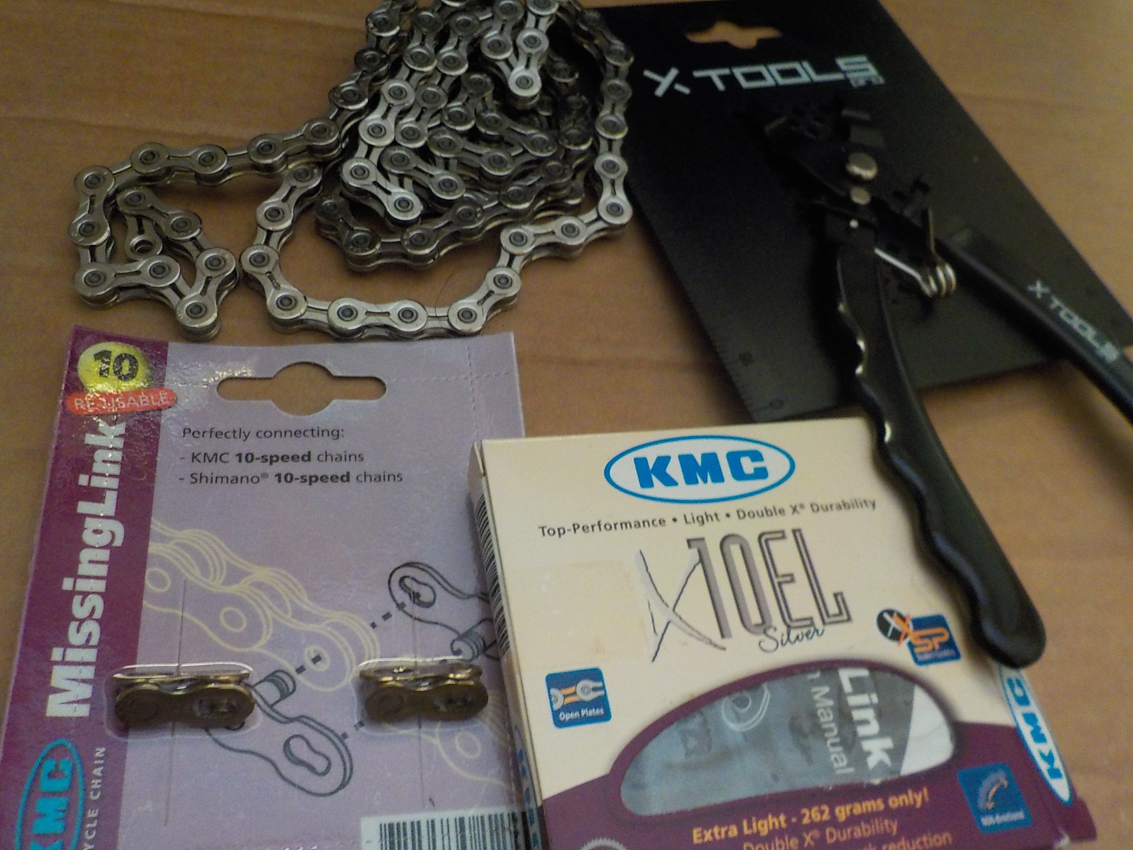

I changed a chain at the weekend, over 1,200 miles on the electric bike, slipping and could no longer use the 10 tooth at the rear. (lasted twice the miles of last chain.)
New chain on but the same as the first 4 gears of the 10-42 tooth rear were gubbed, next 6 never been used.
New Sunrace Cassette Fitted.
So new chain and old chain which were same brand and were exactly the same length,  exactly, just the links were worn out.

The length of the chain is irrelevant. The wear occurs on the pins and the chain gauges measure  the change in distance across a few links between the pins.

New KMc Chain & Sunrace Cassette and worked great did about 60 miles on 2 runs, then used Muc-Off C3 ceramic lube
(free with 5 Mags for £5 along with cleaner and hand cleaner. DD will get cancelled after the 5th mag delivered.)
and it was slipping badly so reset the stops and indexed gears.
OK again.

Well another 10 tooth ring bites the dust at under 250 mile.
That is the 3rd now, so back to it set at 1 x 9 instead of 1 x10 on my Specialised Levo Turbo Hardtail.
Too much torque going through it obviously end just gubs some teeth.
(the recommended Praxis upgrade cassette is over £100 and since i do not need the 10 tooth at the rear not buying one.)

Largish mileage. Ebikes put more torque through the system so wear chains more rapidly. When I was racing mountain bikes, my team leader would fit new chainset and sprockets at the beginning of the season with the cheapest compatible chain. Then replace the chain about every 6 weeks because he avoided wear to  the expensive components and never had to worry about chain failure in a race. Could be an answer to your issues?
Up to 90Nm of torque, and breaking a chain really is not something you want 20 miles from home when you can not walk. I have only one leg.
So i have a spare chain with me and 2 quick links.
