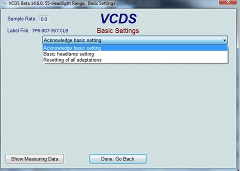

I have done a how to but I can't find it anywhere
go to module 55, on one of the bytes there will be the description "city mode", untick that option then save the new coding.
this will then produce an AFS error on the dash.
still in module 55 go to basic settings, there are 3 basic settings and they must be done in order but you only need to do 2 - this will recalibrate the lights and they will work ok again, it must be done on a level surface.
basic setting first then acknowledge basic setting

Received my OBDEleven this weekend, and I tried to disable this S*** AFS rain mode and city mode. Done in 5 minutes ! Thanks to XPower for his advice on how to Acknowledge basic settings, it stopped the AFS error on my car.
This morning it was raining, AFS is working and follow the curves, even at low speed and in rain.
