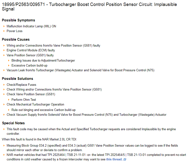

Guessing Turbo actuator. Changed mine around 140,000 as rubber diaphragm inside split. Get it tested for vacuum leaks. The sensor on top maybe picking it up.

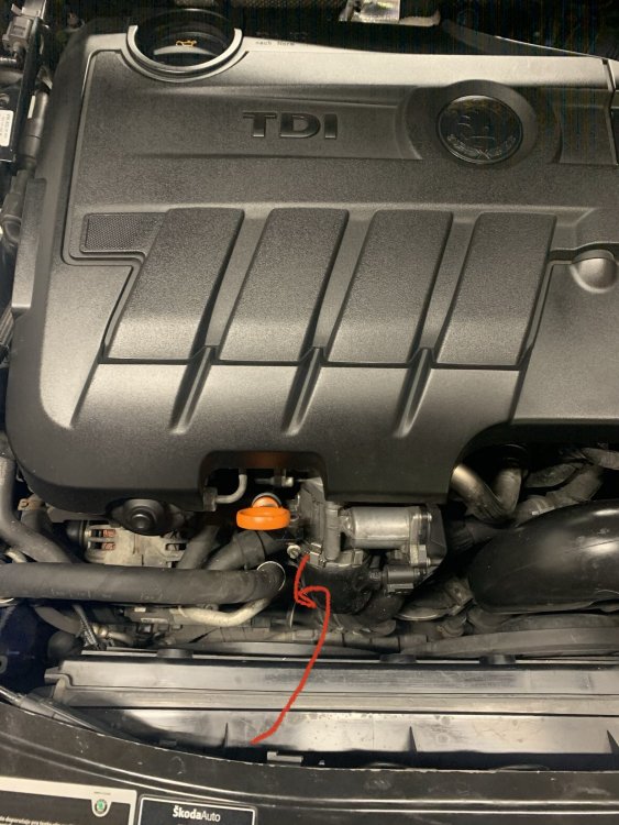

Or maybe the actual boost pressure sensor itself has failed. See below for it's location ...
