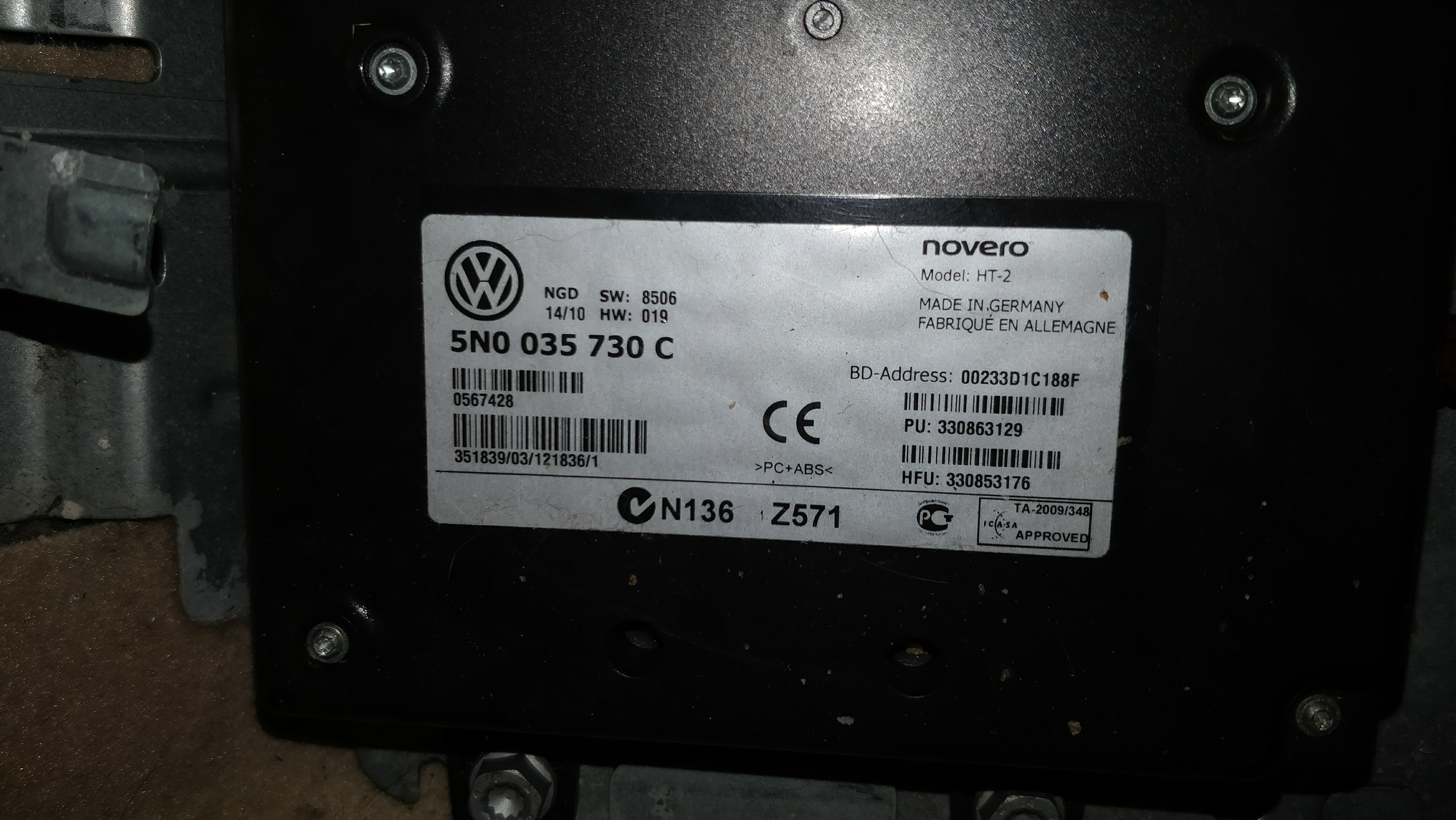

Which BT module have you currently got?
Hi,
Wasn't sure what numbers you needed, so I have attached a pic if the unit.
It won't let me one plus 5 connect at all, and it looks like I would only get phone, as I can't see any Bluetooth audio option in the menus
Thanks
Doing a bit of digging, it seems that my oneplus 5 dosent support rsap.
Do all the skoda bluetooth modules need rsap, or do some later ones support a different connection?

45 minutes ago, Pessimal said:
Hi,
Thanks
Change the Bluetooth module for 5N0 035 730 D and you'll have hands free profile to connect.
Don't buy one of the cheap ones off Ebay from China as they're different functions compared to the EU spec ones, despite being the same part number.
Ebay seems to be devoid of those.
Any suggestions of the best place to get one?
Try 3c8 035 730 a, b, c, d, e. The a is equivalent to the one rustynuts highlighted. d or e are best as they offer premium fuctions with rsap (in case you end up with a phone that supports it). However all work with whats called hfp which is what you need now. If there is no suffix letter its equivalent to what you have now so dont be tempted there!
Are all those just plug and play, or do they need coding in?
May need coding. Anything changed like this may need coding.
As rusty says the module will probably need coding but the physical connections are the same. Also without coding, it may even work for calls and media streaming as the coding options inside the BT module are generally about formatting the phone book and setting up premium functions. Its an easy job anyway. If you are anywhere near South East Wales give me a shout.
