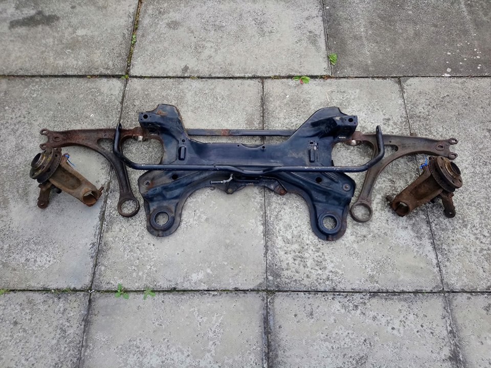

Thanks Davy, currently gathering together mk1 Audi TT parts for some upgrades.
Audi TT subframe, cast lower arms, hub carriers and 23mm R32 anti roll bar. Just need powdercoated and polybushes fitted, not going for the quick steering rack as it apparently screws up the ESP.

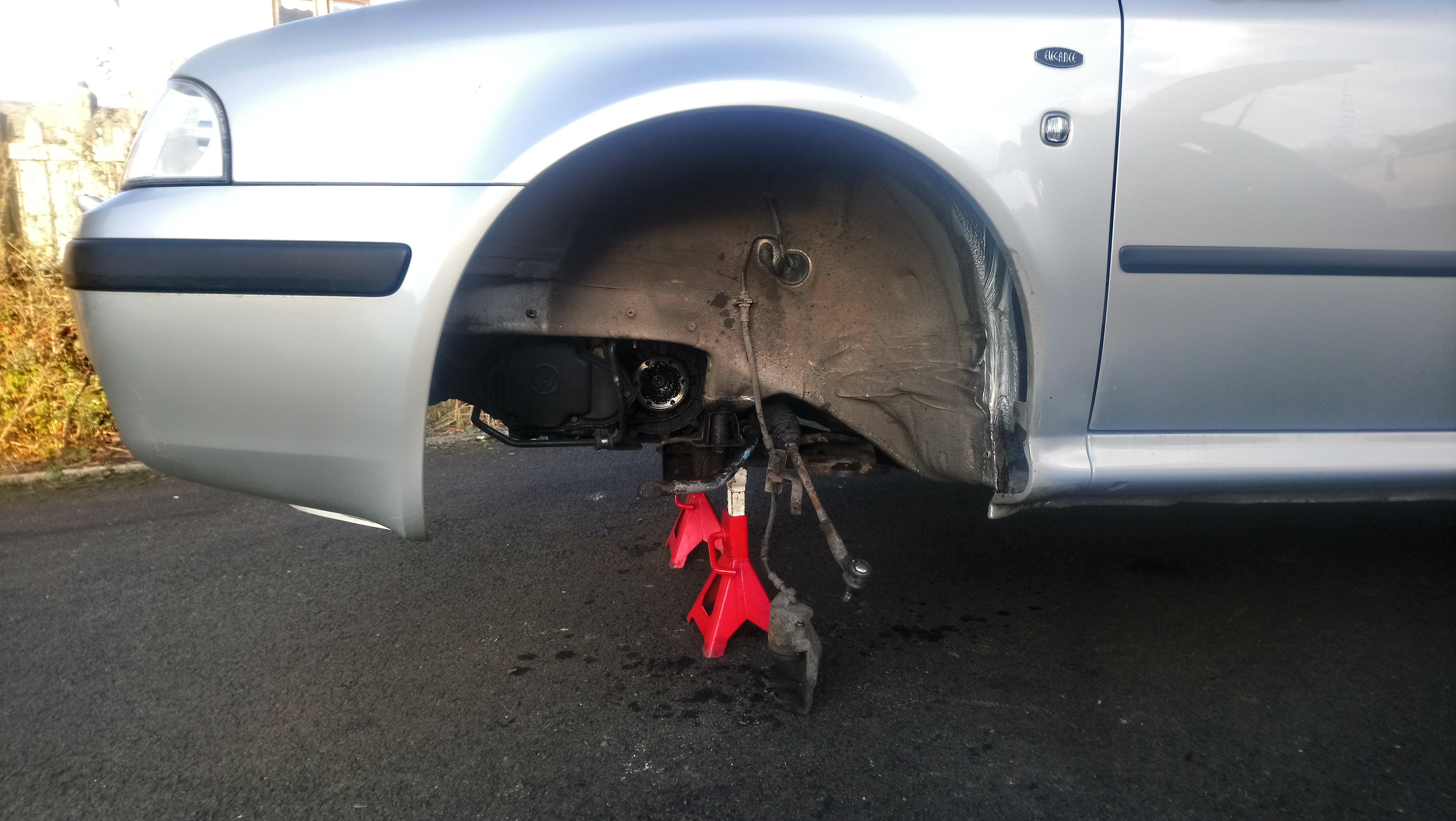

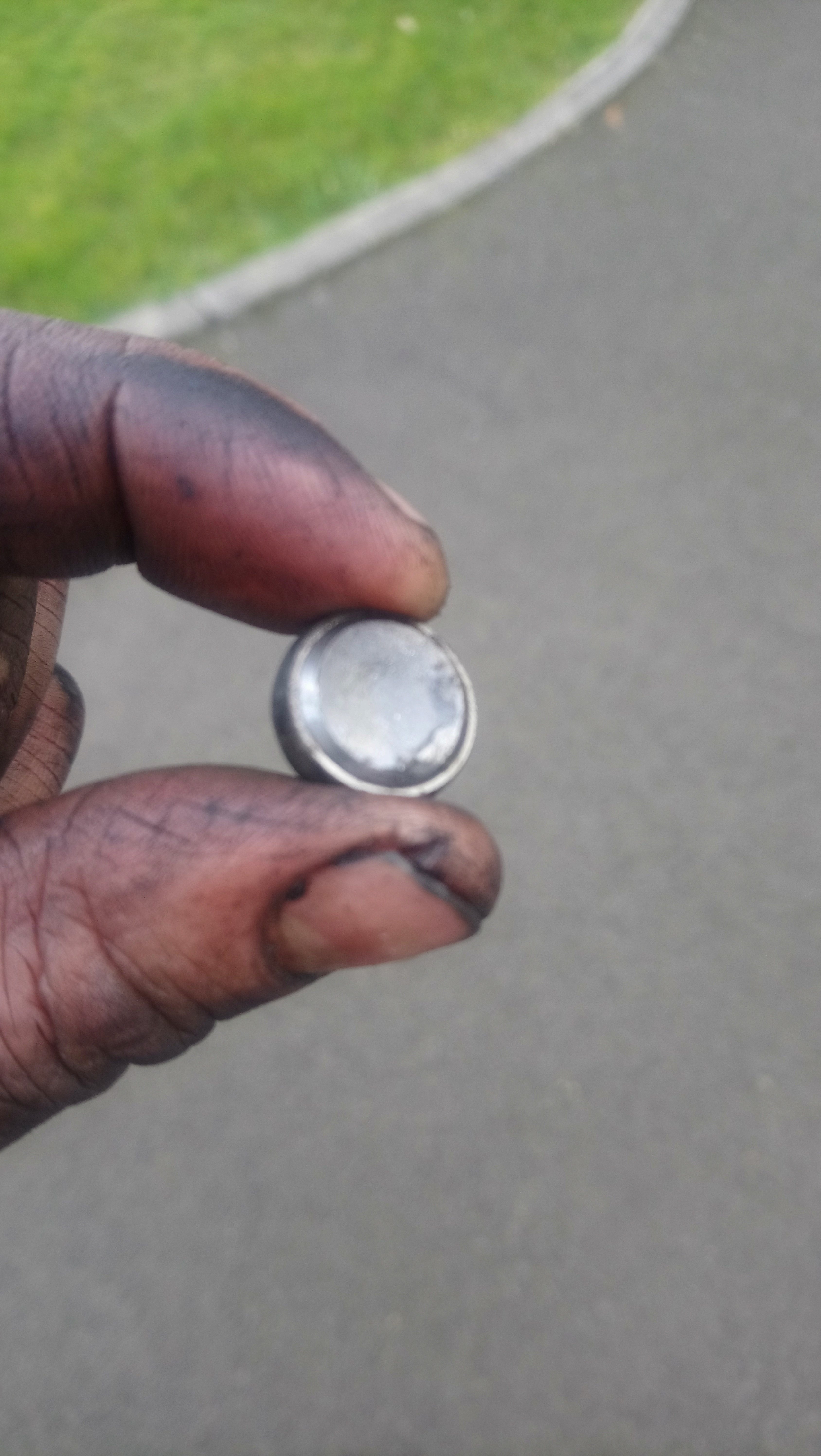

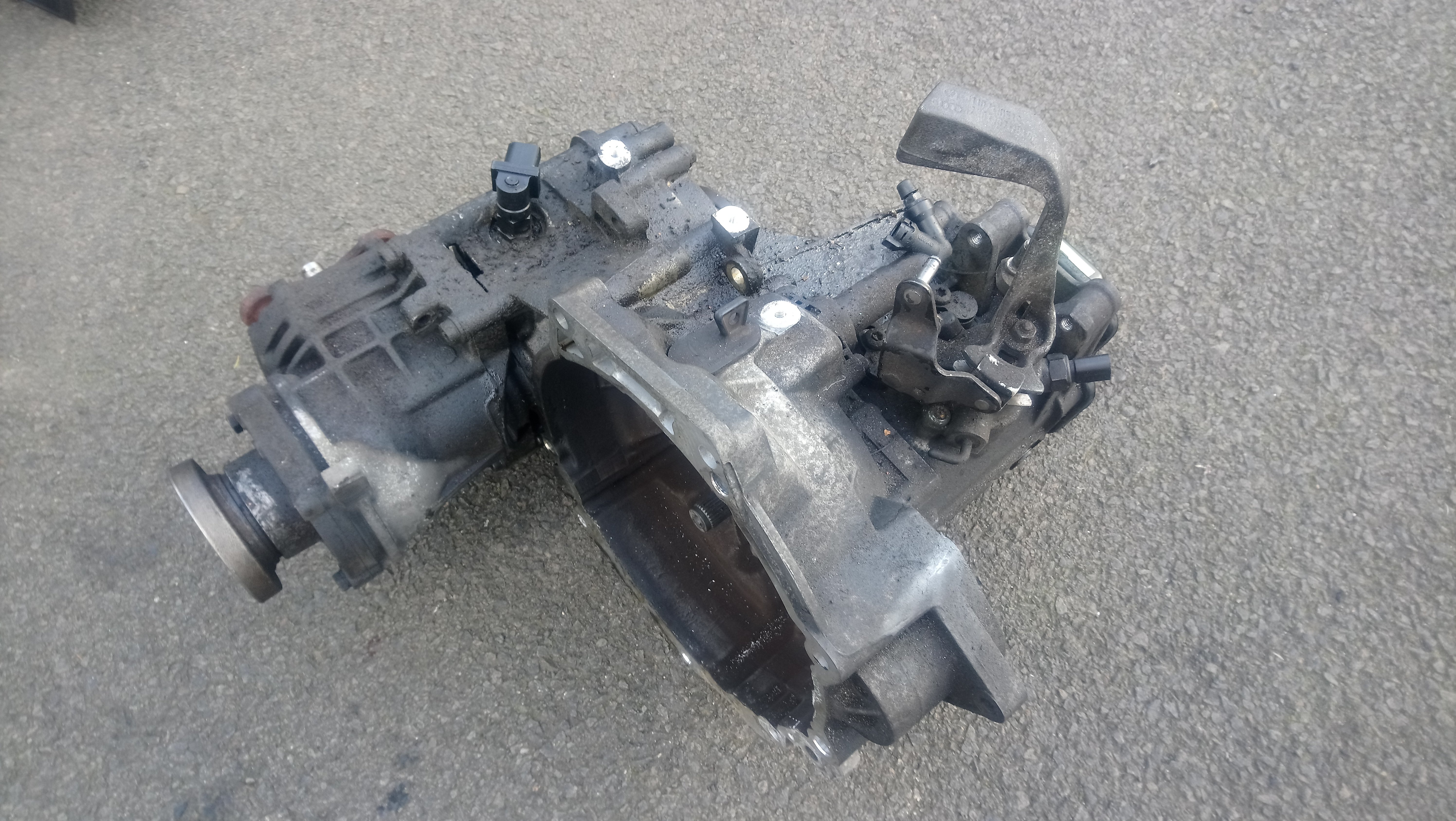

Now that the weather's better I pulled the gearbox out of the car, drained the oil from the transfer box which was fine but the gearbox oil had debris in it including a differential rivet. Currently it's being rebuilt by a specialist, I'll take the opportunity to fit a G60 flywheel and VR6 clutch.
Differential rivet.
02C (fex) 5 speed 4WD gearbox, although it has 02J marked on it.

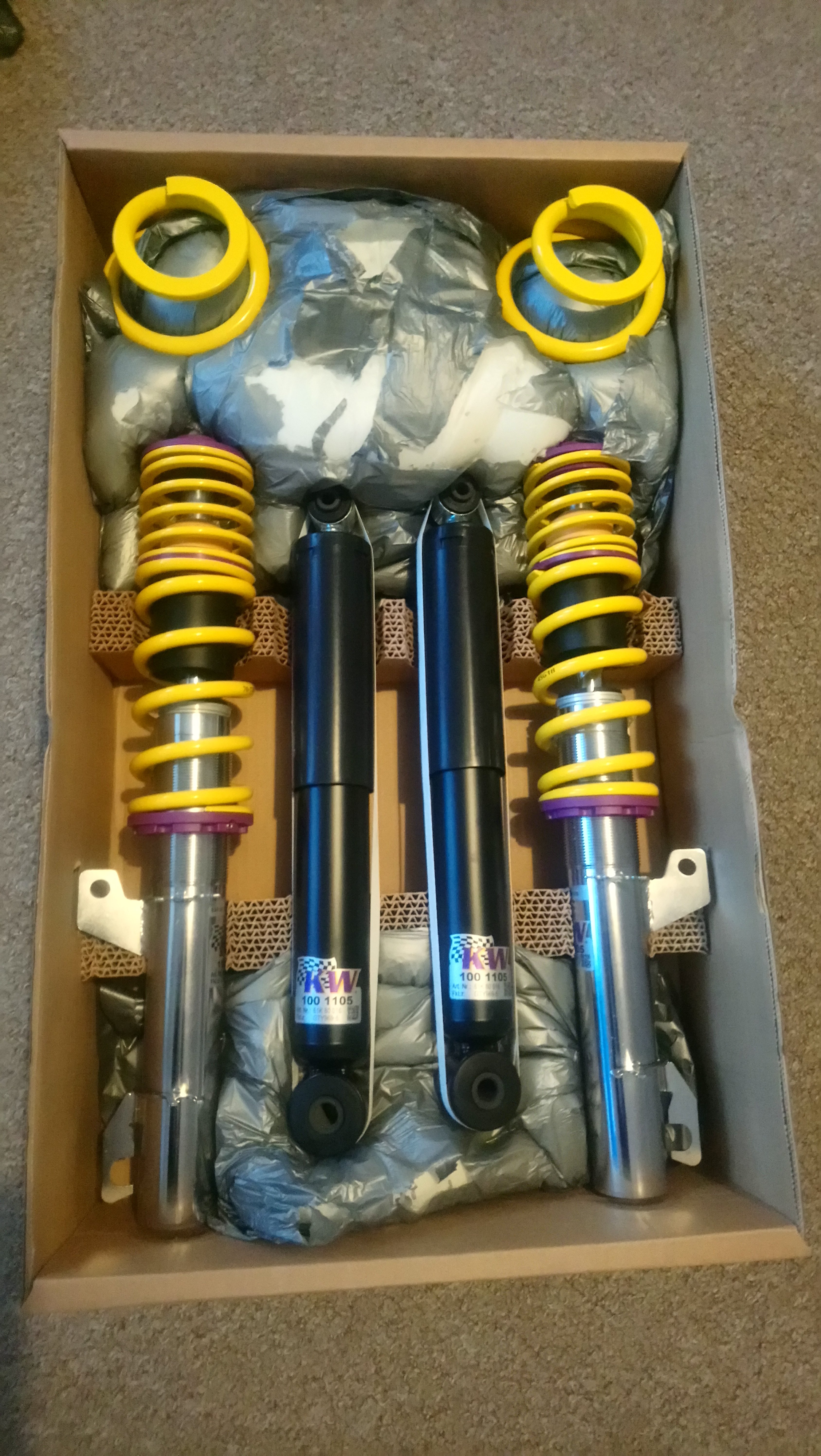

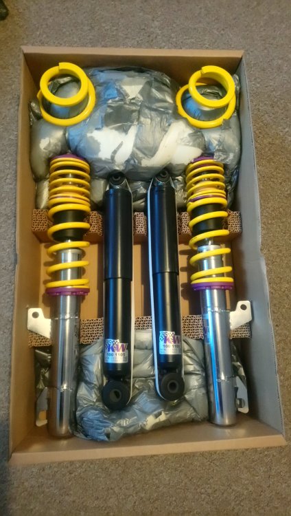

KW V1's, fixed damping and stainless steel.

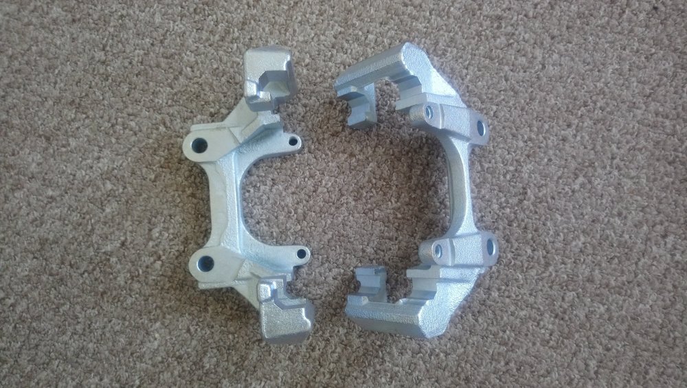

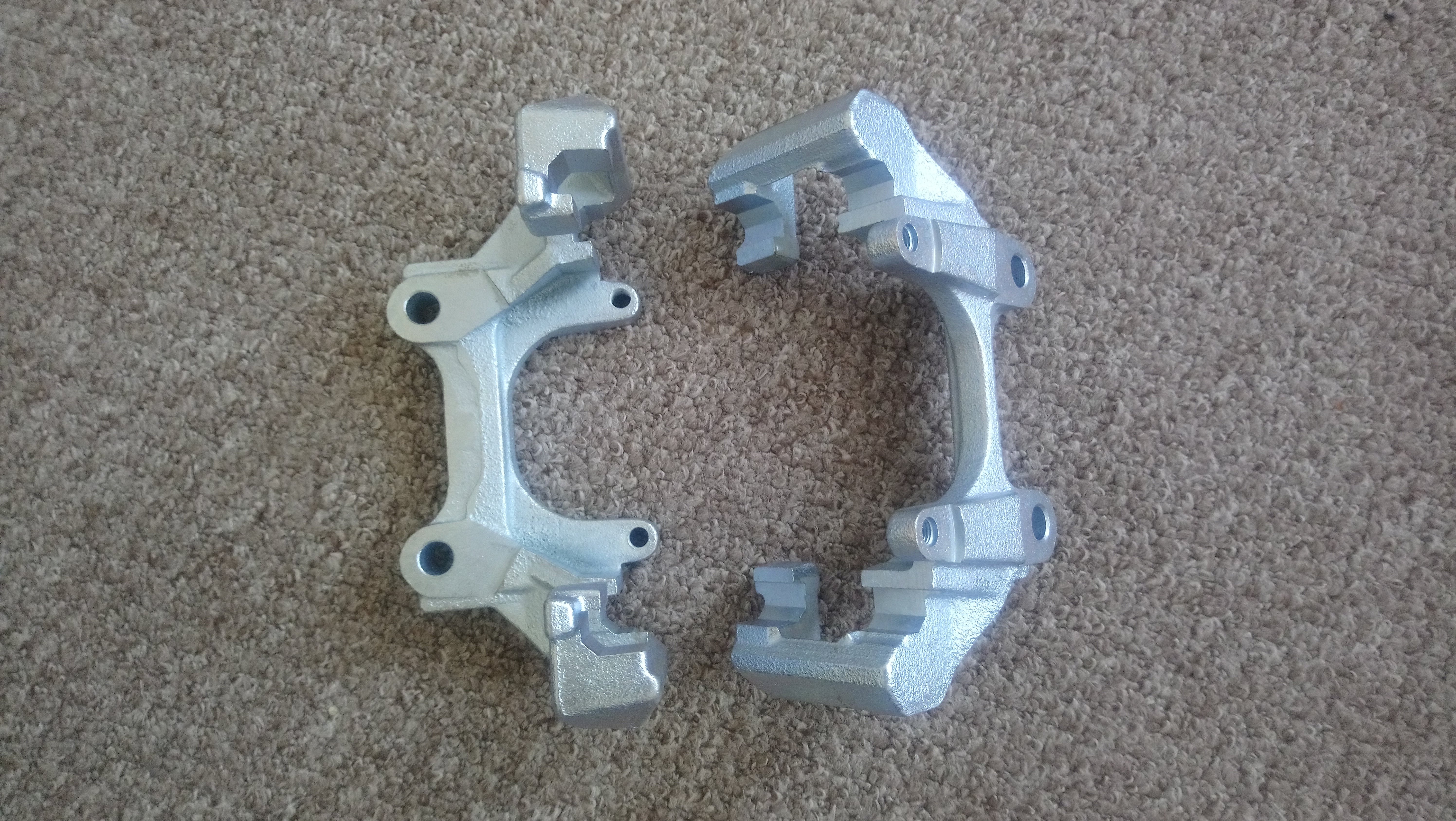

Upgrading to 312mm front brakes.

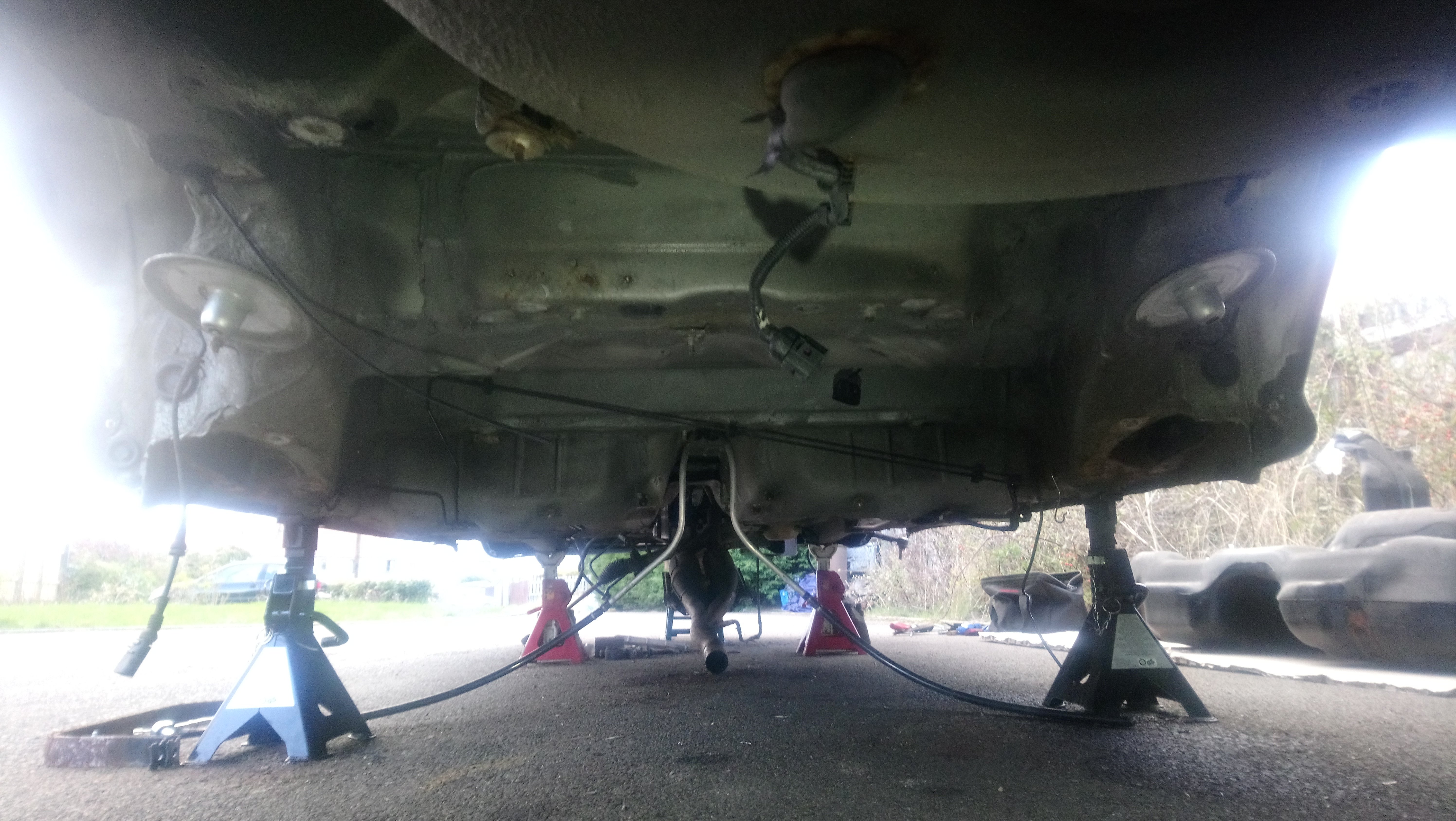

Decided to strip down the rear of the car, brake pipes need replaced and the fuel tank straps have seen better days. Much easier to service the Haldex when it's out the car.

Been a while since I posted any updates, had the gearbox overhauled (£900) The differential rivets had broken and went through the gears making a fair mess, the differential now has bolts fitted and I have a higher ratio fifth gear so it now does 2500rpm at 70mph rather than 3000rpm.

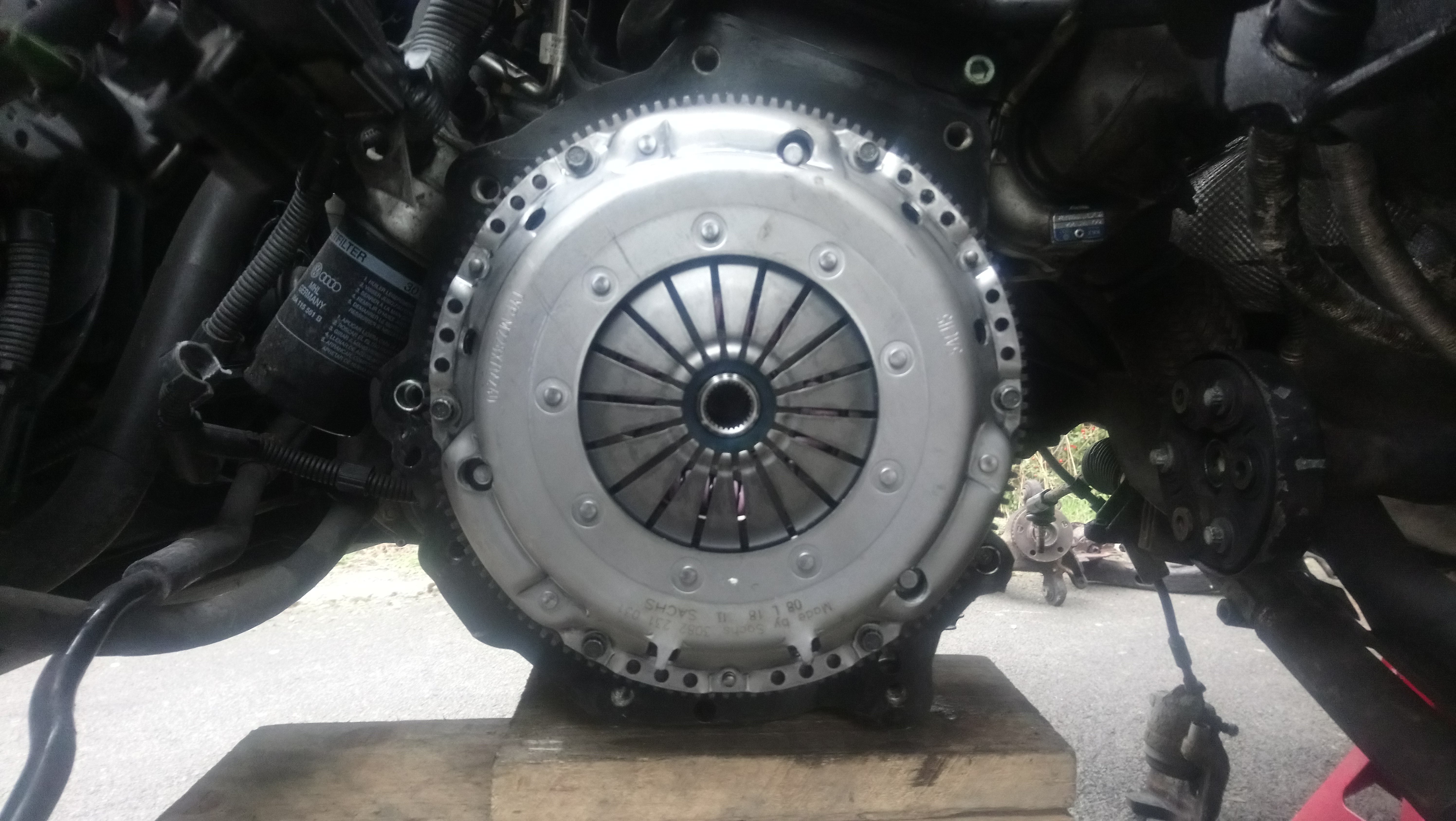

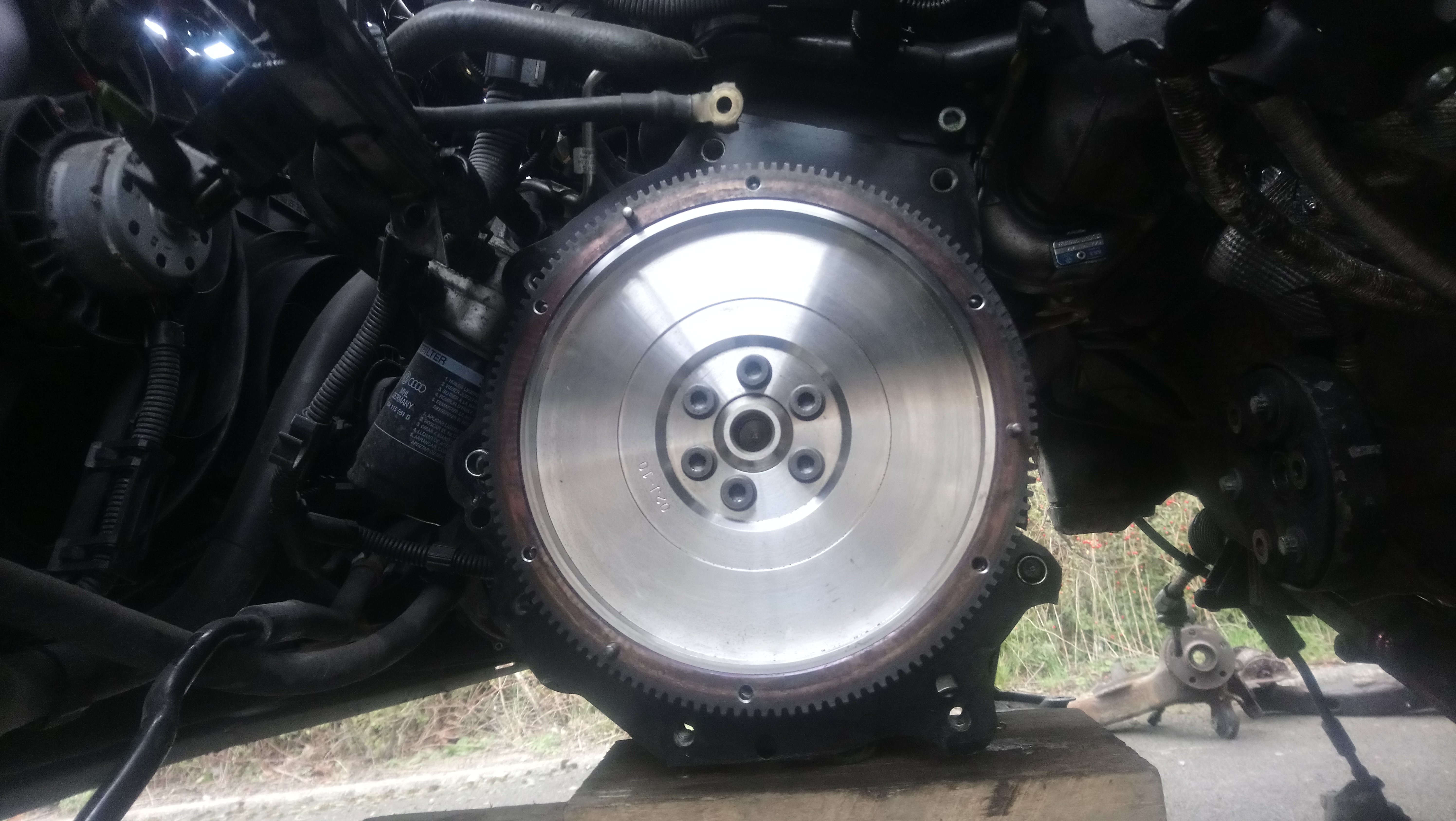

Fitted a G60 flywheel (10kg) and VR6 clutch, supplied by darkside Developments.
