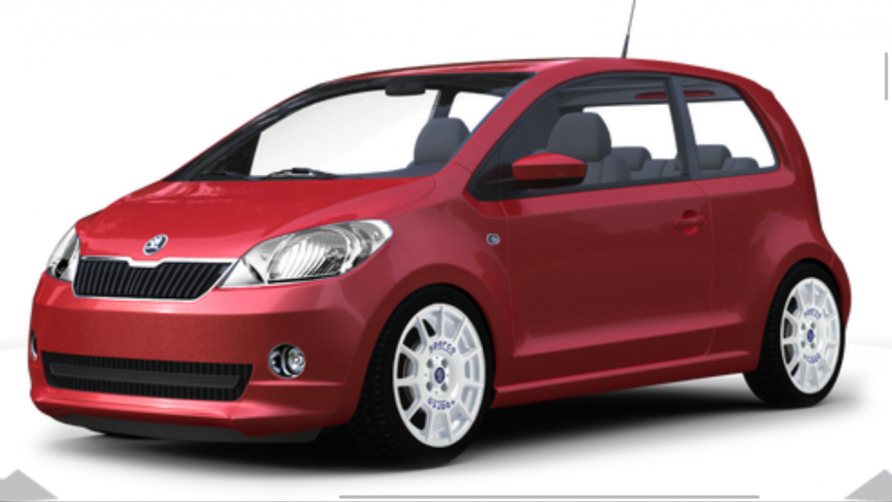

I think I've made up my mind, I originally wanted to go for a set of BBS RMs. that's until I saw the price. I settled for a rim that's half the price which I think look quite good. IMG_0465.thumb.PNG.3f1c5594bbef27051abee57aac499dcc.PNG
tell me what you think
Nice.
Best i have seen is a Mii with 'Minilite' copies on,
but i never got a picture, there is pics on google images of a Lupo with Minilites fitted though.
I quite like the minilite wheel design, I also like the equip 03 style. I reckon these will be a unique style. Now I need to choose a tyre
