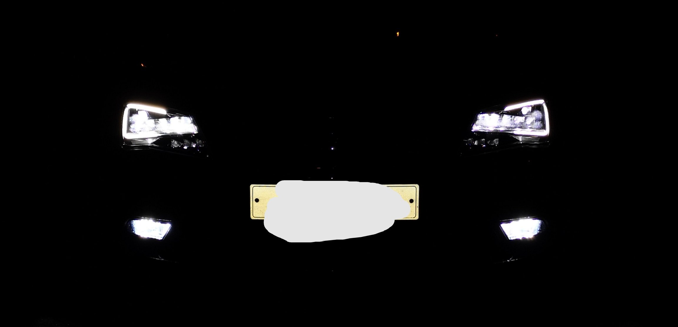

I fitted these LED fog-lights (Amazon) and the cornering lights are now very effective at helping me see round low speed corners. Time will tell how long-lasting they are.
Of note they didn't put on the bulb-out warning on my Toledo (Rapid), but did on my older Yeti??
At 6000k are they a colour match for the headlights? I only want to change the fog bulbs to match the headlights which are around 4300k I think.

I've just realised how awkward it is to get a representative photo of car headlights:dry:
This is the best I could do - the fog lights are very bright and appear a similar colour to the LED headlights.
