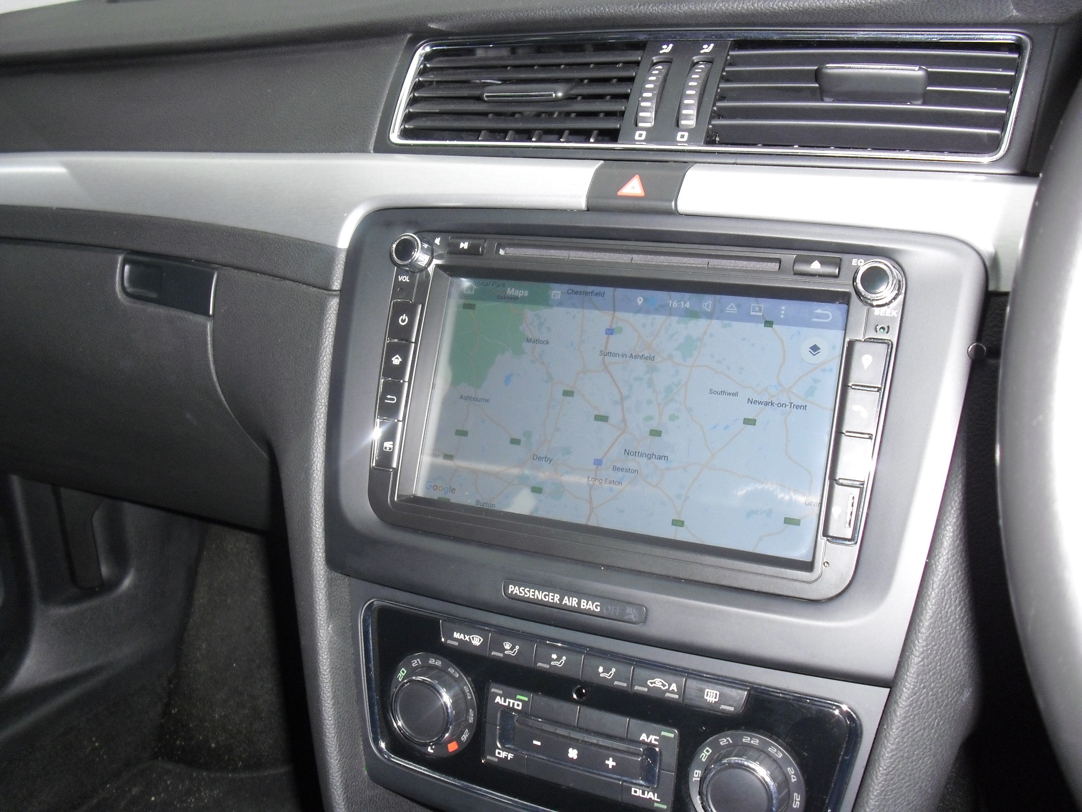

Just updated my Balero to the latest android 8" display.
It was totally plug and play, just unplug the main connector and the aerial on the Bolero and plug it into the new head unit.
The GPS antenna was taped next to the instruments inside the dashboard so you cant see it.
No messy canbus decoder boxes as it is all internal in the head unit
Everything works perfectly.
Very good service from https://audiotechdirect.com/
They talked through all the options and were very helpful
Just needed a Columbus fascia which was bought from Skoda for about £30

@matnrach That looks really smart. What functions do you lose? Drive mode selector etc,?
The only function I seem to have lost is the one that increases the volume of the sound in relation to the background noise. I am sure there is an app in the play store for  it but I have not tried to find it yet
Otherwise it is pretty much perfect

There is no way I would go back to the standard unit it is so much better in every way. I use my phone as a hot spot and it also connects via the Bluetooth for the phone.
I use Google maps for Nav but there is an off line one loaded into the unit as standard.
You can have the Nav in the background whilst running another app and you can set it as priority to give notifications and drop down to show directions as well
I play music from the mico SD card or Spotify online
I also use the Torque app to monitor the engine functions but that is just for interest.
Not sure if your unit is compatible with the plugs on the back of the head unit but you can ask the guys who sold it (details above)
One of the best accessories I have ever bought!
Can I ask why you went for that particular unit?  Theres one that has a 9 inch screen but no volume knob.  the ability to hit on/off and adjust the volume quickly is quite appealing.
I chose that one as it had a cd slot and as you say the buttons. The top right button indexes through the different equalizer settings which I find useful as well
Obviously I dont know what the other types are like.
I believe some have Apple type interfaces and others are Android.
The one I have has the internal Canbus decoders for the steering wheel control so no need for a bulky extra loom
Probably best to speak with the supplier for your best option

The unit is still fine. No issues at all.
Sound is at least as good as the standard unit with more ability customise to your liking
If I were to get a new one it would have the slightly larger screen and no CD drive as I have not used it at all.
Possibly worth getting the Android 8.0 version as it has a split screen function I believe which would be useful
Hope that helps

Display is actually fine. I have no issues really.

If the Maxidot is the info on the display between the speed/re counter then it does not affect that.
The reversing sensors still work with audible and visual warning
