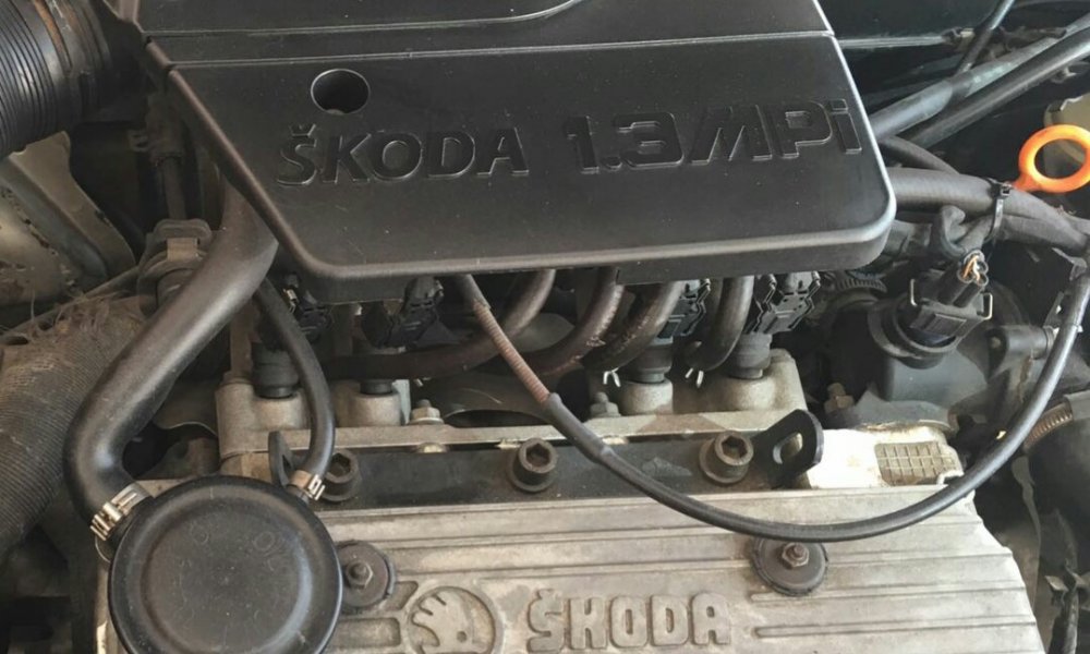

ı need help
What is the type of felicia mk2 99 1.3 mpi lxi engine injection ?
Full group
Sequential Fuel Sistem 2+2
Sequential Fuel Sistem 4
Thanks.
Felicia 1.3 mpi injector work 1 + 4 - 2 + 3
sequential 2+2

1 hour ago, RicardoM said:
The injector ignition sequence is working two
1-3 and 2-4 or all firing at once (1-3-4-2)
You have the answer in this diagram (see magenta marking)
  • Sponsor
I think the answer is there Ricardo, but in the injector wiring just to the right of the magenta marking. Injectors fire in pairs.
Everybody thank you
