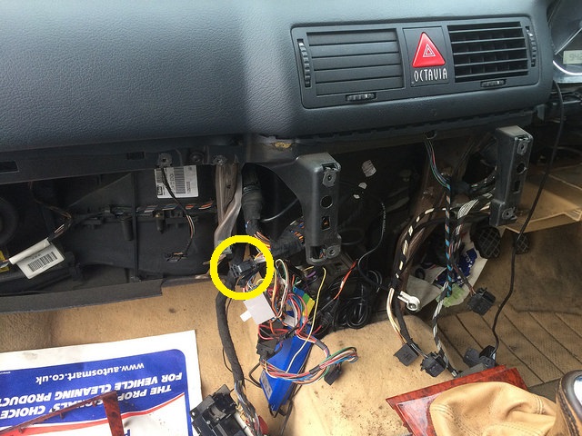

Do you have a picture of where the wires were tapped into please?
I don't have any pics sorry, the connector for the Telephone provision, was taped to the metal bracket above the glovebox, The wheel speed inputs are straight forward onto Pin 1 of the Radio Black connector (Blue/White wire) and the reverse is easily picked up on the rear light cluster connector
OK thanks I'll have a look. Mines an Elegance so hopefully there.
The Circle is the Telephone provision connector
I did find without cutting the mounting tray backplate it was difficult to get the unit to sit fully into the mount
