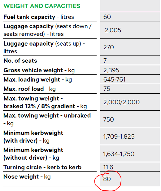

I tow a Bailey Pegasus 534, it is nearly 24ft but the Kodiaq 190 (seven seater) tows it very well. The only bug bear is the 80kg noseweight, trying to achieve that without adding extra weight to the back is hard to achieve. It all depends on the best van layout for you and how many you have to accommodate. Go round a dealers and have a good look inside and out and see which van is best for you, then ask dealer if it is OK for the Kodiaq-they have all the details for towing vehicles matched up to the specific van.

I’m in Australia and the 80kg ball weight is a huge bugbare. It basically means we can’t tow much beyond a reasonable sized boat or a campervan. Certainly couldn’t tow a 24foot van. Nothing near.
Australian built caravans adopt the USA standards of nose weight being 10% of caravan weight (eg 2000kg caravan would have 200kg nose weight).
You can get European spec caravans in Aus but they are relatively expensive and certainly have no off road capability.
The, newly released in Australia, Tiguan 7 seat Allspace is built in Mexico and caters for USA ball weights. I believe the diesel versions can pull 2500kg and have 250kg ball load capacity. I have no idea if the European versions are the same though.
Yes, Australia uses the US 10% formula! But it’s a bit more complicated than that from what I understand. There are other more complex formulae at play meaning that the Kodiaq can’t pull anything near it’s 2000kg allowable weight legally given its 80kg limit.

What is behind the relatively low ball weight on the Kodiaq? Is it directly related to the weight of the vehicle (which compared to other 7-seat SUV's is low) or the strength of the chassis / tow bar?
What would be the risks of exceeding the ball nose weight? Is it around damaging the vehicle chassis / tow bar?
Edited by silver1011
Whilst the Kodiaq would appear to be a relatively large vehicle, in towing terms it's not that heavy a vehicle, especially when compared to some Land/Range Rover products and other large 4WD vehicles and pickups.
It's also not that robust in towing terms compared to other vehicles. It's basically a saloon car on stilts rather than a purpose built off roader, and that's the reason that it has a lower nose weight limit than many other vehicles.
The reason the noseweight limit is lower on the 7 seater is due to the extra weight of the third row of seats at the rear of the car. Putting that extra weight in the rear of the car has a similar effect to putting too much weight in the front of the caravan. If the noseweight limit is exceeded, it acts to push down the rear of the car and raise the nose of the car, thereby making the combination unstable, and in some circumstances can make the front wheels scrabble for grip, a phenomena I've experienced when towing with a Superb estate. Whilst the combination of the Superb and the caravan I was towing was perfectly legal on paper, if items you take with you when towing are not apportioned correctly in both the car and the caravan, you can end up with a potentially dangerous combination on the road.
This is something that many caravanners don't know or care about when they chuck the kitchen sink in their car or caravan.
You might ask why passengers in the third row of seats don't seem to be taken into account when it comes to noseweights, but I'm pretty sure that manufactures have already done that when calculating their noseweights.
There might be other reasons for calculating max noseweights that I'm unaware of, but what I've written is the crux of it.

It will also be down to the max permissible load on the rear axle - exceed the nose weight and you increase the mass sitting on the rear axle - increasing the forces that you’re asking the axle and suspension components to cope with.
It seems likely that it will also be down to how much vertical load the tow bar mounting can cope with.

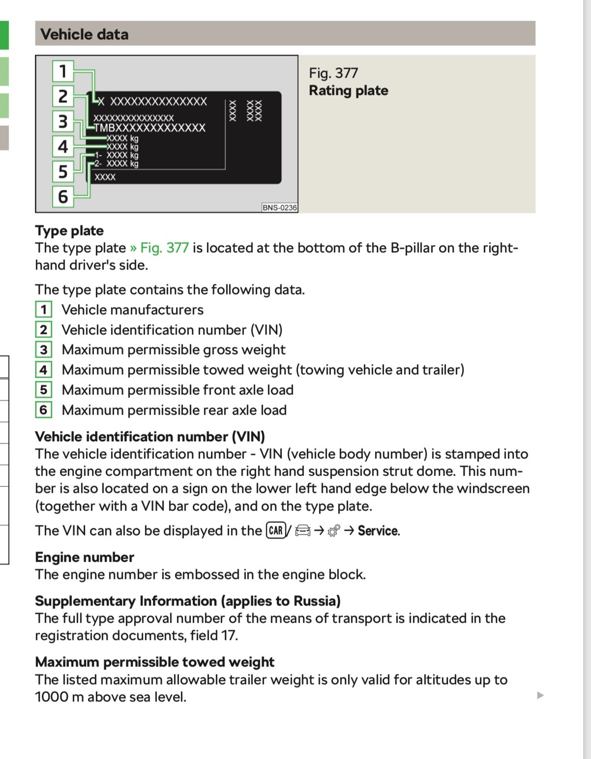

There is a sticker at the bottom of the drivers b pillar.
There is indeed - but it doesn’t tell you the kerb weight.
No but it does give you vehicle gross weight and maximum weight of vehicle and trailer, If you take vehicle weight away from combo weight you should get maximum tow weight, 2000kg in my case.
https://ntta.co.uk/law/law/towing-capacity
