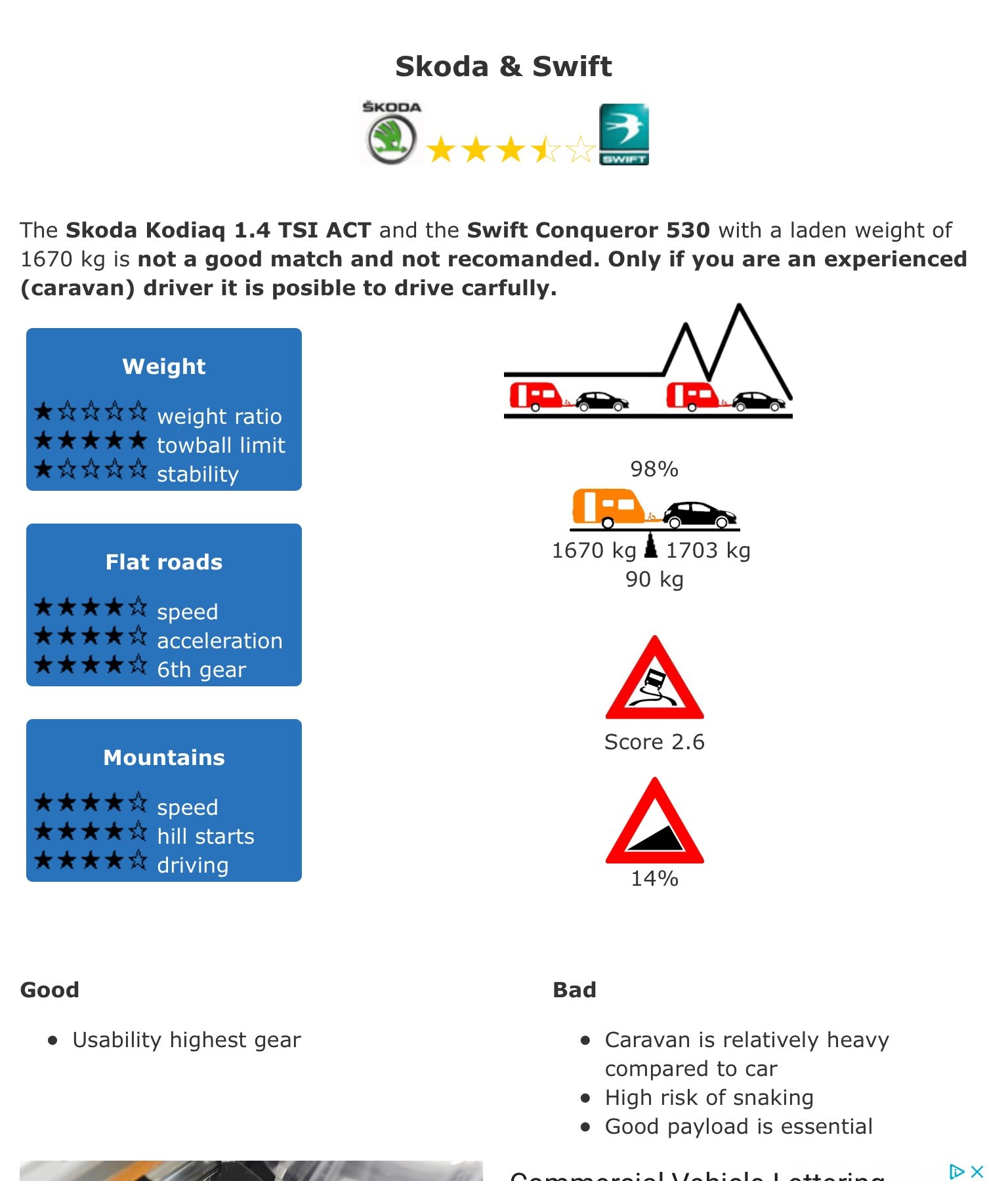

KennyR, I did try out that website, it was recommended elsewhere on a dedicated caravaning forum, but strangely the Swift Conqueror 530 isn't listed.

I understand that when calculating the car to caravan ratio you should always take the MTPLM of the caravan and the minimum kerbweight (with driver) of the car.
85% is the recommended target, though not legally enforced.
So, the Swift is rated at 1,670, my particular Kodiaq is 1,658 - 1,793, putting me firmly around 100% if I take worst case (1,658kg for my car), so not ideal @ 101%.
Anyhow, things change fast, after viewing the Swift the 4-berth layout isn't for us. We're now decided on a Bailey Pegasus Ancona, 6-berth.

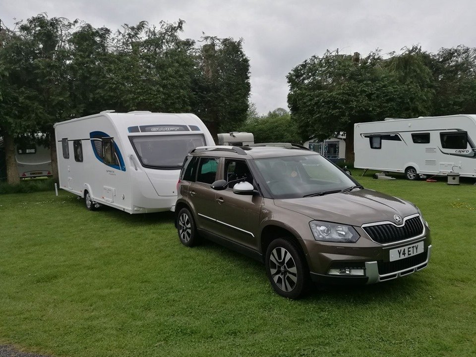

First purchase after the caravan :D
Related image
A cautionary tale lest you get too complacent about the capabilities of your Kodiaq.
My first van was a 2 berth Bailey with an MTPLM of less than 1200kgs. At the time I had a new 2WD 2012 Kia Sportage with a naturally aspirated 134bhp 1600c petrol engine and a  recommended max towing limit of 1200kgs.
On paper all was legal and the car should have pulled the van no trouble as long as I didn't load the van up too much with kit, which I didn't in my early days until I had more experience. I did feel right from the off that the Kia needed more power, but like you, our initial intention was not to stray too far from home.
I was en route to a caravan site one day and my preferred route was blocked by a lorry stuck under a bridge, so I had to make a detour which entailed following a narrowish road, part of which became quite steep. Partway along this road I came up behind a large logging lorry and sods law dictated that on the steepest part of the route, he and I were forced to stop to let a vehicle pass going in the opposite direction.
Once clear, the lorry pulled away just fine, but I found I couldn't !! At first the car would just not pull the van away from a standing start on this incline and I ended up smoking the clutch quite badly.
I was in a slight panic as I was blocking the road if anything large happened upon us and I couldn't see a way out other than calling the emergency services.. Fortunately no other traffic came along and once I'd let the clutch cool off a bit, I gave it another try, and after much feathering, slipping and coaxing I got the whole thing slowly rolling and eventually built up speed and got to my destination.
Okay, this was a one off and hopefully will never happen to you, but it is possible, and the moral of the tale is; try and tow with a car that has a much higher capacity for towing than you actually need.
I sold the Kia a few months later and got the Superb 😉.

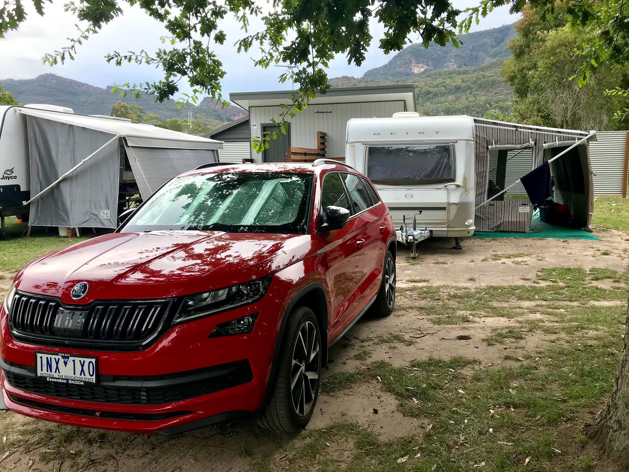

Interesting topic and one close to my heart, as in Australia there is not much choice in caravans to stay under the 80kg towball limit.  My personal view that this is seriously affecting sales here, as other SUV have up to 150kg which brings in far more choice.
Having said that we are very happy to have found a Geist AK560 which is 1600kg max laden and I can load to 80kg towball and check with scales.  Just done 4500km with it to QLD and it towed like a dream.  The only issue we found vs. our previous Pajero was that the lower roof height and raked rear blasted the front van double glazed window so much the two layers stuck together - very nervous as we thought we'd destroyed it.  May look at a wind deflector to try to push some wind away from it and over the top.
Have to say that the lane assist really keeps the van in check and a much easier drive when towing.  We have the 140TDI Sportline and that gives plenty of grunt to tow with.
The 1.4 TSI pulls like a dream!
